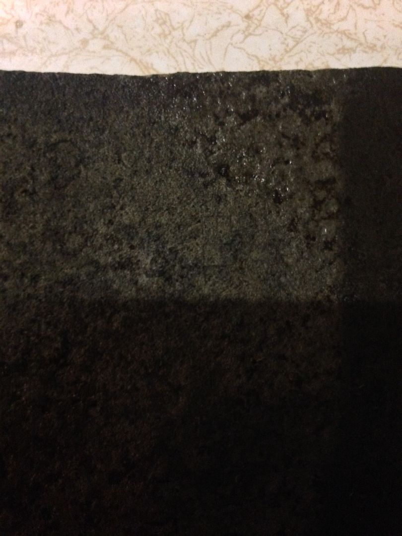

Posted Ole Ugly yesterday but now he/she/it is getting their own thread. Picked it up for a couple bucks at a local antique mall with the intent to fix it up, and oh does it need some TLC. Pitting everywhere (even inside the eye) and rusted to all heck, but it had char,. It stuck out to me. Both bits show wear but it's fairly even so that's not a worry but the eye...dear gods the Eye. It looks like it was used as a lever, pry bar, and hammer. Should be fixable with a blow torch (no need to start the forge for this one) and either a RR spike or my 1 1/4" drift to open it up. Take it on my anvil and straighten it out a bit 'course. If I find any marks then I'll sand down around them (if that's what I decide to do) but it's for sure old as the temper lines are really deep (can't see them too well under the rust in the pictures provided) but it appears to be multi piece construction. Almost looks like a double half wedge (might make it full wedge when fixing the eye). Unfamiliar on axe patterns so I can't say what exactly it is, but it has temper lines to rival most of my Maine-Made Axes.
Looking at the misshapen double bit, and knowing that JBLytle gathers up (and makes available) useable old heads for pennies on the dollar, I'd be tempted not to devote much time to it. Unless it has a quality brand stamp, and you have the time and patience for trying to straighten it.
This is merely for me to use, don't have a DB and I wanted a challenging restoration project. No stamp visible yet but dark temper lines about 3.5" deep. No eye ridges (duh) so I don't think it's a Kelly TT but the stamp doesn't matter as much to me as it's ability to be used.
So I was talking with the owners of the antique shop, and evidently this (and several other beat up axe heads) came from an old small time blacksmiths shop that closed down and was abandoned in the early 1910s. Explains the older style construction and the poor condition. Weather the story is true or not, I think I can fix this up with some patience. Go figure, the rust doesn't really want to clean off. Maybe sitting around in the run down building in the woods for 100ish years has something to do with that. Deep temper lines so that's good at least. Gonna be a long time till it's ready for me to find a makers mark (if one's there) or if it was just made by the smith.

As to fixing the eye I think some low heat from a blow torch, a light hammer (maybe one of them ball peins I just got!) and my anvil should straighten it out, and more than likely I'll take a RR spike or even my 1 1/4" drift to fix the eye itself.
I think today is the day of days, the vinegar hasn't revealed any makers marks so I don't think I'll feel bad about straigthening it out with a torch and hammer (not really worth starting the forge up). Wish me luck.

The plan is to straighten the bit out, make the walls of the eye flat, then drift it out from the middle. Only issue is my forge is outdoors, and the wind makes starting it impossible. Propane torch ain't gonna do it so I need to find some way to manipulate the eye.
After days of bathing in vinegar I have two deep temper lines visible, and a possible part of a makers mark. Looks to be a square divided in four.
So...errr...that wasn't a square at all. It's the E and L in Kelly! After some scrubbing with steel wool and water today it became quite clear. Kelly Axe Mfg. Co. Chareleston WVA USA. Their logo from the early 1900s. As the story goes this came out of an old workshop that was abandoned in the mid 1910's.
