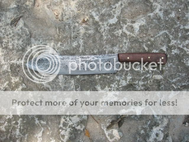

Although my shop is just a couple or so miles from the Alamo and I had studied and sketched the knife to the extent of my poor drawing ability, I wanted to get as close to the original profile as possible.
Armed with dimensions e-mailed to me by one of the head curators and the picture from the Blade article, I got as close to the original profile as I could. The original was forged from an old file, but this one was 5160. I used mesquite for the handle, appropriate for a knife made in Texas.
I even offset the rivets in the handle as near as I could figure to the original.

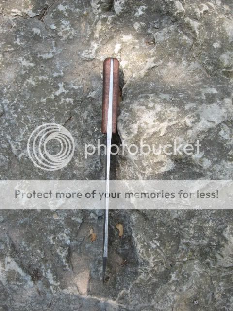

Like the original, it has a tapered tang and a pinched-in spine.

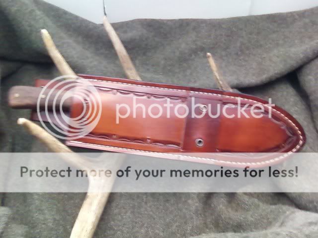

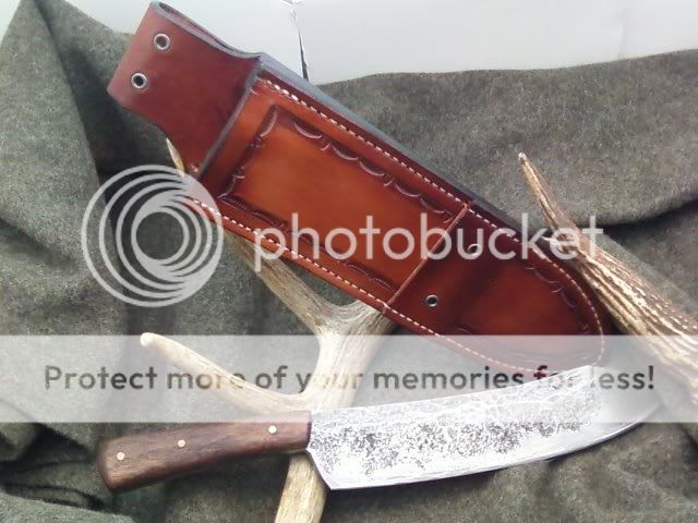

Fortunately, the customer had better sense than to try to reproduce the original sheath, which was quite crude and seemed to be held together with *lead rivets*! Given the fact that my leatherworking skills would likely have made a sheath uglier than the original (I know where my skillsets lie, and it's not in the direction of leatherwork), the customer wisely commissioned knifemaker Luke Swenson, also living in the San Antonio area, to make a sheath for it.
Since getting the knife, the customer has put it through its paces, from cutting grass to patch a shelter roof to cooking to near-daily use in making kindling for his wood stove. In his words, "IT HOLDS A PHENOMENAL EDGE". That's what one likes to hear about one's work.
