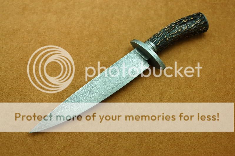

As a little back round I have just started making Damascus blades a couple of weeks ago. I have made 4 blades but this is the first one that I considered good enough to finish.
It is hand welded 1084 & 15n20 with 224 layers and random pattern..
Wrought Iron fittings and Stag handle.
Thanks Chris,
Each weld was set twice before drawing out on a 25# Little Giant.
It makes me appreciate the work that the Guy's put in if they do it all by hand forging.
Well done sir! I now understand the pricing on Damascus and have much respect for the guys that do it so well.
Chris
Very nicely done, Dave. Now you just need five of those with no flaws....
Kev
I do like that! And the I like the thicker guard too.
You must be very satisified with your effort!
Steve
Potomac Forge
In God We Trust
Damn, you make clean looking stuff. The blade is a great compliment to a fantastic piece of stag, and CLEAN lines!!!!! WOW!!!!
