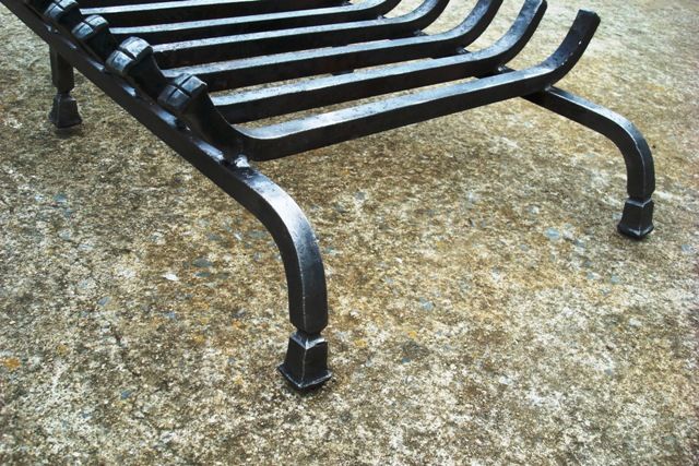

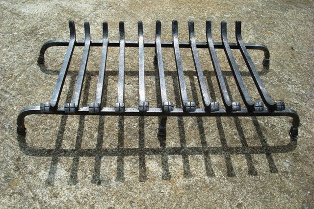

Just finished this up for a customer, first grate I've made before.
He wanted a fairly simple fire grate, but still not your average hardware store grate.
This is what I came up with...

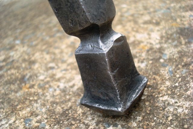

5/8" square steel, I upset and flared the ends, fullered the legs, and chiseled a simple decoration on the cross bars.
Approx 32" x 13"
The whole thing is tig welded together; I wanted to drill holes in all the joints and use forged rivets, but that would have taken a lot more time, and the customer didn't want to pay for that extra touch.

Nice work, I agree, it'd look cool with forged rivets, but it looks good in any event.
That is just "Slicker-than-Snot". Outstanding job my good man. Wish I had the skills to do something like that.
Robert
Very nice work and quite effective. While restrained, it captures the hand forged look well. Bravo.
