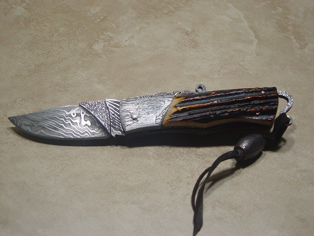

This was a commision from a regular client.Each piece he commisions he likes to push my skills and abilitys, and also likes things I have never done before so they will be unique to him. This piece has blade carving, texturing and sculpting, alll which are firsts.
Handle scales are amber stag, deep etched wrought iron bolsters and spacer bar, and dangler bead. Blade steel is low layer twist damascus forged by Chad Nichols (with a little help from me), and as stated before has been carved, sculpted , and textured, then deep etched. Steel pivot pin and copper scale pins with steel liners.OAL is a little over 8" open,5" open,(including curl) with a blade length of 3 1/4 ".

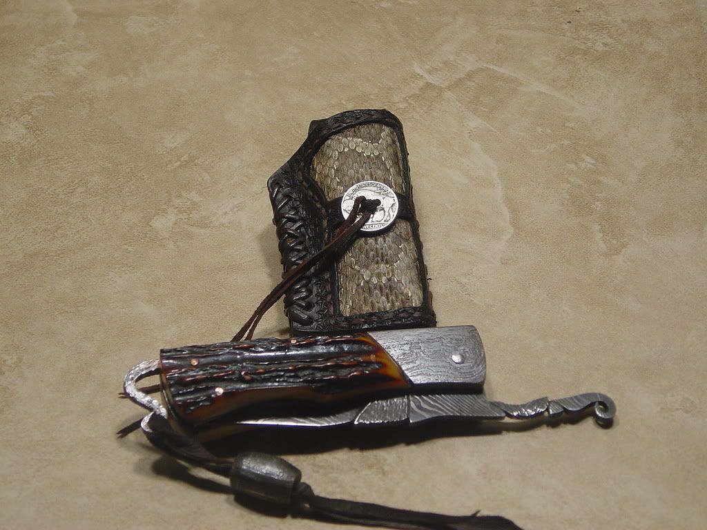

The sheath is Wickett and Craig veg-tanned tooling leather that has rattlesnake inlays, barbed wire tooling and a real buffalo nickle concho. The edge is laced with a mexican basketweave braiding that my friend Dave Cole helped me get through, as well as providing the tooling leather(thanks Dave!) This is also a first for me(and probably last)!Thanks for looking!
