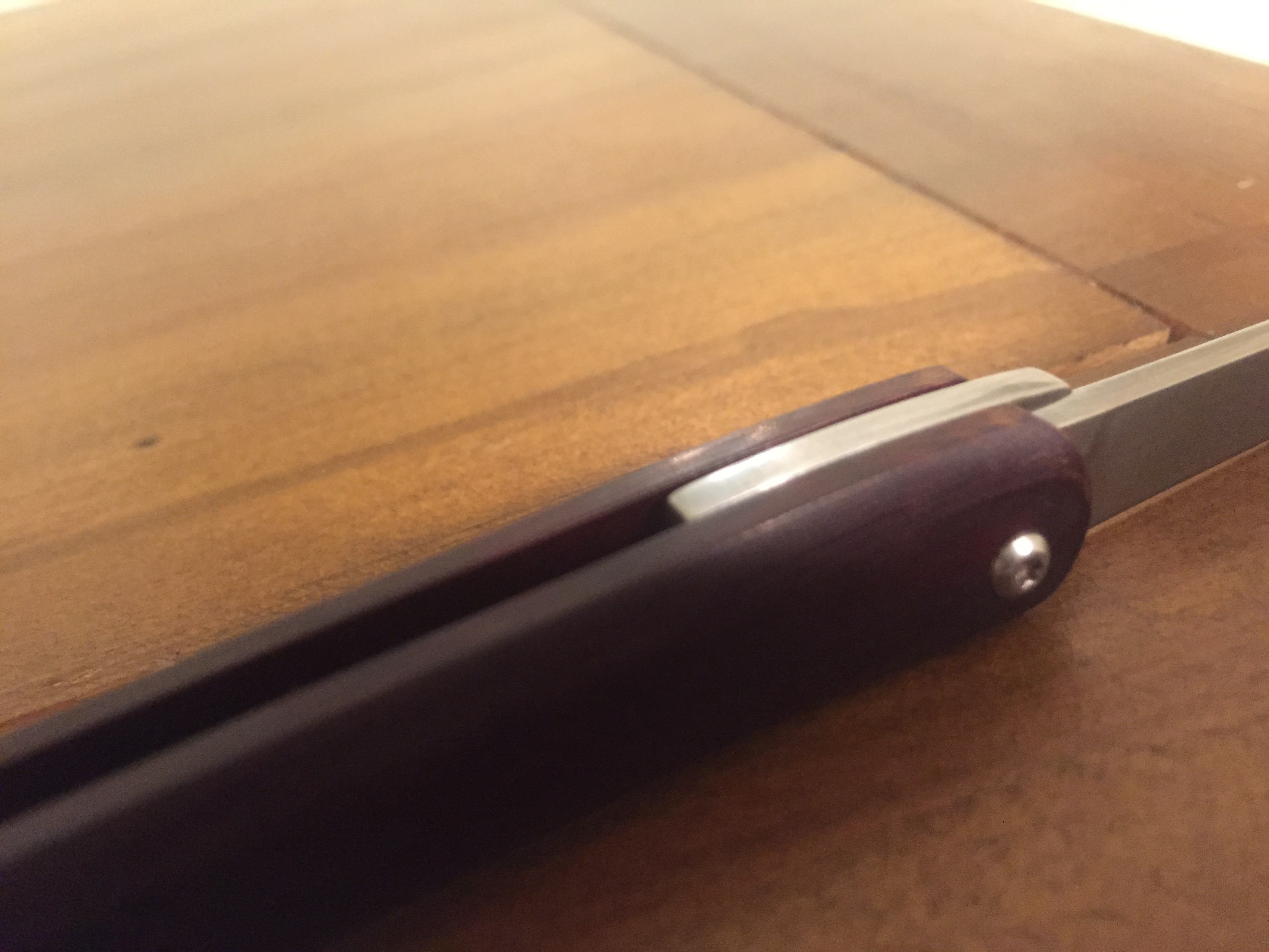

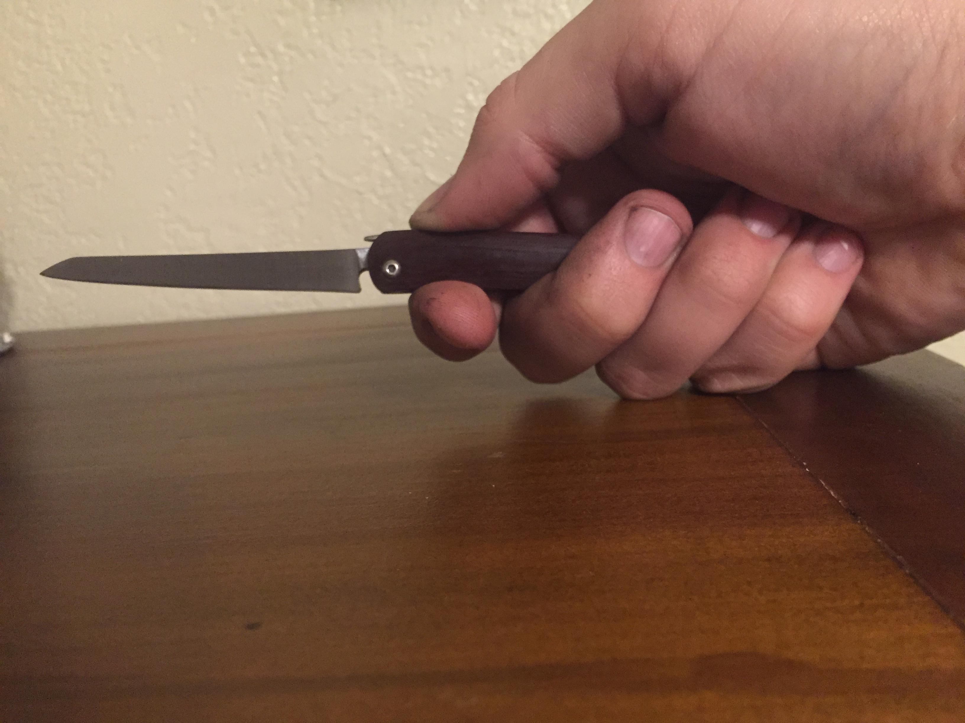

Hey guys. Just finished up my fist ever folding knife. The concept was to be inspired somewhat by the Richard Rogers Shorty, though my design has many differences. The concept is to have a knife that is very small and lightweight (about the size of a pen) with a usable blade size and discreet carry. It is about 1/2'' wide, 1/2'' thick, and has a 3'' blade

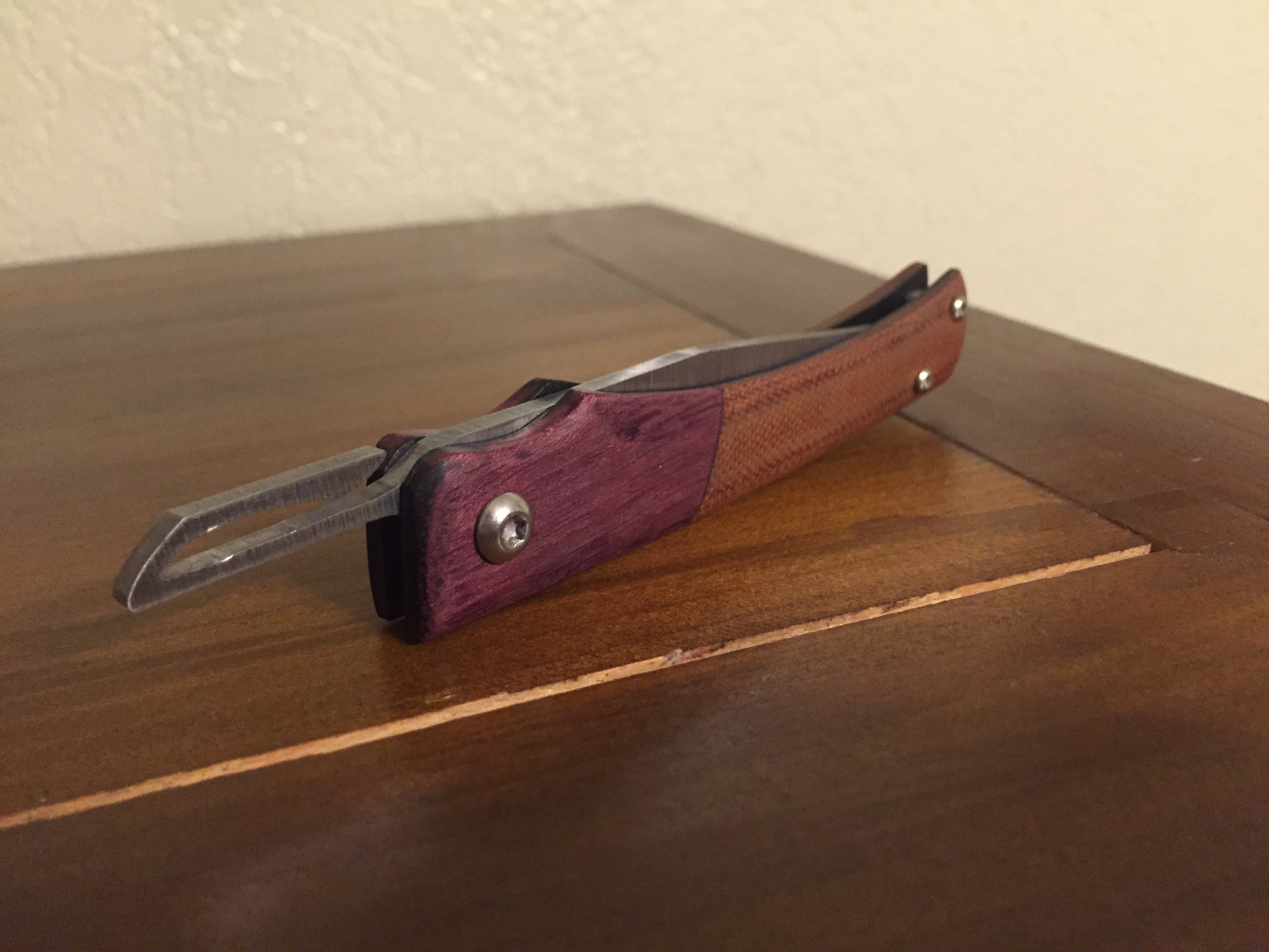

I went to work designing it. The clever (or not clever if you don't like it) design portion here is that the friction folder tang will double as a pocket clip. Since the knife is pretty square in shape, it wont matter that it is on the spine. I used an off-center pivot position to allow the clip to sit proud of the scales when closed (for clipping) but flush with the scales when open (for retention and comfort).

It is important that the clip is very tough since it is integrated into the blade. I sanded off the scale, wrapped the blade in a wet paper-towel, and heated the tang to blue (about 600 F). Did this three times, careful not to overheat the blade.
Did the final grind, starting at 220 grit until shaped how I want, then 600 grit all over to polish some. finished up with a hand rubbed 1000 grit and some 1000 steel wool. Installed the blade in the already finished scales, and put an edge on it. Total package is smaller than a sharpie, comfortable in-hand, and weighs 0.8oz. The clip style makes it not look like a knige in pocket. The integrated clip works perfect for slacks and jeans, but is a little large for clipping tightly to shirt pockets.

I worry about the very thin section at the highest stress point. The mechanical advantage ( amount of force) applied to the choil is really high if you do the length to width math. Hopefully the blade will not snap off in use.
I do like the basic concept, but feel it would be stronger with a wider section there.
I understand the concern. The leverage and stress from the long blade (for its size) Definitely makes that the weak point. As far as use, this blade is pretty much only for office carry for me, so the most heavy use it will see is an apple. IF I were to try to sell the design it would need bulked up for sure, since customers don't have the same perspective. I had tried to beef it up some, but in designing, I found that by making that larger, the other side of the pivot became too thin for comfort. I suppose it has a little to do with the geometry needed for the friction folder and trying to make such a small design.
I appreciate the feedback. Do you think it would benefit from drawing the temper more there? I worry it's a bit close to the blade for me to do too much. Or can anyone think of a way to strengthen it in future builds without bulking up the knife too much?
