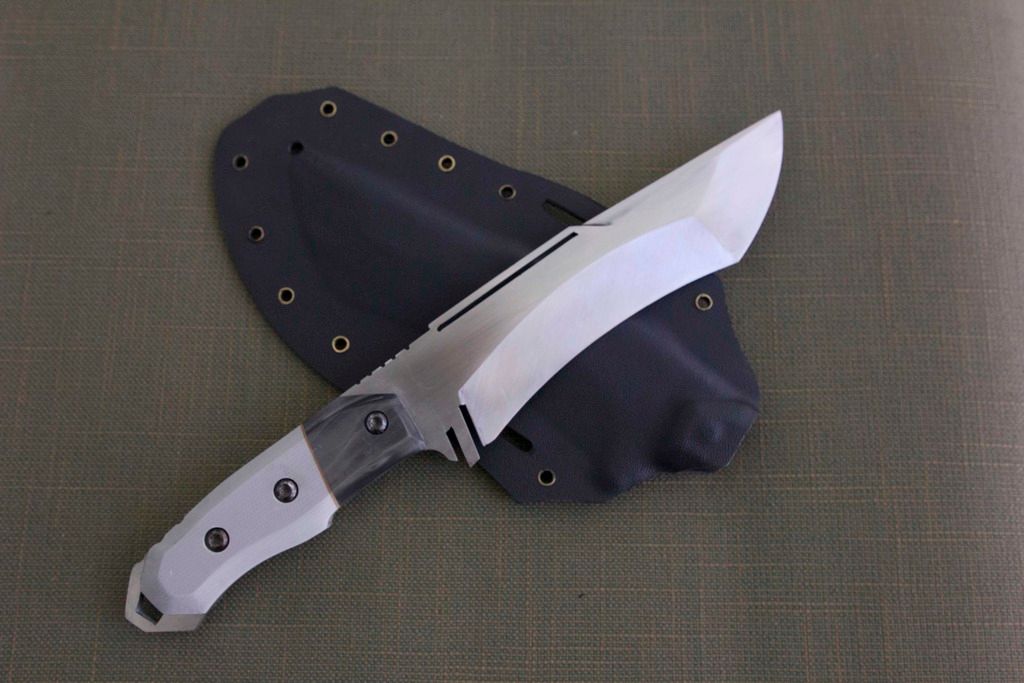

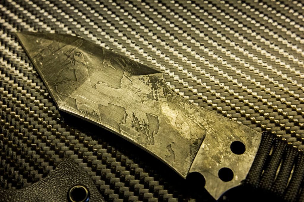

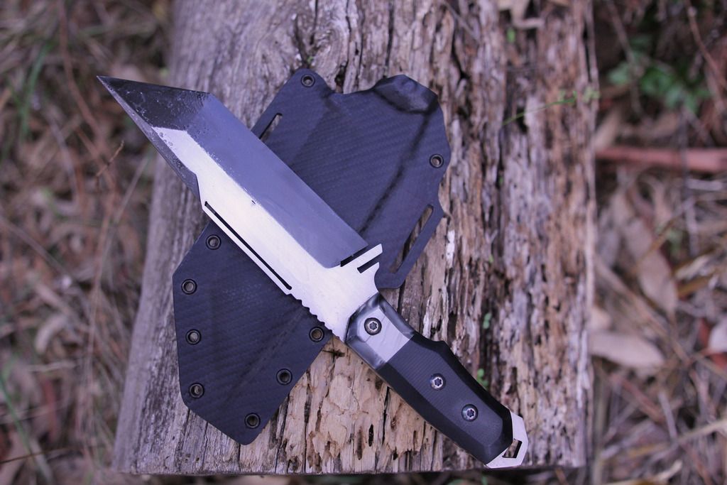

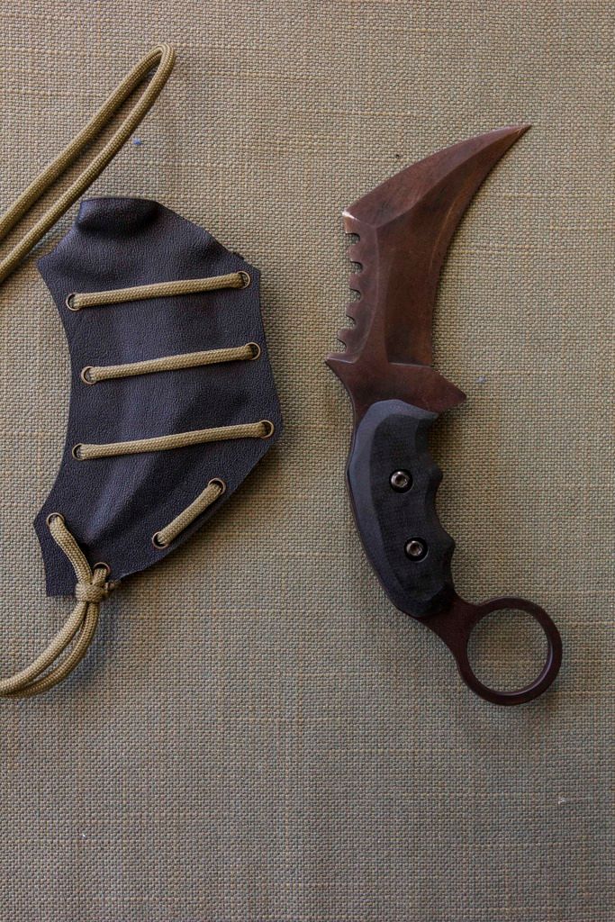

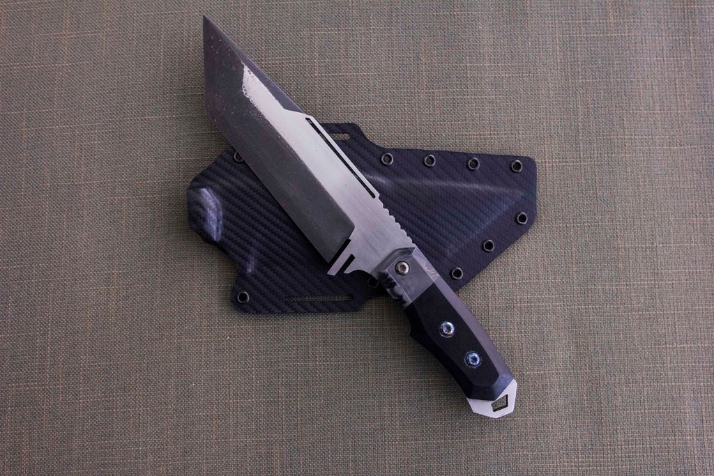

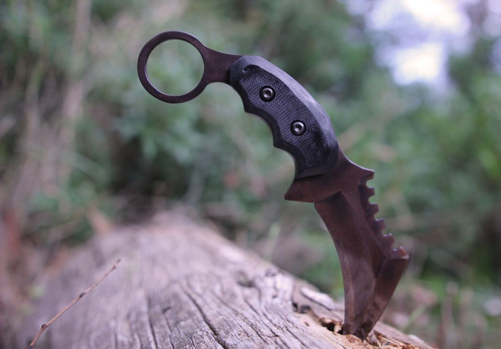

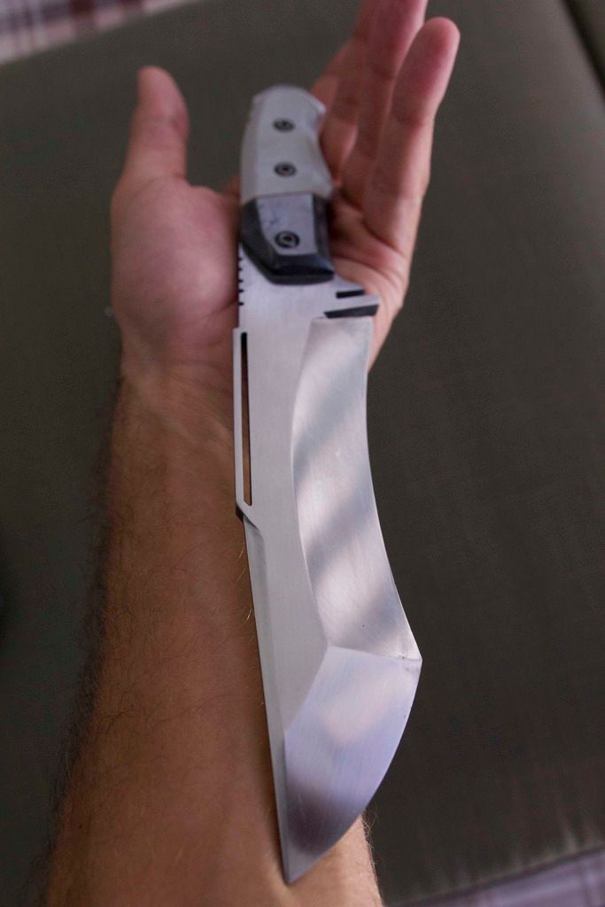

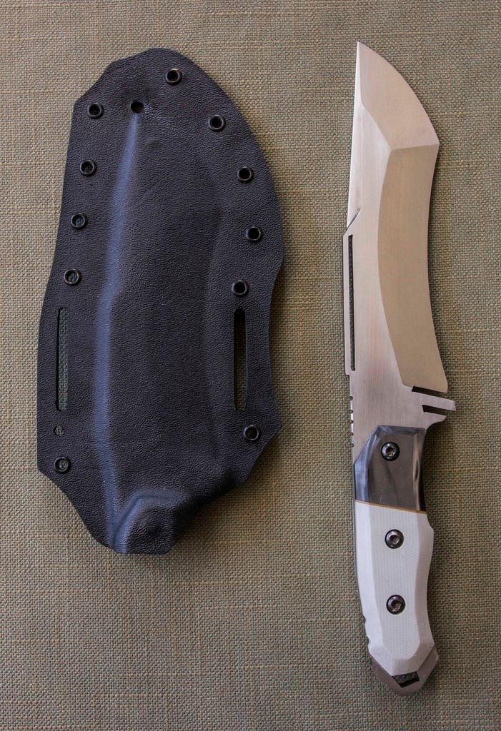

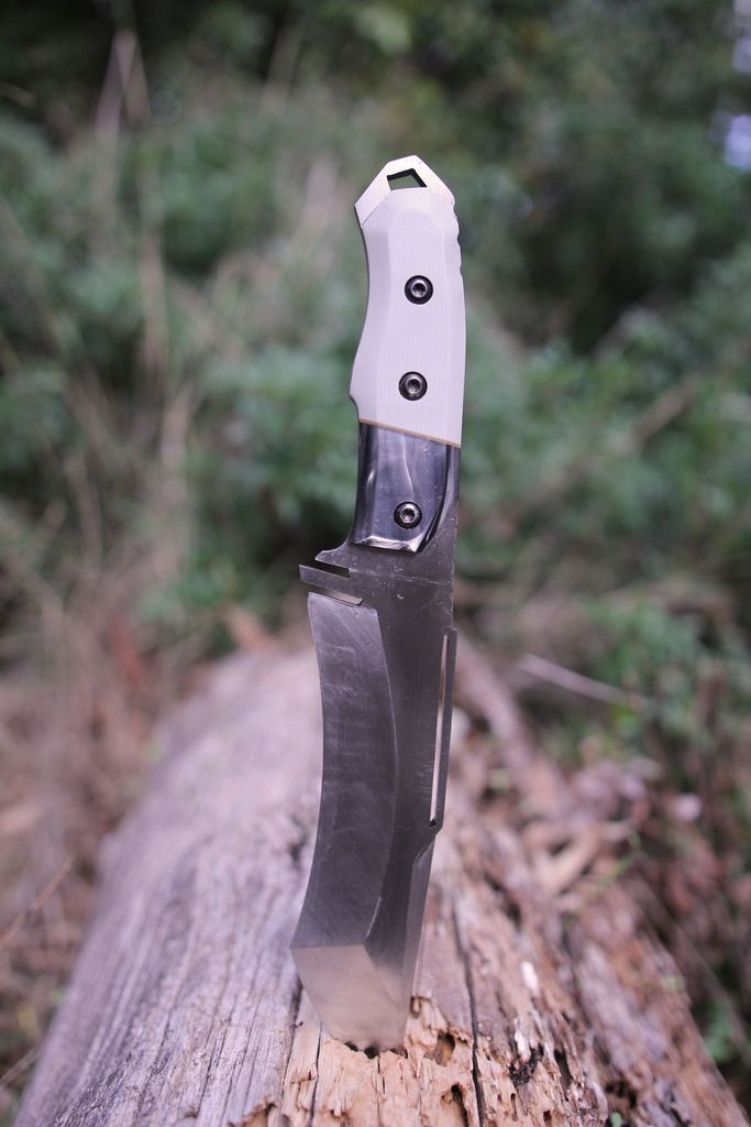

Hello everyone, greeting from Greece. These are my first 4 knives, 3 of them have yet to be sharpened but besides that they are finished.
1)Arne steel at 58 hrc. Lenght 200mm, thickness 4.9 mm and weight 110gr. Acid etch finish, simple paracord handle and kydex sheath.
2)Sleipner steel at 61 hrc. Lenght 190mm, thickness 4mm, weight 190gr. Black g10 handle and kydex sheath. I used hot bleuing for the finish and it turned out that bronze/rusty color.
3)Sleipner steel at 59hrc. Lenght 280mm, thickness 5mm, weight 280gr. Micarta black handle, kirinite bolster, coyote tan liner and anodized titanium screws. Holstex carbon fiber sheath and pcb etched grinds.

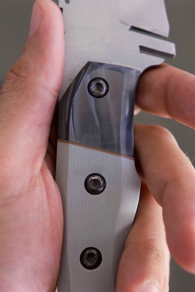

4)Sleipner steel at 59hrc. Lenght 280mm, thickness 5mm, weight 330gr. For the handle I used grey g10, kirinite for the bolster and a small piece of coyote tan g10 between them. Kydex sheath and satin finish.
Take and look and tell me what you guys think.
