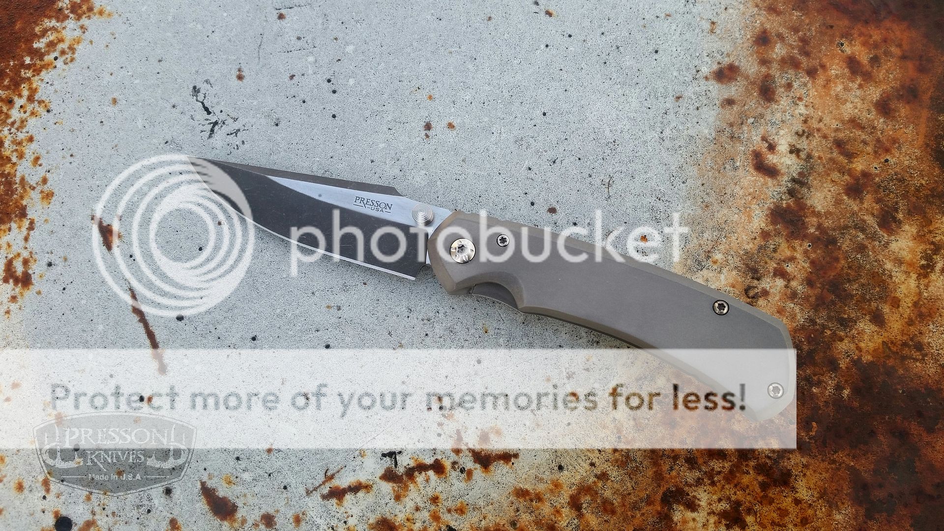

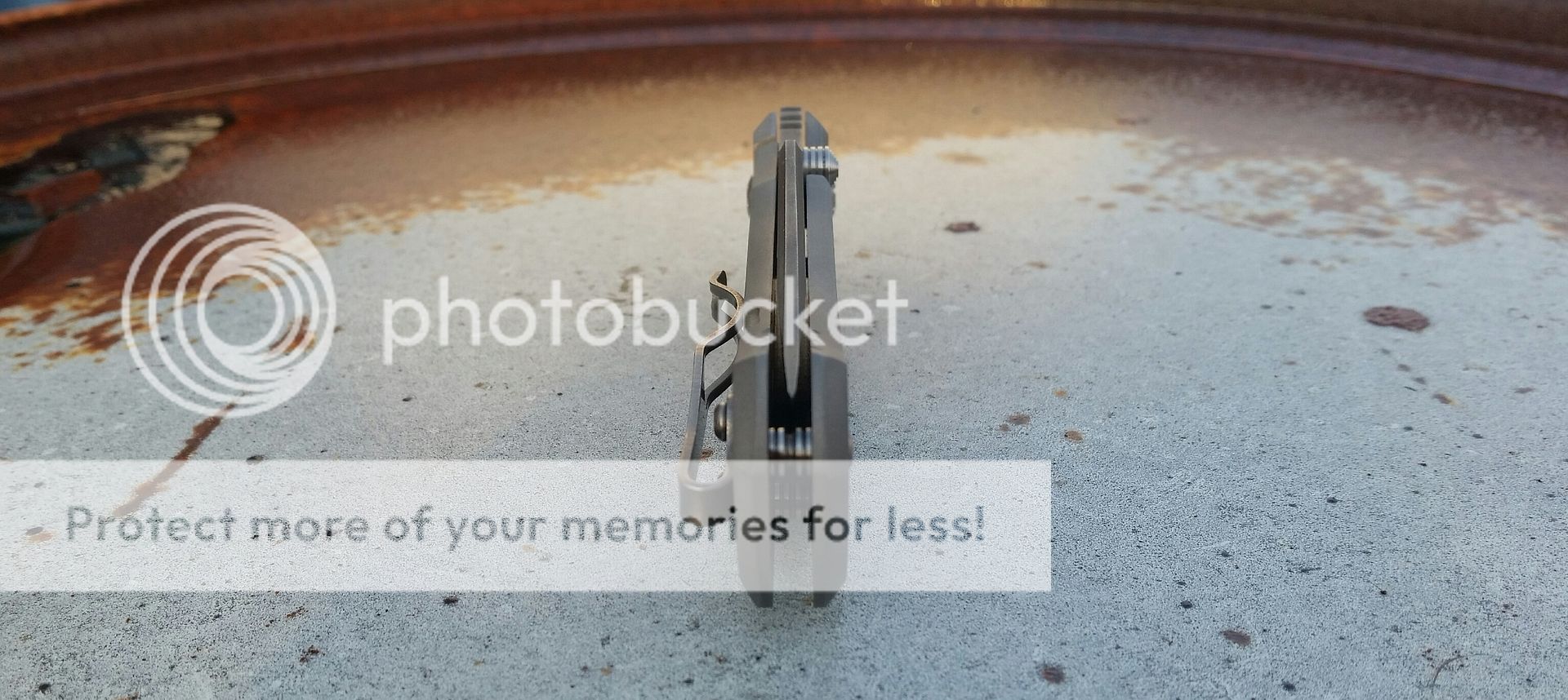

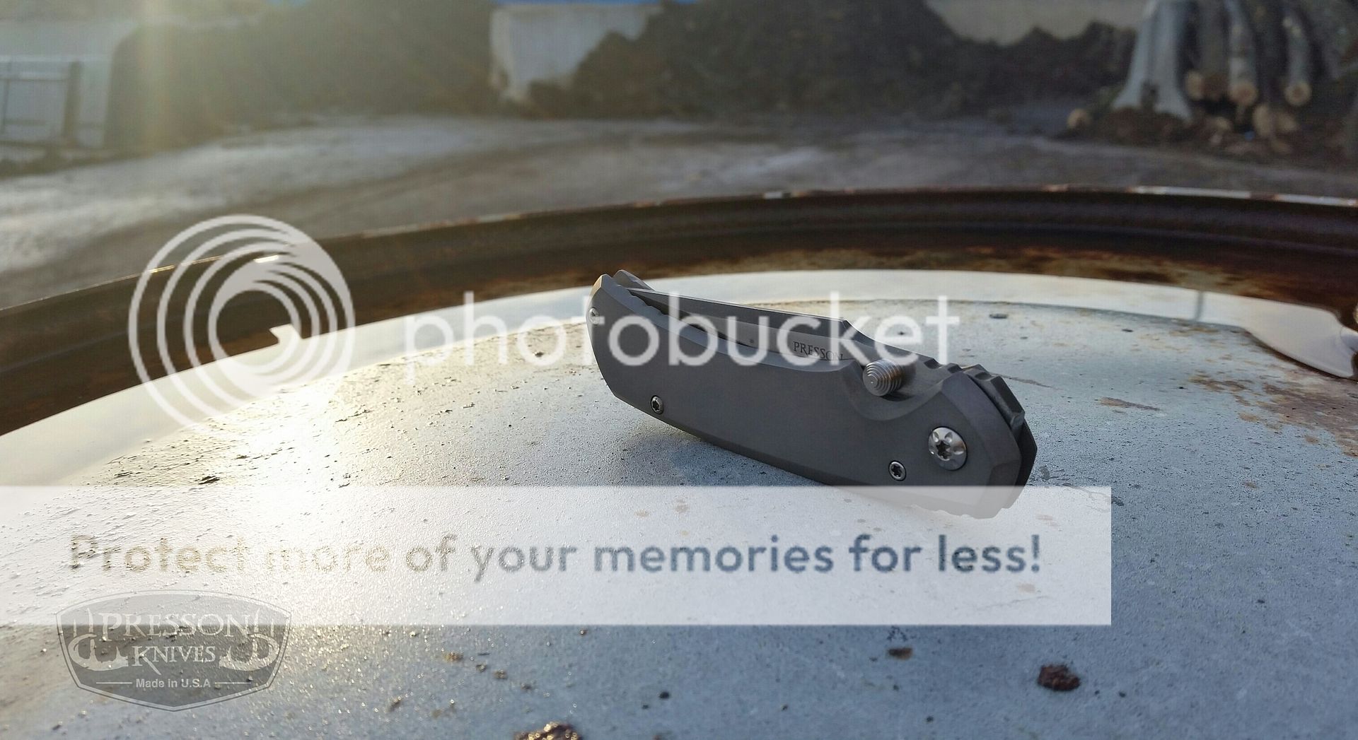

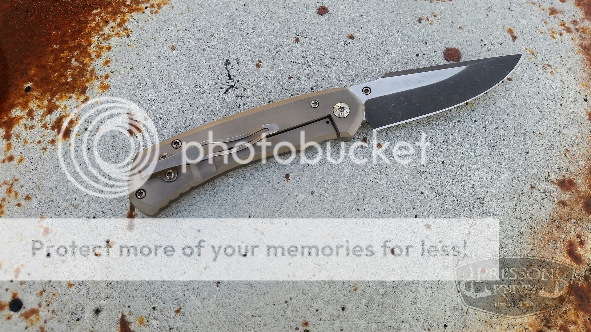

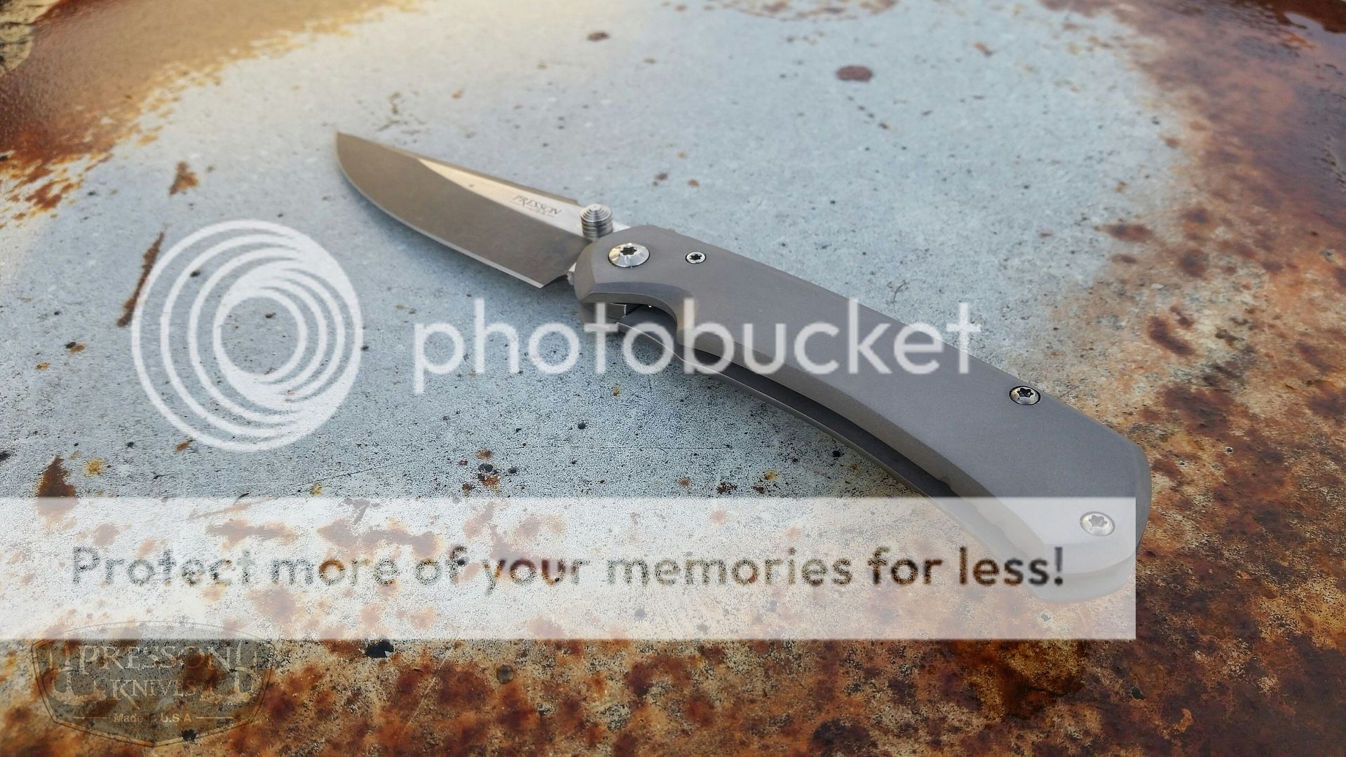

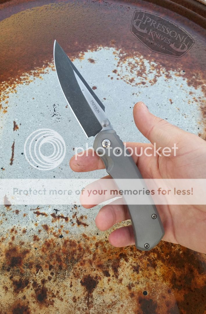

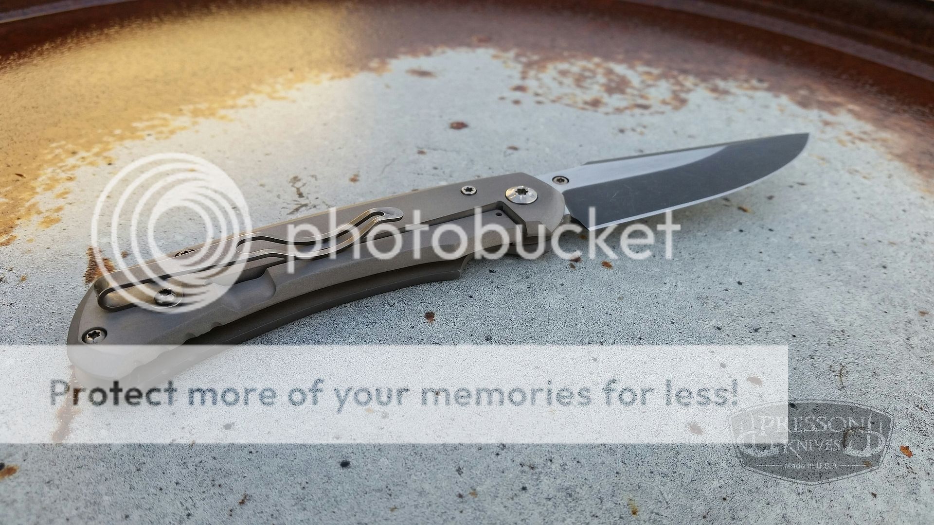

Here is my first frame lock I have made.
Thanks for the help I got on here and other forums also to others who have done wip and tutorials, I referenced Shannon Carters wip a lot.
Specs:
AEB-L stainless steel 60hrc etched and tumbled bevels and swedge.
Sandblasted titanium handle
Titanium pivot,screws and thumbstud
Titanium deep carry pocket clip from usaknifemakers
Overall length opened 8"
Blade length 3 1/2"
Closed 4 1/4"
Still has some spots on the flats that I'm not exactly happy with and the Cindy Crawford mole..lol but I can live with it for my first.
I started this back in July and had plans to make 2 one for me and one for my brother it has taken me a long time to finish so my Brother has been patiently waiting so I'm giving this to him. I know he will love it and will be in the family forever.
Thanks for looking, comments welcomed.
