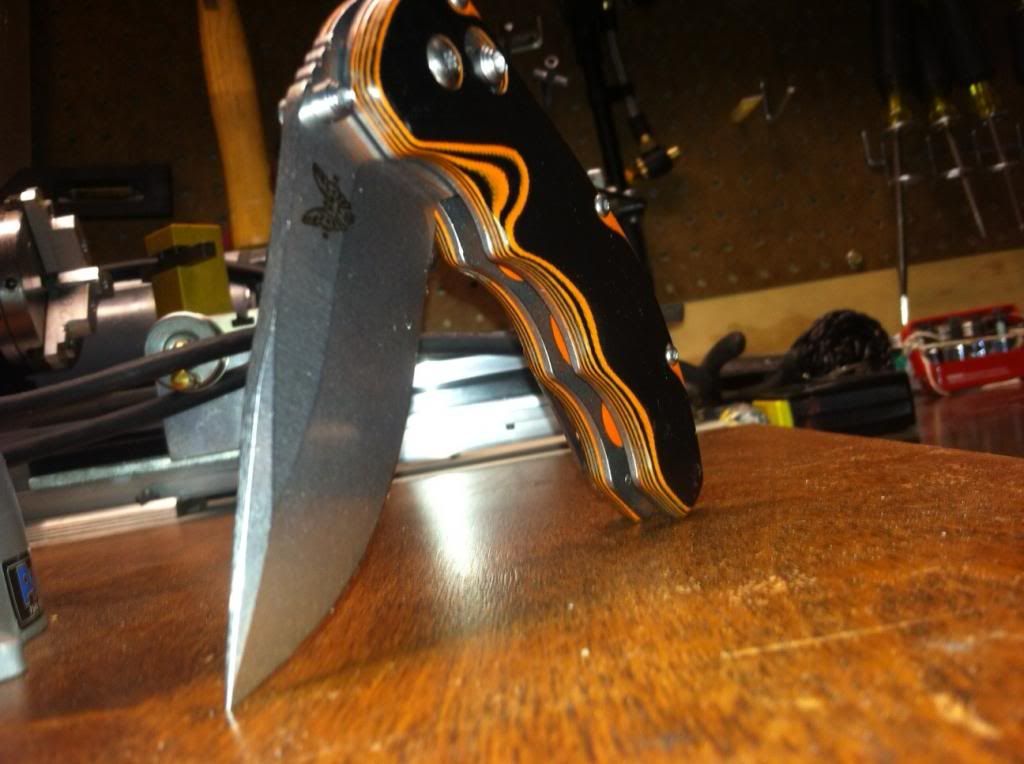

First G-10 Scale I ever made. Benchmde 300-SN
Jan 11, 2014
142

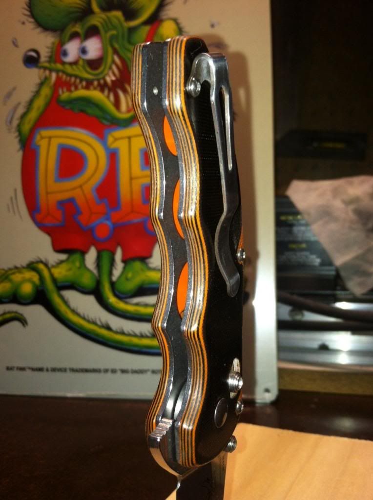

I decided it was time to mess with the old 300-SN. This is my first try at making scales. I'm right handed and only this side will have a thumb groove and only the other side will be drilled for tip up pocket clip. The other side isn't finished yet. Rather than counter boring the small screws ....I decided to mill out some swooping designs around the screws to drop them down a bit. This will be refined a little more as I go. FINISHED PICS LOWER DOWN IN THREAD.
Thanks .. My goal was to not have an aggressive pattern dug into it. One of my most used knives is and old Uncle Henry JB7 and it doesn't have much texture. Although I do like texture. ....I could go any direction with something. I like almost anything that has been customized.....as long as it looks cool.

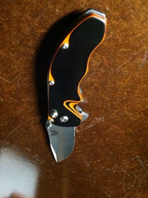

I finished up my first scale attempt today, this is not easy work.....I'm surprised I was able to make the pivot area fit perfectly. Down the road I hope to get some more accurate tools for doing scales. This is a task that you get better at as you do more of them. Here are a few pics to look at. Thanks again for looking and all the compliments. This is my EDC that I carry 90% of the time. There is no play in my blade and it comes blasting out when you hit the flipper.
Wow that is really awesome. I just made my first g10 scale also .. I traded it off already to get a fix for the knife junkie inside me . Do you know a way to get a flat countersunk hole for the hardware? All the bits I have have a radius on the inside
Look for some counterbore drill bits. Try Enco or McMaster Carr. Wood working bits may leave a small radius at the bottom.
