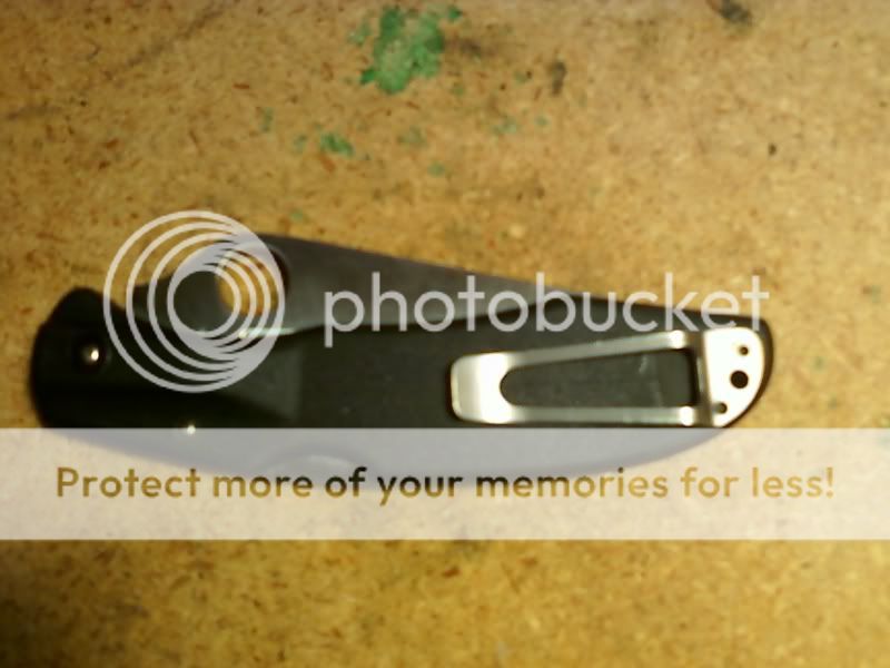

Well, the nice folks at Spyderco sent me out the screws and I put a US knifemakers Ti lowrider clip on it. Not too shabby.
Spyderco sent me the stuff to do the "upgrade" for like 15 bucks. I did the job in around ten minutes. One of the slickest Spydies to clip/unclip off the pocket. Love those old school Enduras. Sal's gonna have to do an anniversary run of 'em with some kind of super dooper bladesteel.
It is a bigger knife than I'm used to but it just feels right in the pocket. I've been carrying it without a clip for a week or so and it sits in there nicely. Hopefully it'll be even better with the clip.
