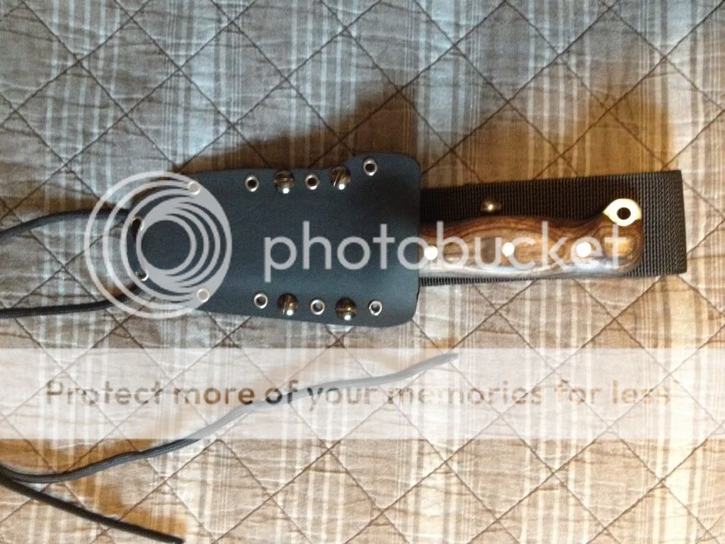

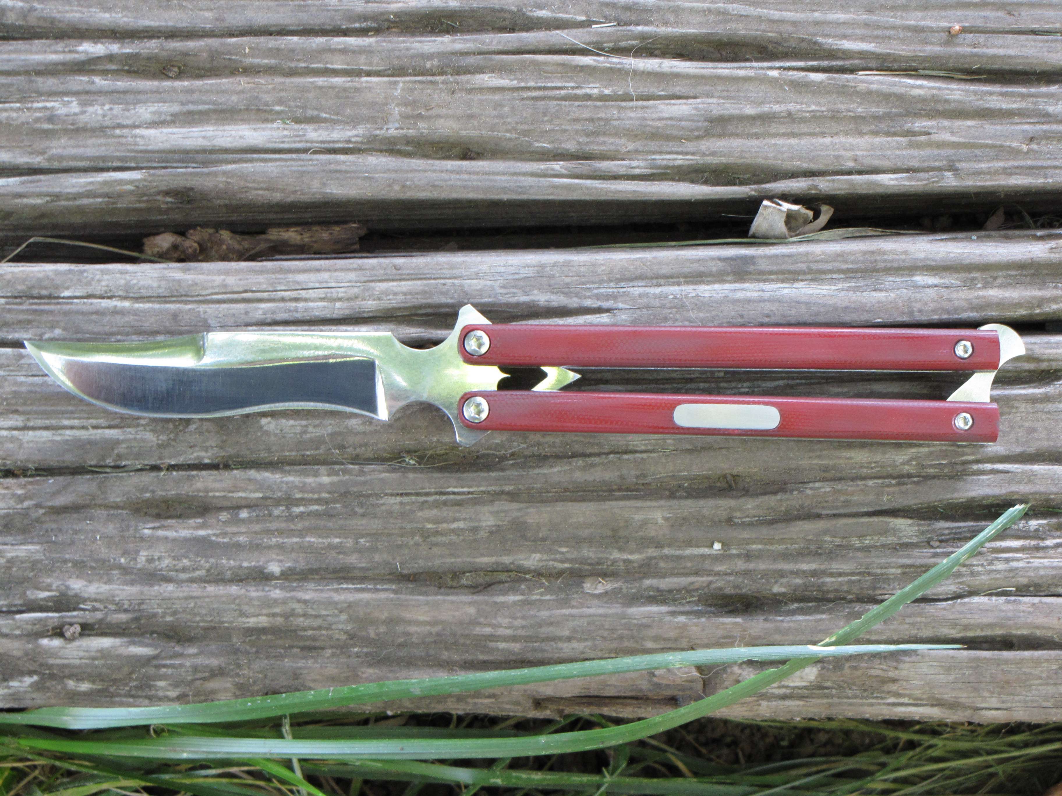

This one is my first:

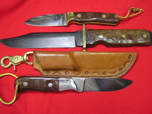

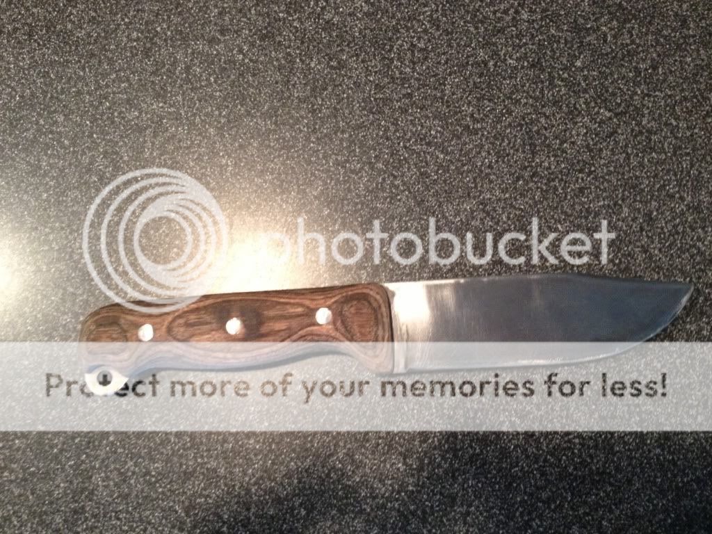

Here are some more that I have made:

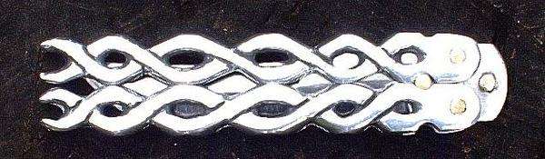

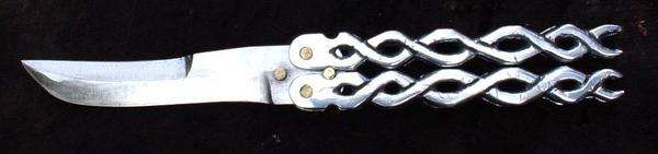

Not the very first one, but one of the first "good" ones, and one I still have:
WOOOOOW!!! That is so cool! Did you make that from scratch? Would you ever consider writing up a quick tutorial about how you made that?
Sure- I don't want to drift the thread too much though. I really didn't know what I was doing at the time. The blade is made from a file. I cut the metal using an abrasive saw blade on a table saw. I'm not sure how I was able to drill the holes, as I didn't anneal it at all. The holes are 3/16" drilled with a drill press. I ground the blade on a 1"x42" bench belt grinder. Never did try and give it a heat treat, but since I never annealed it in the first place it holds an edge well. I just got lucky I guess.
I made the handles out of a 1/2" thick bar of aluminum I found somewhere. I cut the channel using the abrasive saw blade on the table saw, lowered so it only cut to the depth that I wanted. I'm not sure how I managed this without seriously injuring myself, and I would advise against anyone trying this. The pattern was cut out with a drill and dremel tool. The pins are from a 3/16" brass rod I picked up at the hardware store, cut and peened into place. .
If you want to make your own balisong, or any knife, I recommend looking for the many tutorials that people have posted here on the forums. When I made this knife I was clueless and should have hurt myself. I shouldn't have been able to make it, I just got lucky. I've learned and continue to learn a ton of great information about knife making on this forum since then. It and our fellow members are a wonderful community!

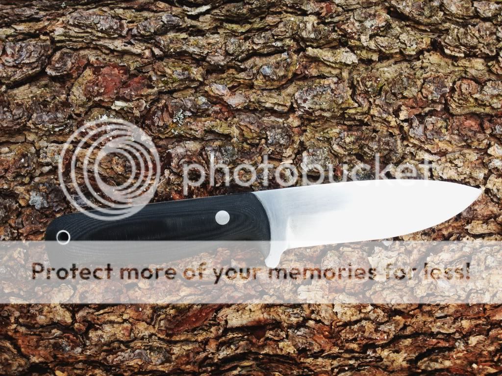

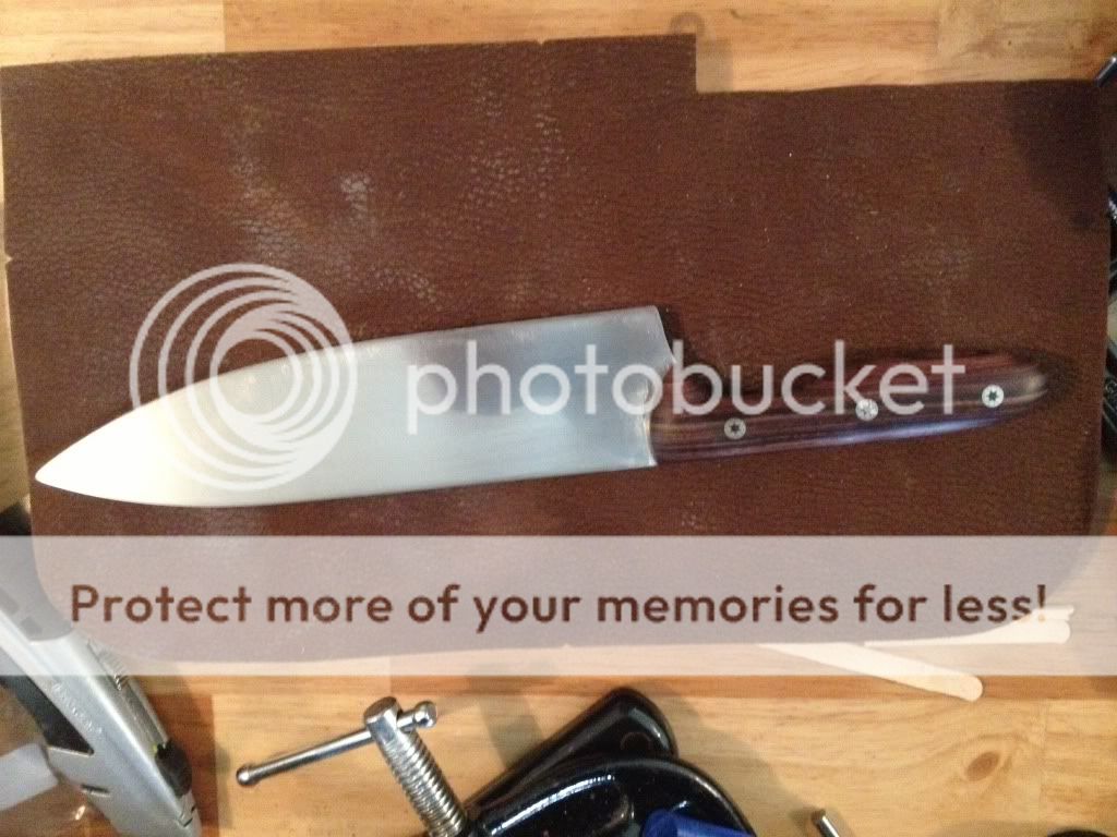

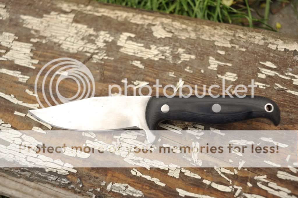

Here's a couple of my more recent efforts:

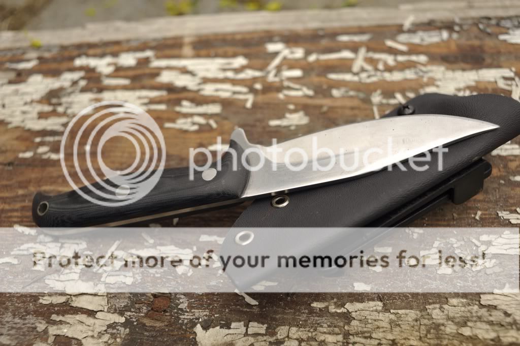

This was my first knife. I started small. It's 1/8" 1080 convex grind neck knife with a skeletonized tang. I also made the kydex sheath for it.
