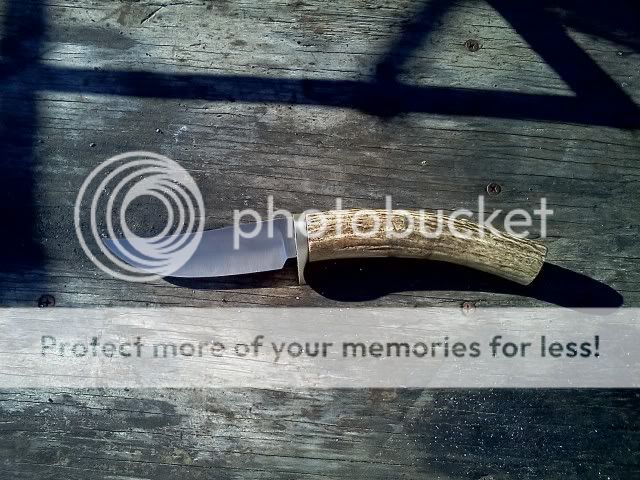

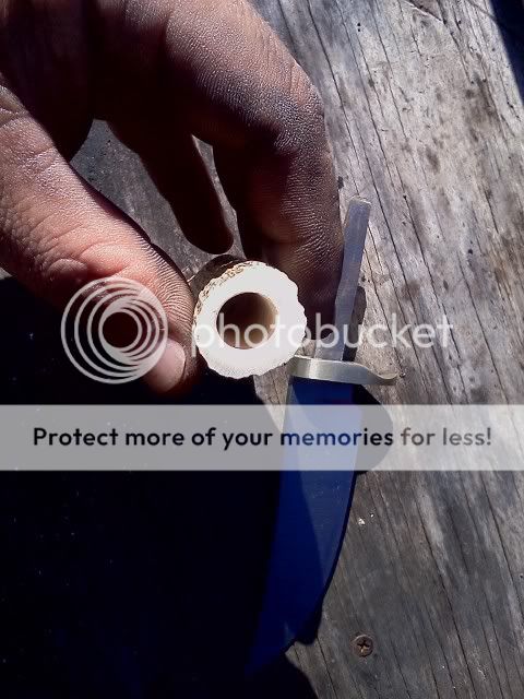

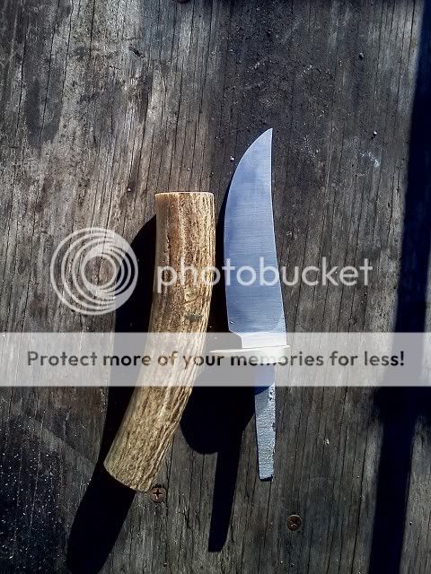

Like the title says, this is going to be the first attempt at a hidden tang knife. The materials being used is some of Aldo's 1084, Axis Antler and Brass fittings. I have the priliminary rough gringing done. I still need to clean up to 220 grit before I heat treat the blade. I will be using red g10 liner material between the antler and the guard. I filed the area that will be fitting on the guard pretty much as tight as I can get it. I will attempt to tighten it up a bit more before heat treat. I have never done this before and this one will ride with me. Any tips would be greatly appreciated.
I have no surface grinder or milling machine. I have to do with what I have in my shop which isnt much. Grinder, Drill Press, vise, and files.
Next Steps:
Clean up blade
clean up guard and attach liner material.
Fit everything together then drill 1/8" pin hole through antler and steel.
Heat treat blade.
Clean up blade
attach guard with JB weld
fit antler and guard
JB weld antler to blade/guard
