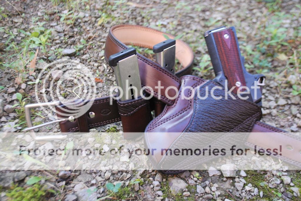

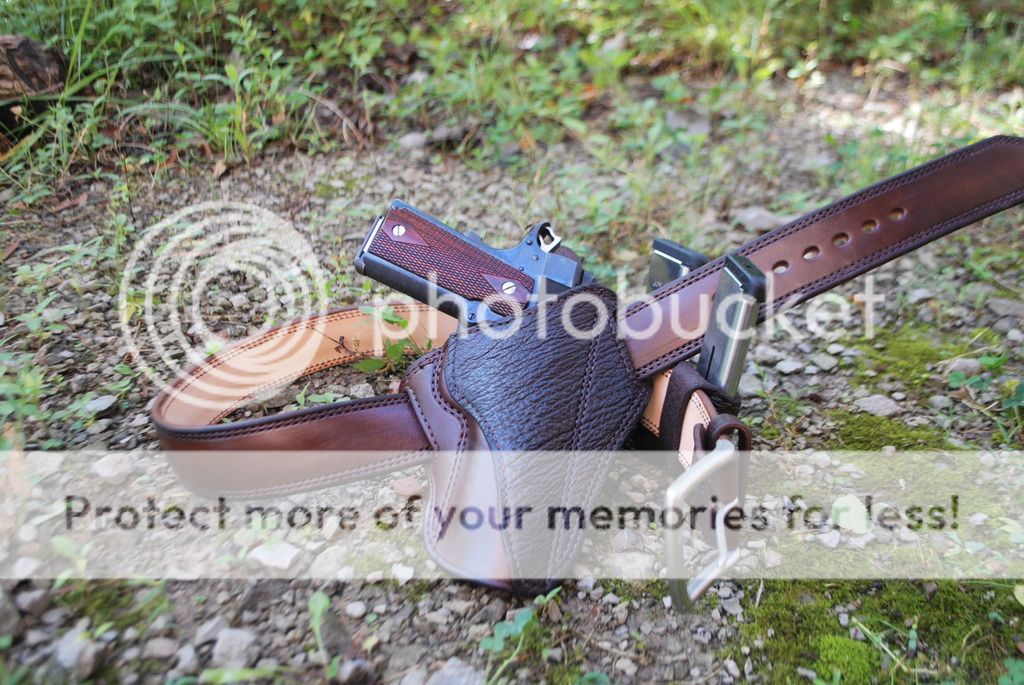

VP - as they say there is more than one way to skin a cat! You may consider something like this, which is one piece with a fold over belt tunnel. Minimal footprint and no clip. I'm not a fan of clips on gun gear for a multitude of reasons but the biggest is that when you go to draw it, the magazine needs to leave the pouch. If quick on and off is what's desired you can use a 'pull the dot' snap at the base of the tunnel instead of stitching. Good job and keep at it - magazine pouches are really a challenge when you lay the pattern flat and look at it.

VP - I'm sorry but I don't have a picture of one done in this method. Try as I might when things get busy the first nicety to go is photo shoots! A 'pull the dot' snap is a directional one way snap. It can only be put on one way, and taken off one way. They are popular in holster work for this reason as you can negate some of the ill effects of a standard snap in that application.
Drew this for you and while it is crude you should get the basic Idea.
