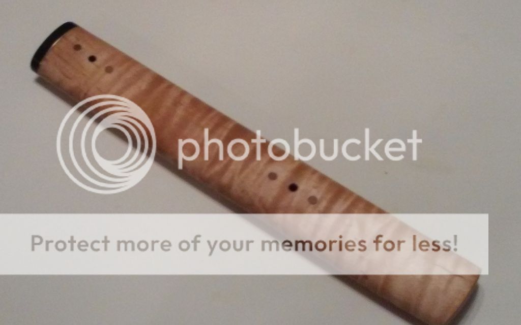

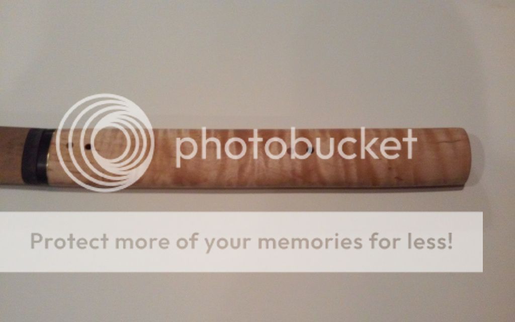

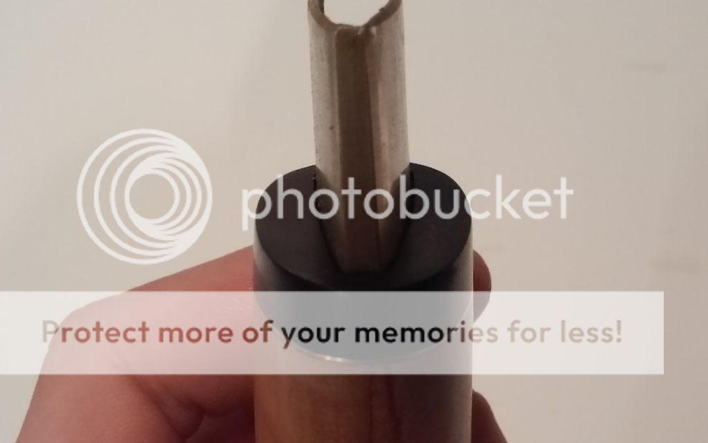

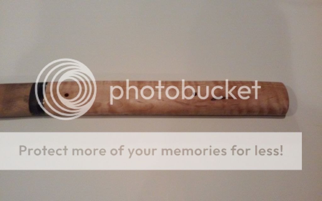

A few months back, a buddy of mine asked me to strip the ugly maroon lacquer off his Katana's Shirasaya. I was pleased when I found that the Saya was a fairly nice wood of unknown species and a bit of figuring at the top. Unfortunately, the Tsuka was some ugly lookin' wood, similar in hardness and grain pattern, to White Oak and had many worm holes and voids filled in with some form of Wood filler. In all honesty, this was uuuggly and we both (me and the owner) agreed it should be replaced. This decision ended in a bad way, and a good way. Good, because, despite some highly noticeable blemishes, the Tsuka came out beautifully. Bad, because I never want to make one again xD
Here she is fellas-

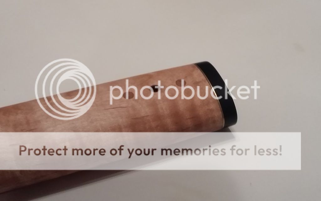

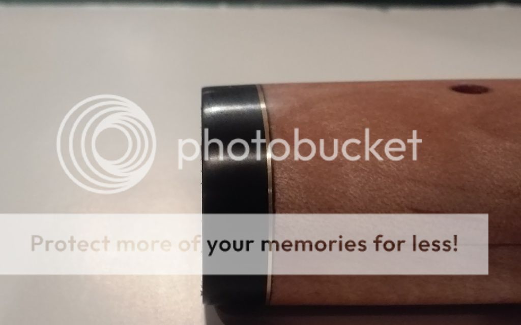

The main part of the handle was Tiger maple (not book matched) with some nice figuring to it. There was a small void about 1" long that I filled with Super glue and sanded down to 600 grit (along with the rest of the Shirasaya). The two sides were glued together with Tite bond 3 wood glue. The bolster is Gaboon Ebony, apx. 1/4" thick, that is bolstered by a thin (1/32" or so) piece of brass. The brass was epoxied both to the maple, and the Ebony using G-Flex Epoxy.
Some photos-

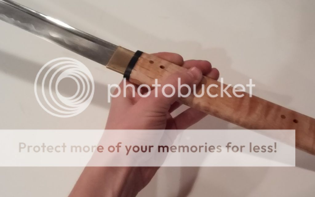

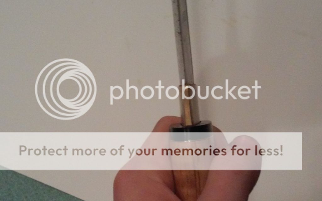

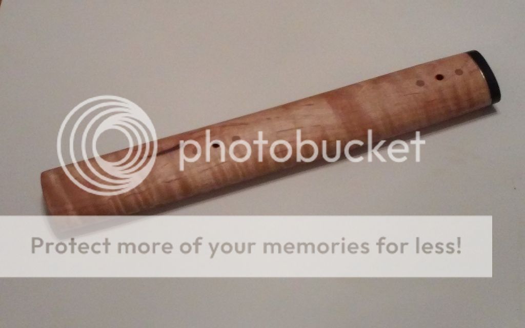

Critiques welcome, I know I made some mistakes (the blatant mis-drilling of two holes :rolleyes: ) so I don't think a comment could be as devastating as that was!My terminology may be incorrect as well so sorry in advance ;)
FYI- I talked to the customer about the two mis-drilled holes and he said to just fill them with plugs and not bother with re-making the Tsuka... contrary to what i suggested.
Sorry for the bad pictures, I don't have a nice camera and the only camera I do have that takes decent photos is on my free tablet that came with my moms cell phone :o:o Someday... SOMEDAY I'll invest in a nice camera!
Well, at 16 that's not too bad.
There are obvious errors that should be avoided on the next one ( or other knife handles).
Take a single block of wood and split it in half, or use bookmatched scales. A mismatched handle is going to draw the eye away from the good work.
Measure for the mekugi ana and mark it on the tsuka before it is glued up. Drill a 1/8" hole through one side and use it after the tsuka is assembled to make the through hole. I like to make the final length just about 1/4" too long, and carefully shorten it until the mekugi (peg) fits perfect.
When something is messed up, make it a feature. The extra holes could have been disguised by putting a third hole on the other side of the mekugi. Use two light pegs to fill the blind holes and a dark mekugi. The other side could be left as it is with one hole, but would be a better match with the three holes as the other side has. One larger dark bind plug in the center could simulate the menuki.
The dark glue joint is also off putting. Sometimes it is unavoidable, but try to use a resin that is clear or matches the wood type. Clear epoxy, like T-88 is a good choice. Sand both surfaces to dead flat and double check that there are no gaps. 120 grit works well as the grit to prep the mating surfaces. Don't go much finer.

It did occur to me that perhaps drilling through to the other side of the Tsuka through the accident holes and pegging those as well would help with the symmetry. In other words, replicating the "Pattern" on the other side. As you mentioned simulating the menuki with a dark plug, I had the idea of using a mosaic pin to act as a menuki. If I make another of these, I may try that out. However, I do like the idea of having two pegs on either side of the mekugi and incorporating that into the design.
If I ever happen to do a job like this again, I will most definitely purchase a solid block and split it down the middle. It still bugs me that the flame patterns are so different from side to side. For future reference, would it help to have that block stabilized or would un-treated wood suffice? As for the glue joint, that too is something I knew would be a problem immediately after taking the first pass with my spoke-shave. I contemplated using more g-Flex but I knew that the Tite bond would be plenty strong for wood to wood bonds. Looking back, I don't think it would have made a difference, regardless of the adhesive used; there would have still been a line. I'll keep the T-88 in mind for other "Seamless" glue ups.

Just a quick update: I drilled holes for more plugs on both sides (one on either side of the mekugi hole) of the Tsuka so hopefully, assuming I use end grain maple, everything will look symetric. I will upload pictures as soon as i get the plugs glued up and sanded flush.
Alright, she's done! Thanks a bunch Stacy, your suggestions helped make this 100% better!
I followed the same procedure I used for the other plugs: Cut some 2" x 1/4" x 1/4" pieces of the maple, sand down to an octagonal shape, and chock it up on the drill press. Sanding it down to a nice, tight fit and gluing it up in the hole (being mindful not to push it to deep into the hole so as to not restrict the fit of the nagaka...I think that's what it is :rolleyes:). Then cut off the excess with a flush trim saw and sand to 600 grit.

excellent. now the extra holes look like you meant them to be there as a design.
Yep! I'm thinking of using some Bloodwood or Amazonian rosewood as the Mekugi so that will add to the design and serve as a good contrast to the gold colored maple. Should be interesting when it's all put together!
