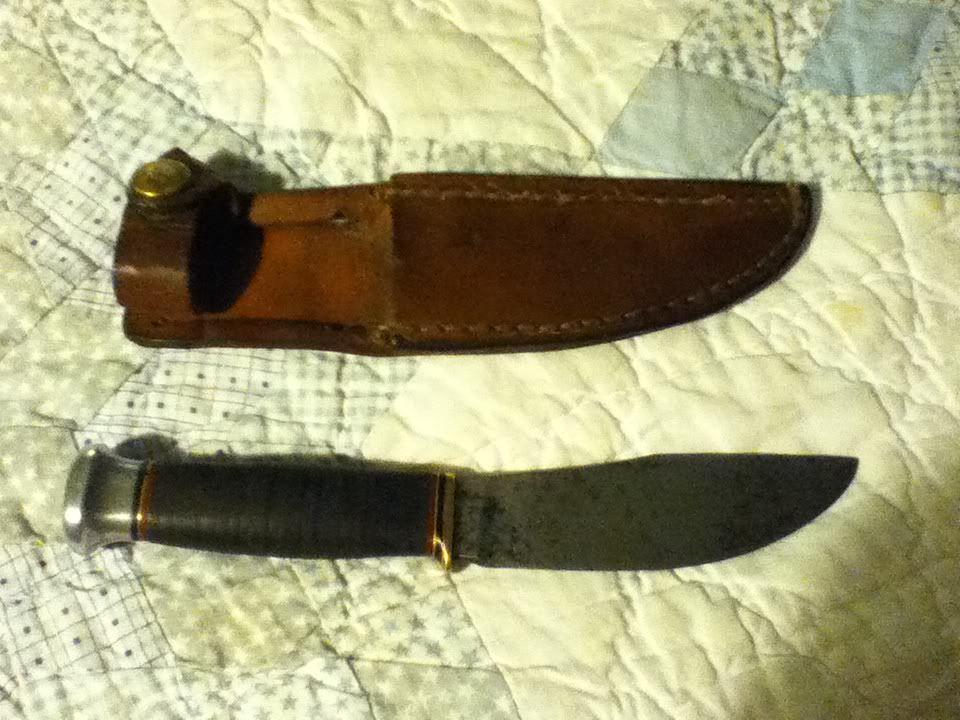

So I just purchased my first knife since I was a kid (used to be into cheap pocketknives and switchblades when I was younger). It's a Marble Woodcraft I believe. I was hoping you guys could help me date it and provide a bit of advice to a new owner.
I got it off of craigslist from a guy who got it at an estate sale and believes it to be from the 1925-1930 era. He cleaned it up a bit with steel wool but the blade still has a lot of patina. I don't feel strongly either way but is there a protocol for when to shine up an older knife and when to leave it worn?

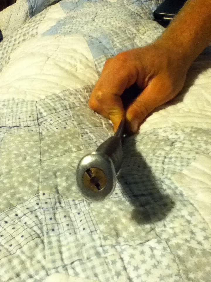

I bought the knife to use it but I'd like to know if it's valuable or should be treated more as a collectible/antique? Assuming I do use it, is there anything special to keep in mind when sharpening a knife that's 80+ years old? Any other care and maintenance tips specific to older knives (I've read to oil the leather washers so they don't shrink)? The pommel is also a bit loose (can be turned about 10 degrees side to side), I'm guessing tightening the key on the butt might fix this but do I need a special tool, is this something I should be messing with?
Last thing, looking around online, the old Marbles sheaths that look similar to mine all seem to have metal grommets but mine just has stitching. Any ideas if this Is this the original sheath?

From just before WW I to WW II, this was the most popular "hunting" knife in the U.S. Many makers copied it when they could, including Case, Kinfolks, and Wade & Butcher. There are a dozen Marble's versions on sale on ePrey most days. They seem far more common than all the copies combined. You can go there and see what they sell are selling for.
Collectors suggest very minimal treatment. Users do what suits them. Personally, I like the patina.
I have a couple and made a tightening tool for the handle nut out of 1/16" sheet steel stock. Only took a vice and file + ten minutes. Some have made do with needle-nose pliers. As to oiling the handle, never use Neatsfoot Oil. Most products sold as such are petroleum-based and destroy leather.
Marble's made great knives that came in sheaths that don't last well. Finding one in an after-market sheath is very common.
Enjoy. You have a classic.
Use it if you want. Collector value is there, but it's more on the order of a new hunting knife, rather than a new car;).
I wouldn't clean it, to me a old knife should look old, and any heavy restoration would hurt the knife rather than help it. Just oil the blade with some mineral oil, and leave it alone. To tighten the handle, make a Y tool as Thomas suggests, those split pommel nuts are soft and can get beat up easily.
Thanks a lot guys. Got the handle nice and tight, will get some wax for the leather and oil for the blade. Just need to sharpen it up now, it barely sharpened a pencil today, haha.
