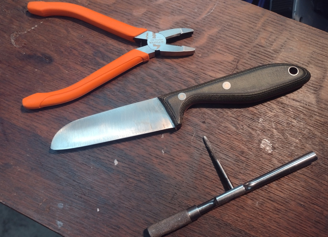

Update on my first knife build. l've thinned the blade down quite a bit, but trying to
grind in bevels free-hand on a harbor freight 1x30 belt sander has been...challenging to say the least, so l've decided to convex the entire blade. For some reason, I find that easier to do with my equipment. l've also added a thumb choil(?) lt's pretty sharp now, though! Any advice?
Nice job! The below suggestions are for future projects, not a criticism of your first knife.
Suggestions:
1) The piece sticking out at the heel needs to be ground off to be flush with the edge. Then add a very shallow semi-circular indent. That is no problem to fix.
2) The thumb Rest really isn't a feature of a tanto. If you make one, the spine should rise in a ramp and the thumb rests on that raised curve, not in a depression.
3) I can't quite decide what is off with the handle, but I think it is too "rounded" looking. Most tanto have a pretty much straight and squared end handle. A slight drop at the butt is ok.
4) The Blade width is a bit wider than necessary. It is OK, but a slightly slimmer blade may look better. About 3/4 as wide would be good.

Thanks for the input!! That all makes sense. I drew the handle up slightly more angled than the way I ended up grinding it, but I'll modify it a bit more to match what I originally intended for it. I've also ordered an angle guide to help in making bevels.

My intention for this was to be an EDC self defense sort of blade. Sorry, I should have mentioned that in the original post!!

Idk if I saw above.... Is it Hardened yet?
What steel?
I actually don't know what it is, but it rusts very fast, throws a lot of sparks, and it takes a long time to grind, similar to the old files I'm working on. So I assume it's already been hardened. It was a piece of metal I found that was used as some sort of arm and I just cut out the flattest part of it. This is basically just practice for me, I don't imagine it'll make the best knife since I don't even know what it is lol.

Even though I'm fortunate enough to make knives out of nearly any of the latest trendy steels I still occasionally make knives out of saw blades.
Look up Power Hacksaw Blades.
Starret is a company who makes some of the best.
You need fully hardened HSS (high speed steel) Red Stripe.
NOT bi-metal ones!
The blades are exceptionally Hard. Very Hard. 64-65 HRC. It might take you weeks to grind.
Grinding them is how I would teach people how to make knives. They make excellent knives. Others may try to talk you away from using them, but I personally feel they would be wrong.

I'm going to be your Uncle Stacy here.
Any steel that you don't know what type it is or how to HT it is not knife steel.
Disclaimer - my first knife was made from a piece of metal I found in Grandpa's garage. It was not knife steel, but I was proud as heck over that KSO.
If you want to make knives, not knife shaped objects (KSO's) ... use a known knife steel.
For new makers simple steels are easiest. 1084, 5160, and similar steels are readily available, cheap, and easy to HT.
