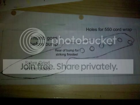

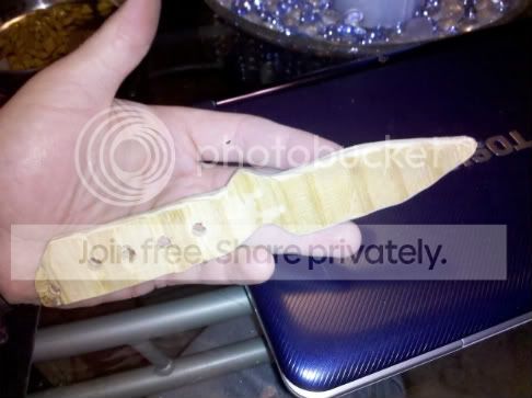

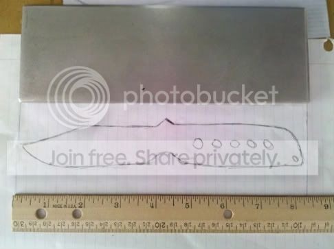

I'm in the same boat as you are. I have recently decided to build up a knife for myself. I have a rough drawing of it (mind you, I am no artist). I don't have a lot of experience when it comes to all of the parts, as I am a true novice. However, I do know what I wanted in the design, and I made a wooden copy based of my drawing. So far, I like the feeling. We'll see how it is once i wrap the handle with some paracord.
First rough drawing, based upon what I wanted:
Wooden version based upon drawing:
Revised Design, based off of experiences with wooden copy:
