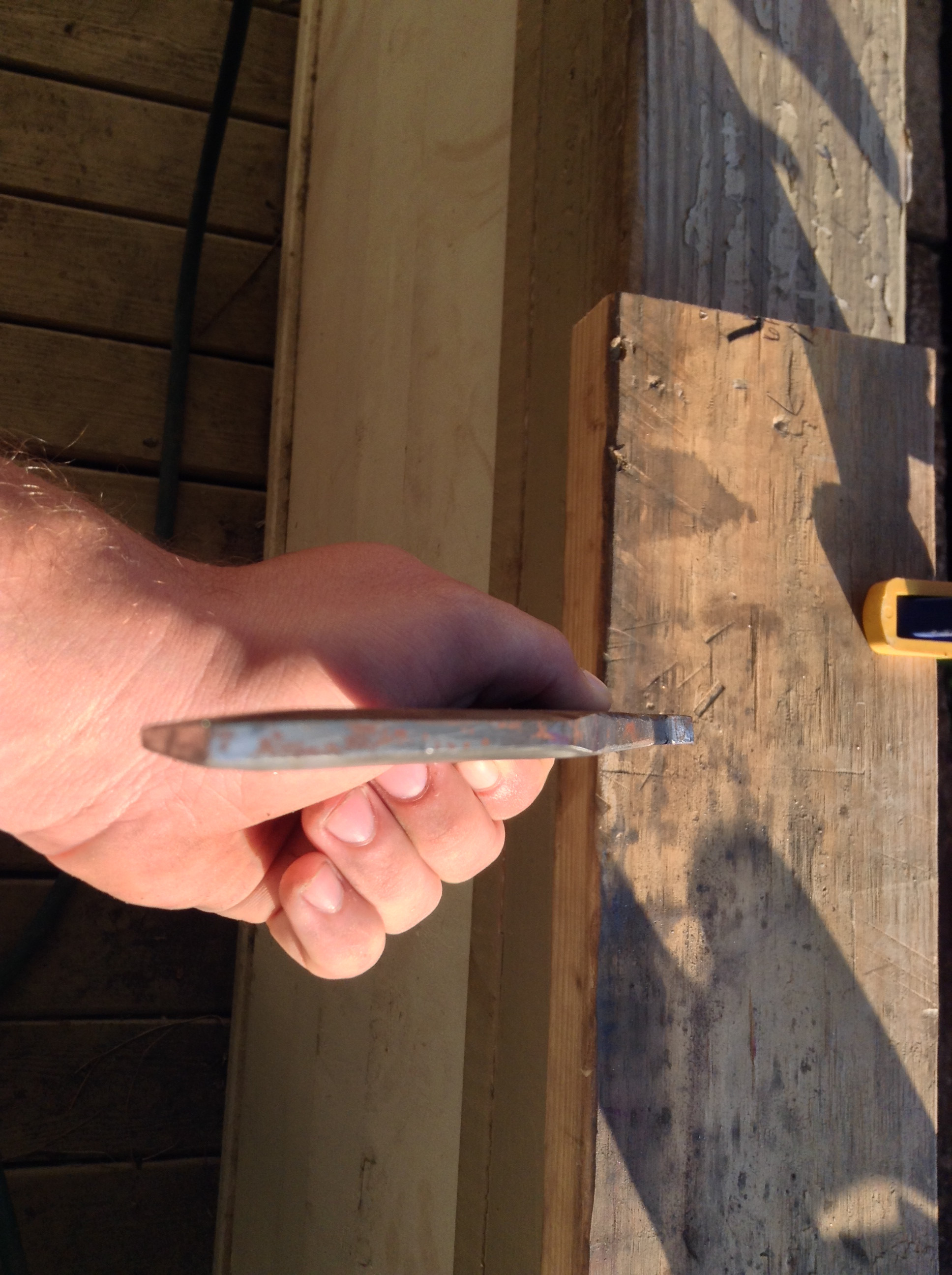

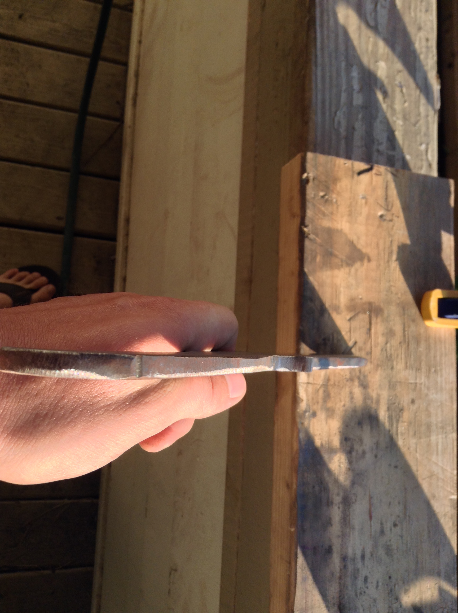

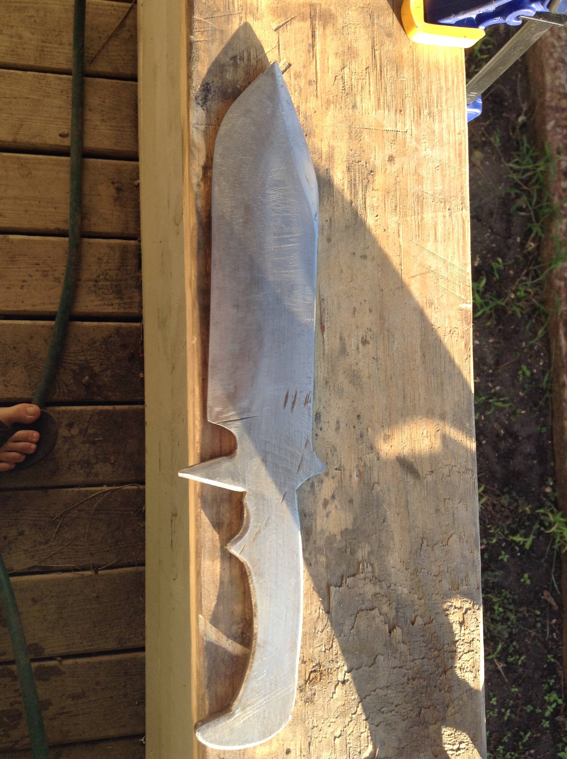

Still alot of work to do on the bevel
1095 1/4" thick
Will post more pics as it comes closer to completion ;)
down the back of blade (top side)
down the front

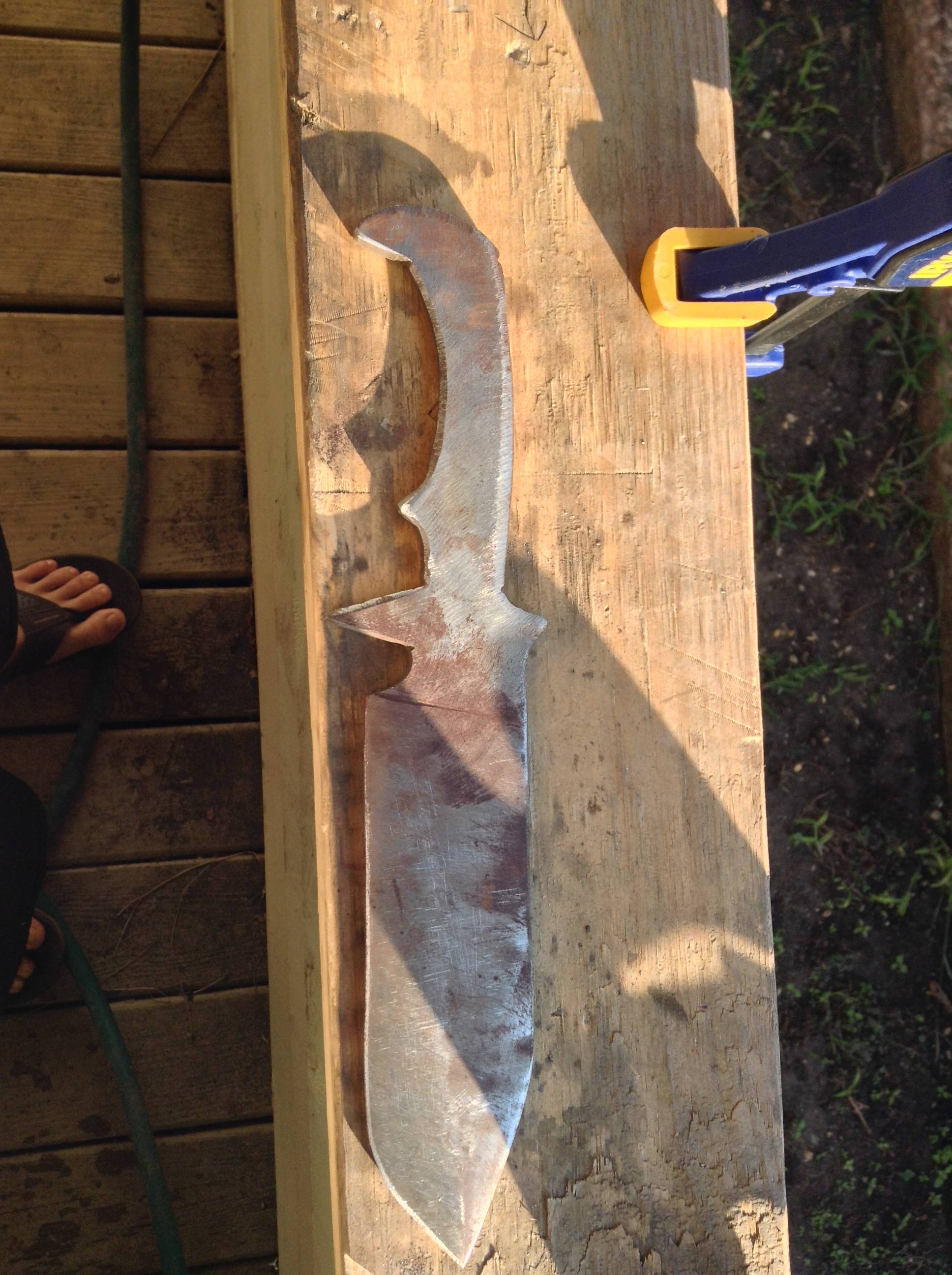

What do you think? Did I make the handle too skinny?
Any questions/comments/concerns are more than welcome :)
Well...I don't really know what to say. My comments below are to help you with future knives. They are not attacks on you. Take them as well intentioned critique and try to improve on the next one.
Suffice to say that it would have been far better to post a sketch first.
Here is a basic list of what strikes me:
1) 1/4" is hugely thick. 1/8" would have been better.
2) The blade is massive in comparison to the handle.
3) The blade is too "blunt" and lacks shape.
4) Handle shape is...well..terrible. I would expect it to break easily at the spot behind the spike. The drop from the spine is also a bad thing. It will make the knife look and feel very unbalanced. If the spine had gone straight back and made the handle wider it would have been far better.
5) The spike??? What is that all about. It is pretty useless for anything but getting in the way of chaffing the forefinger.
Again, it is what I see that sticks out, not an attack on the knife.
1. I agree, filing this bastard is taking forever
2. yes it is pretty large
3. do you mean the curve from the tip to the bottom of the blade?
4. that was my worry about the handle too... I put the little grooves on the top and bottom and front and back of the handle to so 550 cord would stay in place.
5. The spike is really just a finger guard.. I was going to round it off later
This is exactly what I was looking for, no hard feelings whatsoever. Thanks Stacy :) I'll go play with it and post progress later :)

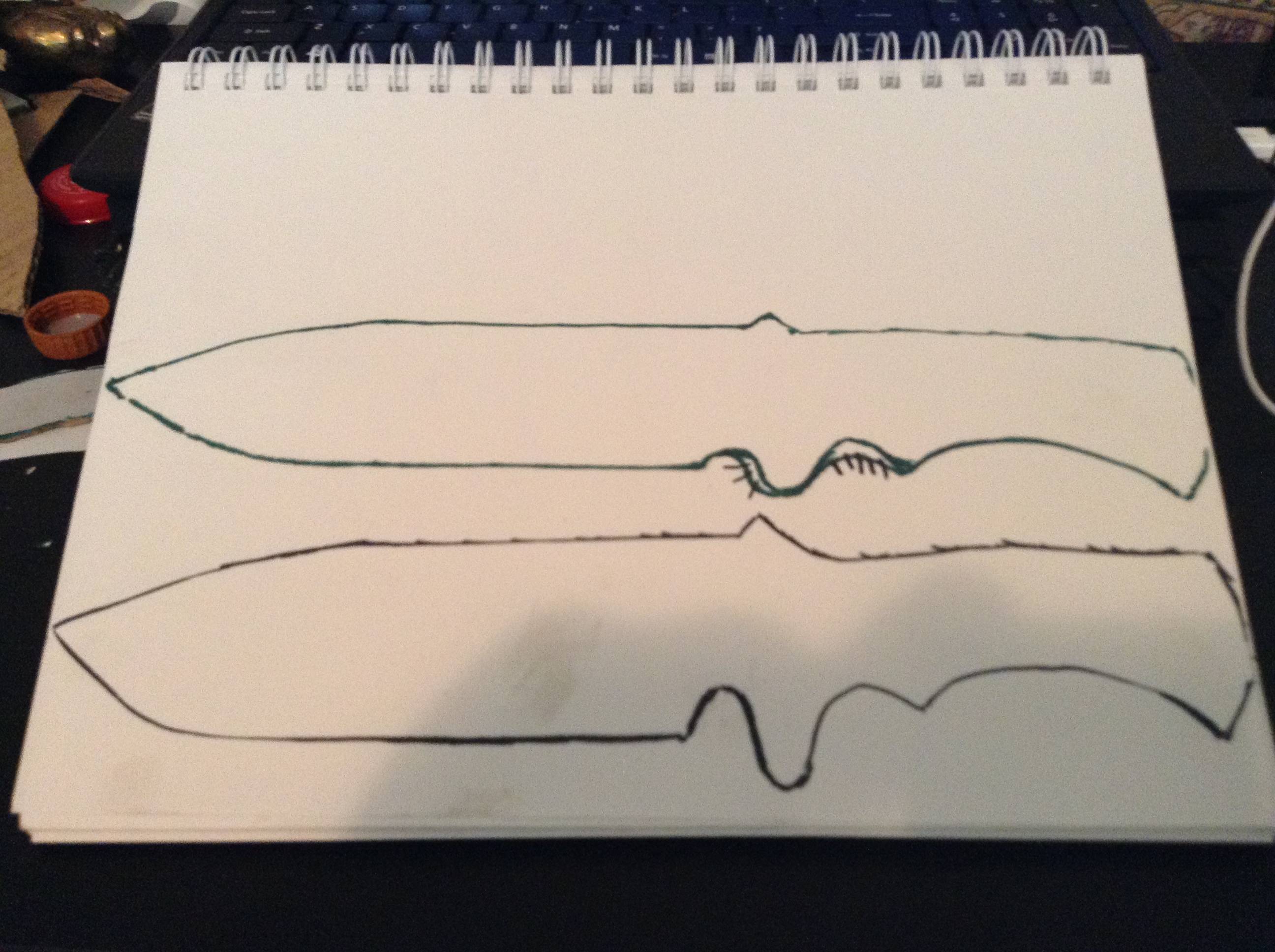

This was the original template on the bottom, with slight mods on top:

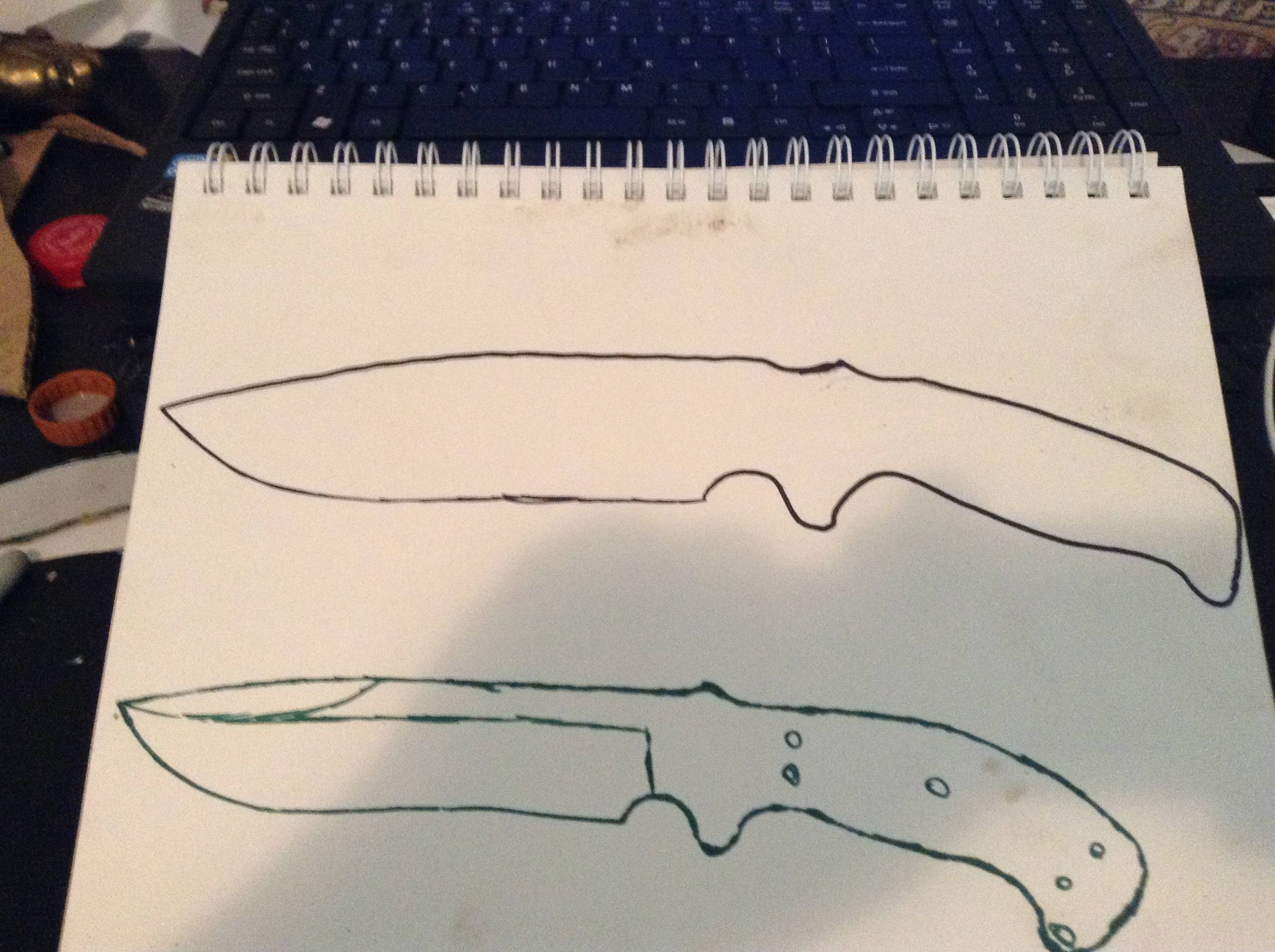

Heres a second template I created
And the one on bottom(green outline) is a copy paste from another knife I found on this website, and the one on top is a larger version

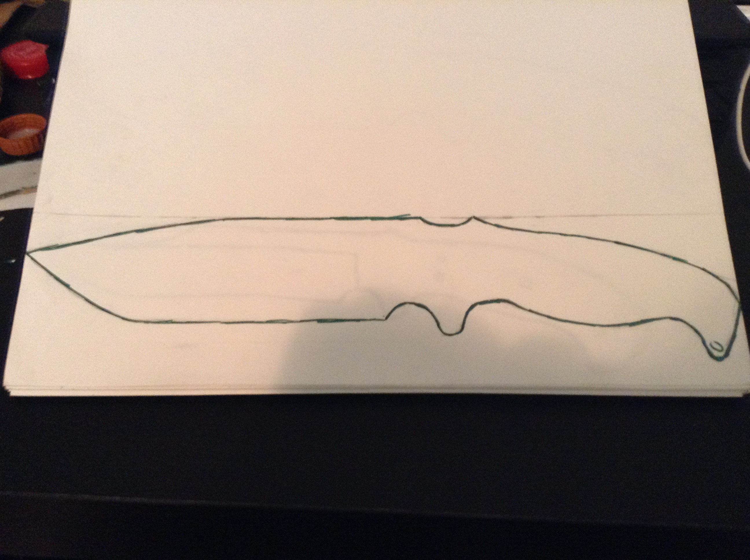

I really like the last one on top (in black) any suggestions??
I'll be ordering some 1084 on friday after I get my paycheck..
Ok, great. Drawings! Unless you have a specific need for a tanto type tip I would lean more towards a general purpose curve to the blade tip like your last two. What is going on with the top edges of your handles? Why so many bumps and dips? Your first and last drawings are the best in this regard but get rid of the bumps. Try to get a nice smooth flow in the line from the spine of the blade through the guard area and down the top of the handle. You tend to get the best flow in a knife design when the top and bottom of the ricasso area (part of the blade just in front of the guard) match the top and bottom of the forward area of the handle. Don't have a drop in the line from the spine of the blade down to the top of the handle. You don't really need a double guard unless the design is a fighting knife like a large bowie or a military type knife or even a hog knife. Avoid overly bent angles to your handles. A little curve is nice. A finger groove behind the guard isn't necessary but can be a nice addition visually and can aid in grip. Don't make it too pronounced or sharp though. Otherwise, you're off to a good start. Others will have more suggestions soon.
