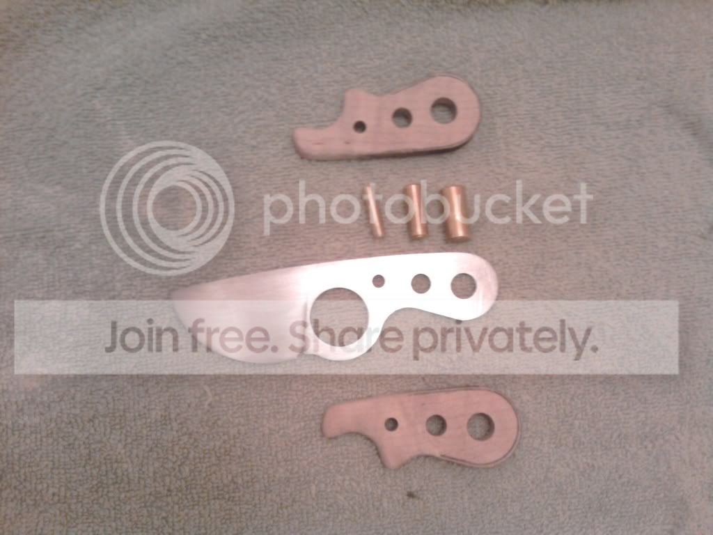

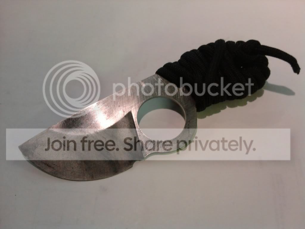

Well technically my first knife with paracord wrap broke due to me cutting the bevel too thin at the edge.
Here it is cut out, and with the initial bevel.
Here are the scales and rivets layed out.

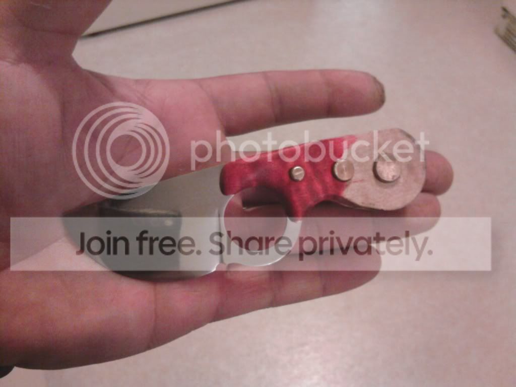

A nice way to remember making my first knife.
Ricasso fit check, and probably the best the blade looked finish wise.

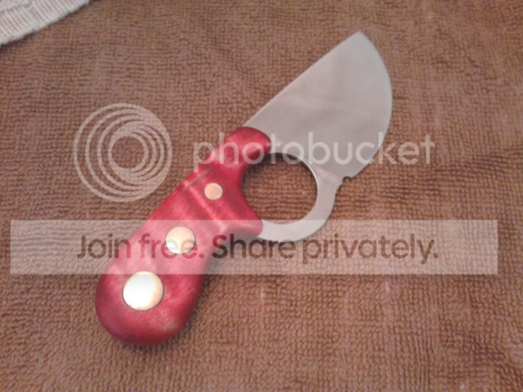

Finished and sharpened. Darn stone grit went and scratched up my pretty blade.
I attempted a CA finish, but found with the complicated shape of the scales I kept removing certain areas of the glue. Any help there would be great so I can get that fantastic look it adds.
Any thoughts comments are welcome.

The knife is looking good. I like the 3 different size pins.
What sort of heat treat did you do or did you send it out?

The material was spring Steel 1095 It comes at C53-C59. I had a few small pieces laying around, so I used them.

That is a nice job. The knife looks usable and well made.
Using stabilized wood for the scales will eliminate the need to use a super-glue finish. You can get it dyed and stabilized by WSSI, and it will buff up to a nice finish. Sand it to a fine grit and lightly buff on a clean linen buff with matchless white polish. It will shine and the burl/grain character of the wood can look like it is in 3-D.
