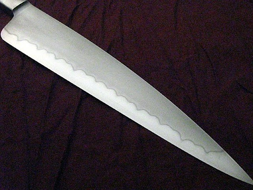

A customer wanted a 10-1/2" chef version of that hamon fighter I WIP'ed a while back. I obtained some W2 in 2-5/8" round from Don Hanson as I figured I'd need some pretty big stock to get a 2" blade width dropped right from the bolster. It took a few hours to forge, even with 100lb. and 50 lb. power hammers.
I like this steel a lot, it seems even easier to control than the W1 I've been using. I do see a carbide floating in suspension here and there and some alloy banding near the bolster... it's a thin blade, about .120 at the spine and 7 thou at the edge, and I think that helped the clay follow the pattern well, too.
This will be a working kitchen knife, so it got a "user hamon" at 800 grit. I'd like to try doing another big blade in W2 soon, with a full polish up to 2500 grit, pumice, etc.
Anyway, check it out...

Thanks guys, it's oil quenched. I though about trying water, but the blade was already thin enough that the pucker factor would have been HUGE. Guess I gotta grow a pair.
