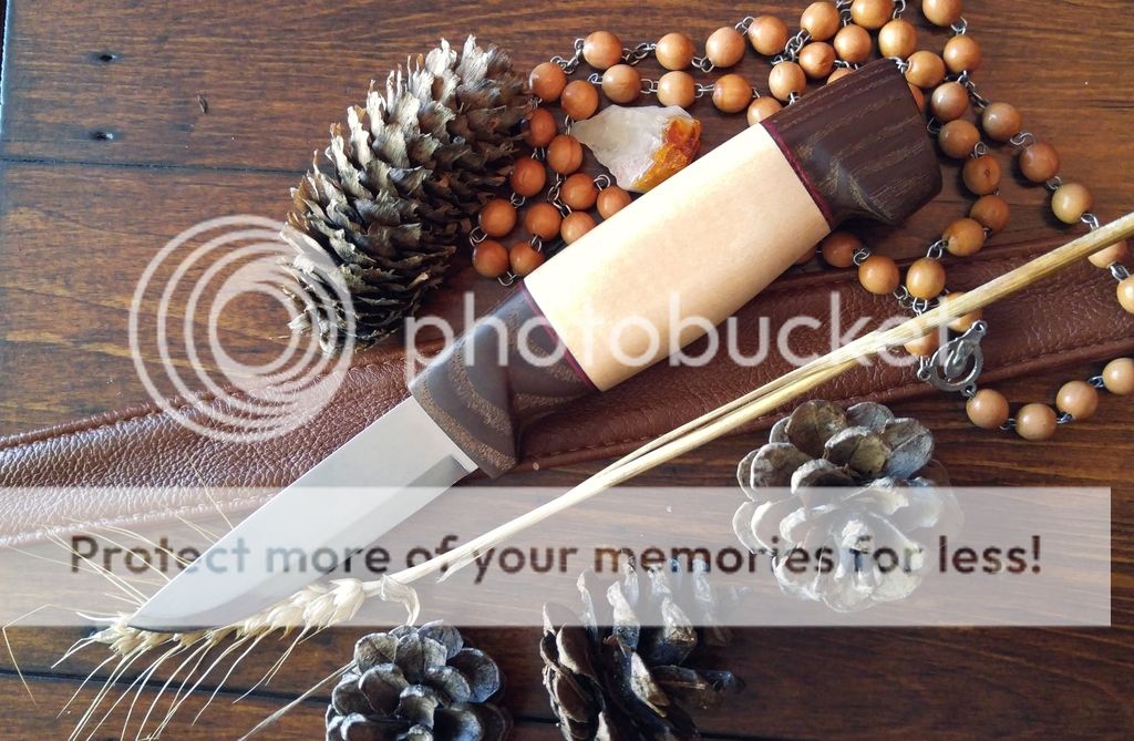

I just completed my first knife for a fun thing to do. It's a turd
But I had a ton of fun making it and got the bug.
I bought a helle blank and fashioned the handle from scrap baseboard and an old leather purse

That actually looks like a pretty useful shape to me - basically a puukko with a sculptured handle. If you really don't like it you can take it back to the grinder. Probably one you like in there somewhere. :)
Seriously - nice job on the finish. Good picture too.

The knife you made is OK, but the handle overpowers it a bit. Reduce the size a bit and it will look better.
