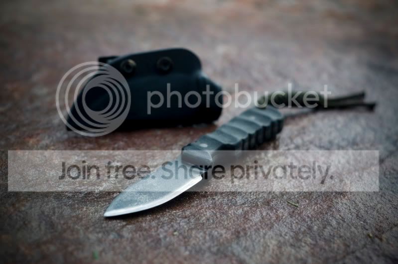

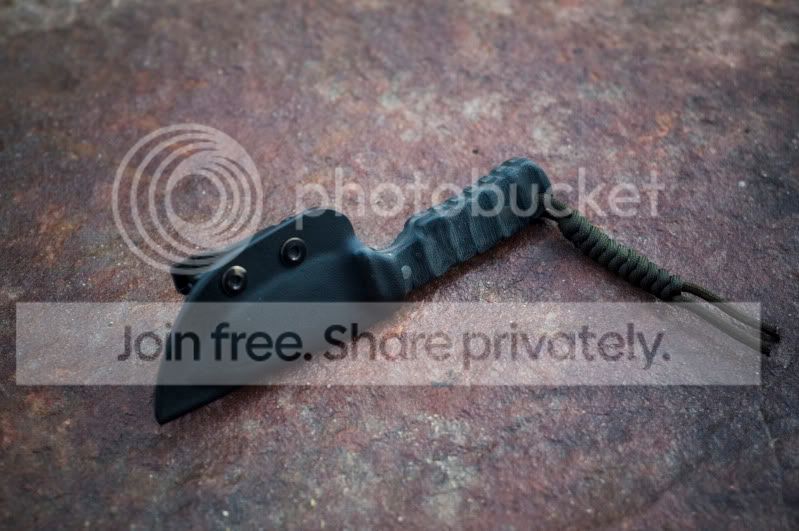

This is my first knife made out of a nicolson file, g10 handle, some metal rods from home depot for pins and a 17 HMR bullet casing for the lanyard tube, epoxied with devcon 2 ton. I did the aneal and HT myself just because i wanted to do it on my first blade. I will be sending the rest off for proper HT and will be using either O1 or 1095 from now on.
After being in Afghanistan the first time I carried a pocket knife and a large fixed blade. I realised that i ended up using my pocket knife 95% of the time. So my goal for this knife was a small fixed blade that i could fix to my belt or vest. something small enough to be handy but stout enough to take some abuse. I am looking forward to using this when I deploy back to Afghanistan. By the way I was 11B( infantry) but unit recently transitioned into a 19D (cav Scout) unit.

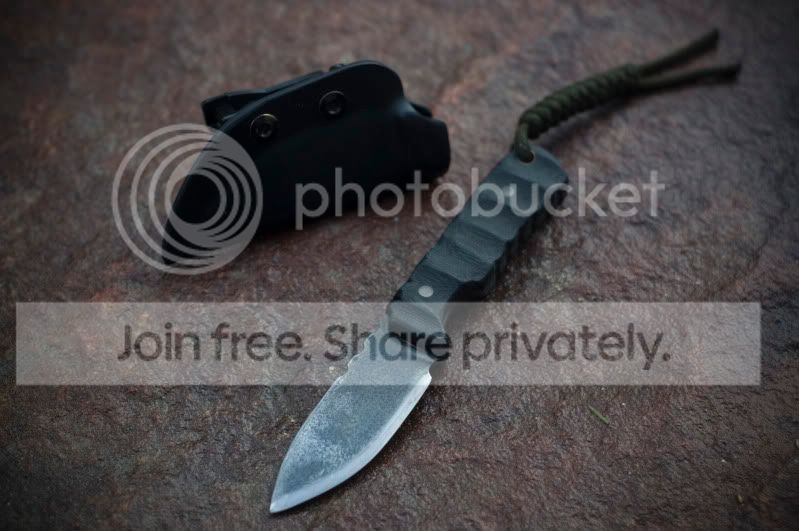

This is what i ended up with. I took a few ideas from some photos I have seen and combined them into an ideal knife for me.
About the knife. I didnt get the plunge line as pronounced as I wanted. I left the blade a little thick towards the edge and I had to make a secondary bevel to put the final edge on, not a big deal but it just hurt the appearence of the knife IMHO. So far on some testing i have done the knife has a decent balance on hardness and being able to be sharpened fairly easy. It holds an edge decent but it is very easy to sharpen. I think if somebody puts a really good edge on it that it will hold better(im not the best at sharpening knives).
Tools I used where very limited. I had a 4inch angle grinder with a 1/16 cut off wheel and a 1/4 abrasive wheel. I borrowed my dads 4" x 24" hand held belt sander and set it upside down and used that for most of the flat grind(that is why my plunge line ended up tapered). The belts I had was a 120 grit and a 40 grit. Then I had a round file a double cut bastard and a triangular and a chainsaw file. It took me around 8 hours to complete and im still not happy with the edge and bevel.
I just want to thank everybody on this site for all the help and info I have been gathering over the last two weeks I couldnt have done this without you guys. This is the first of many!!!
Please feel free to ask questions and give me some constructive critisizm also. Thanks.
