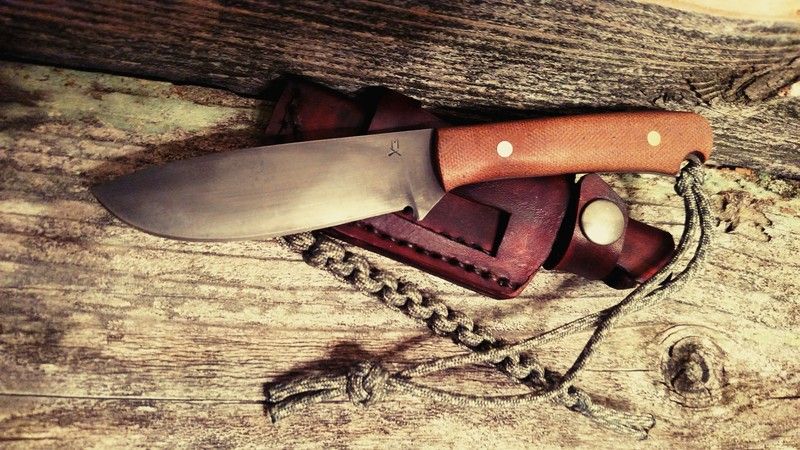

After the file knife and alot of research I picked up some 1095, a Craftsman 2x42 and a variety of handle materials and got to work on a very ambitious Christmas gift project. I made 5 knives to give away trying to think about what each person could use most and going from there. All blades are 1/8" 1095. I can get more specific measurements if needed and update later.

I then made two hiking/hunting/camping knives for my Brother in Law's. Both are roughly 4" blades, one with Ironwood and the other with brown Micarta

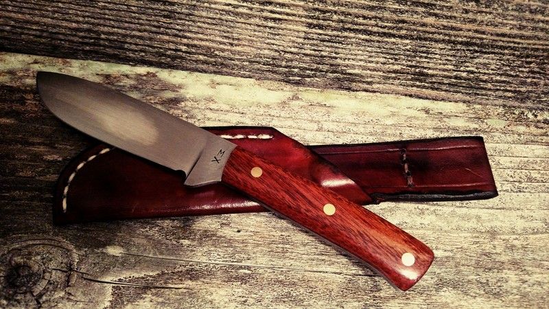

I also put together a similar sized knife but with a little different twist for another Bro in law. He uses this one in the kitchen alot from what Ive been told. Bloodwood handle. I like the simple sheath I made for this one too.

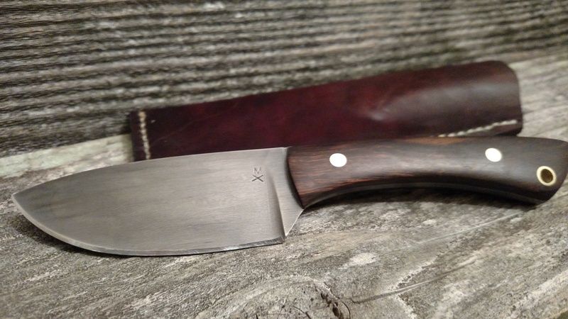

This was also supposed to be my own personal EDC knife but I sent it to a good buddy instead. 3" blade, Ironwood handles and a pocket sheath.

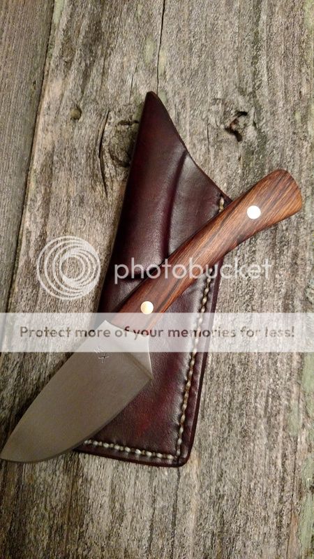

3" blade with a 3 finger grip to try and make a more compact knife. Zebrawood for the handle and a new pocket style sheath I was trying out.

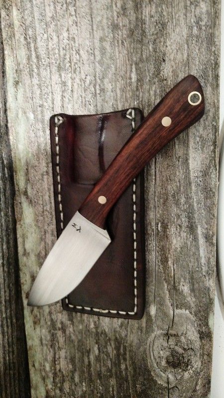

Same length as the Zebrawood knife but with a 2.5" blade and a full grip. I like this alot better for some reason. Ironwood handles and similar sheath.

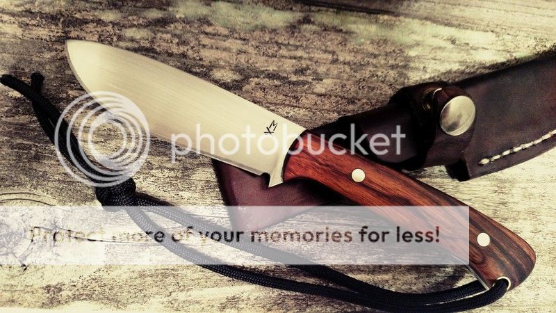

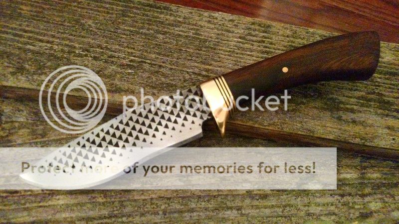

I just finished this Bowie style knife for my Wife's Aunt and Uncle. They own and ride horses so I thought ide try to tackle a knife that they can carry and use while riding. Made from a farrier's rasp, I free handed the design and then tweaked it a I went. Brass guard and spacers with Ironwood handles. I love how it turned out and couldnt be happier. I DID forget to stamp my mark before heat treating and decided not to try it after so there is that, but otherwise I like it alot.
This is a first of many kinds and probably wont be the last. First Bowie/hunter style knife with guard and spacers. First hidden tang, first time (successfully) making a butterfly sheath and doing the basketweave stamp. Challenging yet very very rewarding!

I stink at getting good pics but here is one with better lighting. Im gonna have to build one of the budget light box setups or something!

Thanks! I really enjoyed that knife and hope to make many more. Im not 100% happy with how wide looking the final grind is but I left it thick for heat treating and may have left it a little too thick. Live and learn. Each knife I make is my new favorite as I learn more tricks along the way and things get easier and easier.
Matt
I'm assuming you were having trouble removing a lot of material, the trick is to basically detemper a file by heating it for a long time and let it slowly come down in temperate. Most people throw them in a fire over night then retrieve them in the morning and start working them. If I could find my first file knife if post it, came out cool but took what felt like a million belts on my 2x42
No actually I did all that and had no trouble removing material but I left the blade a little thicker than normal because I didnt want to risk any issues during heat treat and also I had hit my mark for my grind lines and was really pleased with how consistent they were side to side so I didnt want to risk ruining a good thing. Next time Ill try a little different angle on the grinder and see if it doesnt help make for a thinner cutting edge and less work getting that final edge.
