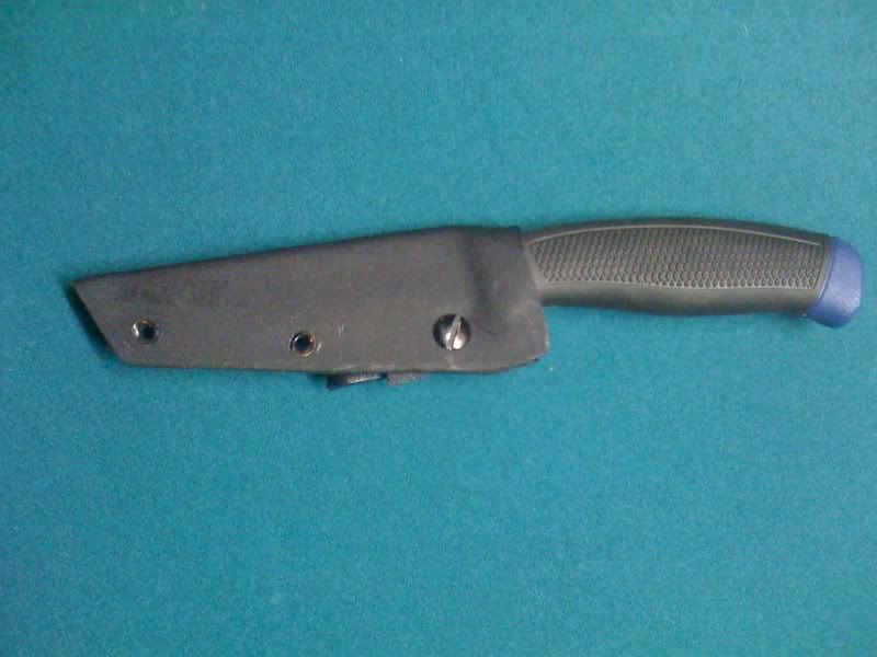

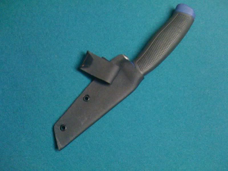

First kydex sheath. Ugly but functional
May 12, 2007
355
I scratched the sides with my Dremel tool, I still need to file off some loose edges, the rivets are all botched but staying in, and the improvised J-hook needs to be remade first thing tomorrow...But for now, it's carry-able, and intact. Behold, my first low-budget, DVD taught Mora Clipper sheath.
http://img.photobucket.com/albums/v390/chicagonighthawk/IMG_0092-1.jpg
http://img.photobucket.com/albums/v390/chicagonighthawk/IMG_0093.jpg
First goal is figure out where I went wrong with the eyelets, need to practice with my new Dremel, and then finer fit and finish. Not sure what I'll do next, probably another smaller fixed blade as I accumulate the things in all sizes.

Hmmm. Try using a block of wood with a piece of leather (an old belt, boot, whatever) on top in place of the anvil. Alternatively, if you've got a nail that fits perfectly inside the eyelet, shove it through the leather and cut it down to just a nub, so it holds the eyelet in place.
That rivet setter is crap. I've had better luck with ball bearings and a ball peen hammer. Get creative and take your time. If you're just doing a couple for knives you have, you can make it work. Eventually, I had to order a real set of dies. I figure they'll pay for themselves in saved time and rivets.

I'm not using the dies, which I'm told are spectacular, but the hand-setter chisel-style punch you tap with a hammer. Generally the rivet just flares down normally for a few taps, then veers off to one side or splits as the punch seems to be sized wrong. I end up with one side of ugly flattened rivet that just hangs on, and the normal side. The anvil that came with it doesn't hold onto the eyelet whatsoever, ruined three of them, all it does it make the thing dance around as the depression is for a larger eyelet. I'm using .08 kydex and #8 rivets, this setter is supposedly the #8 model but looks like it's for a larger set.

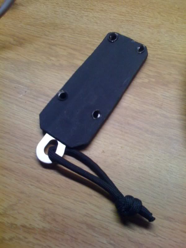

Still working on my eyelets and have since replaced the ones seen in the first sheath and this other one, but here is some newer work of mine.
Buck Smidgen pancake sheath, may scrap this to make a foldover that's half the size.

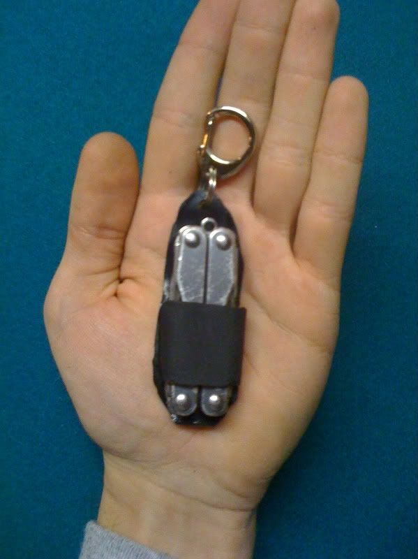

Courtesy of the heat gun my other half got me this morning, my Leatherman Wave holster. Will not shake loose, impressed at how well the pattern worked out.

Had a little square left over, and I was that bored...so here is a twist on the previous pattern, one tenth scale on my Leatherman Squirt.
http://img.photobucket.com/albums/v390/chicagonighthawk/IMG_0107.jpg

Your having fun aren't you. :D I think the next thing I'm going to make with some of my smaller scraps is battery holders. If you haven't bought rivet dies yet, it's the way to go. For around $35 dollars it will save a lot of time and destroyed rivets. I'm using my dies in a drill press but I'm sure you could either hammer them or rig up a c-clamp or something if you don't have a press.
