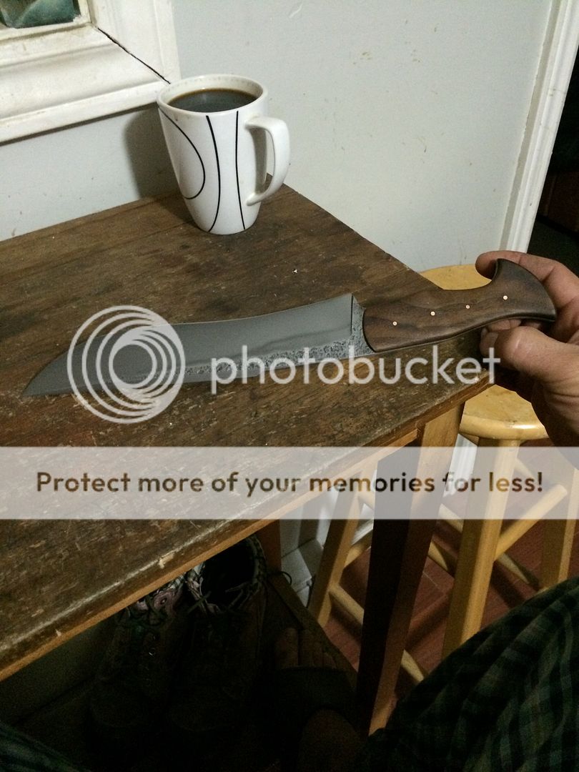

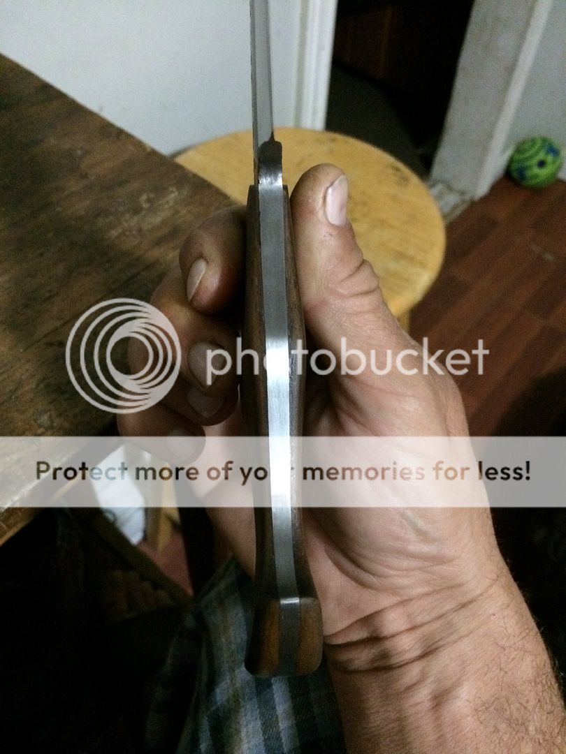

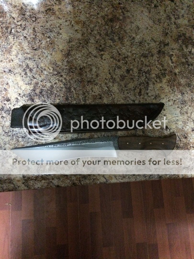

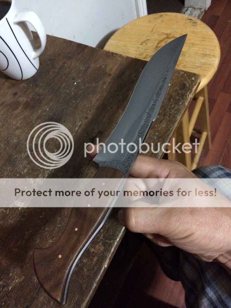

Hi guys. Here is my first large full tang finished up last week and my first attempt at a leather sheath, just dry this morning.
Knife is 5160, differential hardened
9" tip to scales
14 1/4" OAL
Shallow distal taper, tapered tang
Walnut scales, copper pins
Blade etched to show hardening line
Sheath is 8-9oz veg tan, textured, wet formed around the handle and treated with birch tar.
Comments and critiques are appreciated!
