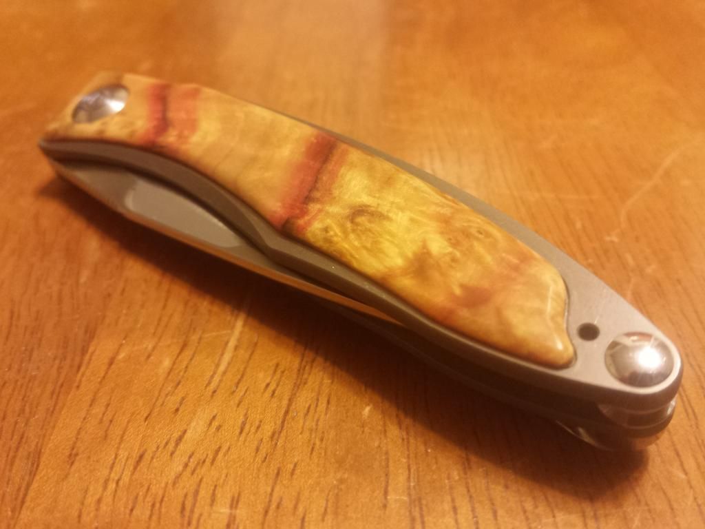

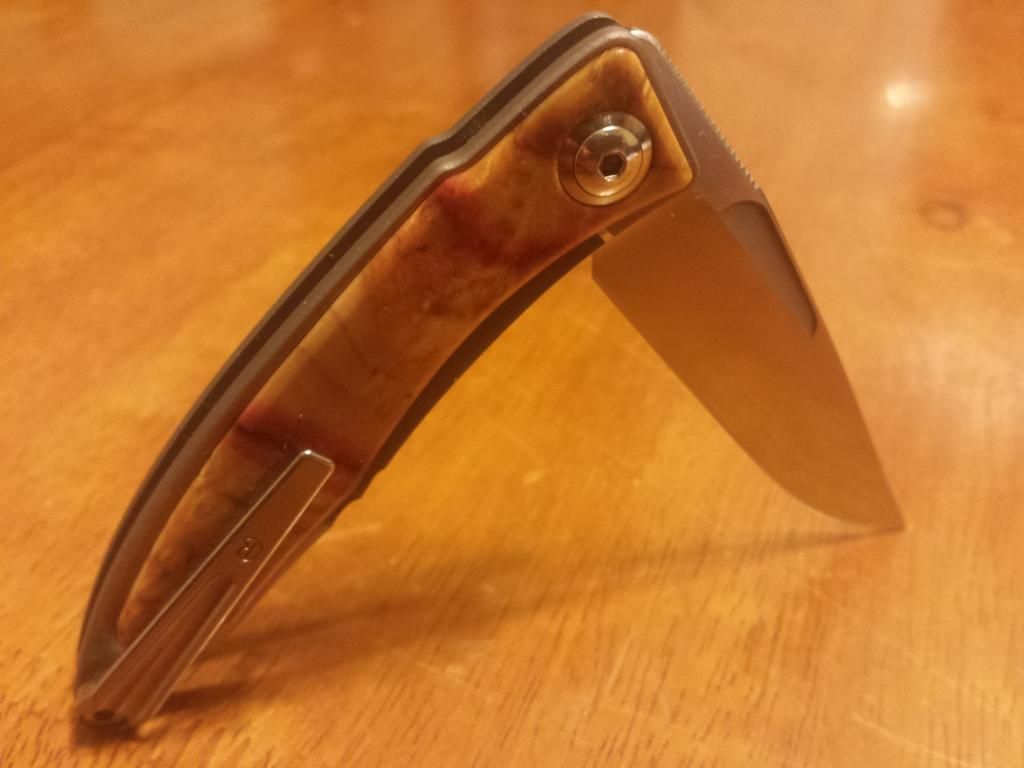

Hi Guys, I just got my first Mnandi, and old-style nail nick, pivot, and pocket clip. I got if off the exchange, and the seller has a great feedback rating, and it came with a box, birthcard, and leather pouch, so I'm not really concerned that it's fake. I just have a few questions. The birthcard says S30V made in 2009, the washers are solid, not perforated, and the blade has an S, which seems fine. But there is no date code on the inside of the slabs, as there is on most Sebenzas. Did they not do that with Mnandi's?
The non-visible portions of the pivot are anodized blue, which seems weird, but I'm guessing they anodize the whole thing, then polish the face, and that's how they achieve the blue lettering on the pivot head.
The lockup is about 70-80%, which seems fine. There is zero back and forth play, but there is some lateral play. I cleaned and reassembled it, and the play is still there, but it doesn't look like the washers have been polished down at all (I would assume that side to side play would be caused by the pivot bushing being slightly too wide for the washers/blade stackup). If I polish the bushing down a hair, should that solve the side to side play?
It has beautiful box elder inlays with streaks of black and red. How do I care for the wood? Is it very susceptible to moisture? If I wanted to get more of a shine off it, could I buff it with some sort of polishing compound?
Here's some really mediocre pictures (unfortunately, this is the best that my photo skills are capable of).
No date markings on the inside that I am aware of. I am actually awaiting a response from CRK about the Mnandi and will post it to the timeline when I hear back from them. Some people wax the woods and mammoth. I have inlays and have never done such. The wax is mentioned in my CRK timeline when talking about mammoth. As for blade play, send it to CRK for spa/service and they will take care of it. Original Mnandi washera were not perforated either.
This is a nice Mnandi, I was pondering it when on the exchange, but ended up getting another.
You have nice colors on your scales! Since your other questions have been answered, I will just chime in about the polishing scales. I use wax (regular car wax) and it works great for me. The wood scales on a CRK are pretty durable, I have some wood scaled knives (sebenza) that are 15 years old now and they still look great.

Nice bit of box elder burl! My Mnandi had some side to side play in it too. But I fixed it.

I picked up some 600 and 1500 grit sandpaper today, and using a mirror and some formax green compound that I have, I took a couple thousandths off the pivot bushing and polished the PB washers. The play is gone, and the action is smooth. I don't think I managed to mess anything up. Now that everything is tight, smooth, and sans-play, I can appreciate it a little better.
It's definitely not just a smaller Sebenza (someday maybe I'll get my hands on an Umfaan). It doesn't have the rock-solid confidence-inspiring feel of the Sebenza. Not that there's play (anymore), but it does feel a little flexier. Obviously the much thinner ti slabs and blade stock aren't going to provide the same stiffness as the Small Sebenza. I definitely intend to use this knife, but I feel like I'll only be comfortable using it in 'civilized' circumstances. I think it's because I feel like I have to baby the wood inlays.
