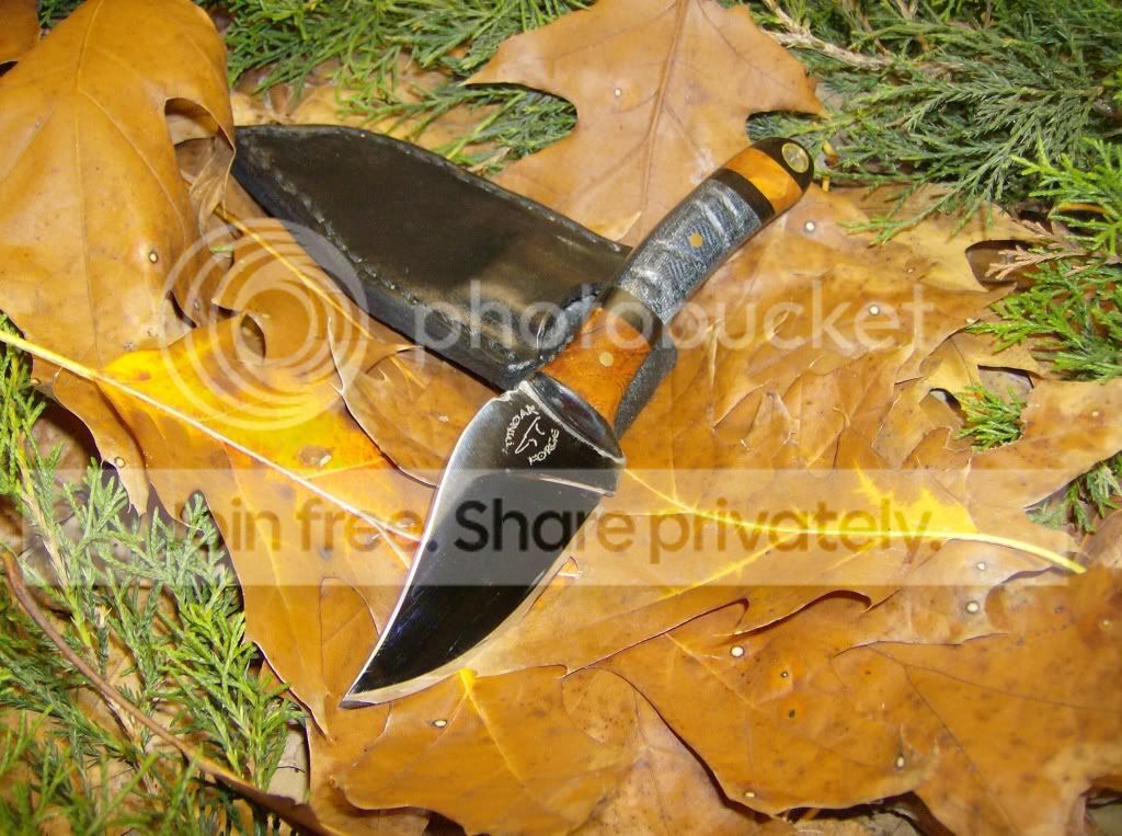

I would appreaciate some feed back on some of my latest work, a set of skinning knives. I just loaded my first few pics onto photobucket and have the link to them but am unsure how to post them here. I hope this works.

#1 is Hand forged 1095HC full tang blade, Gaboon ebony and cherry burl join with custom denium composit to make up the handle.

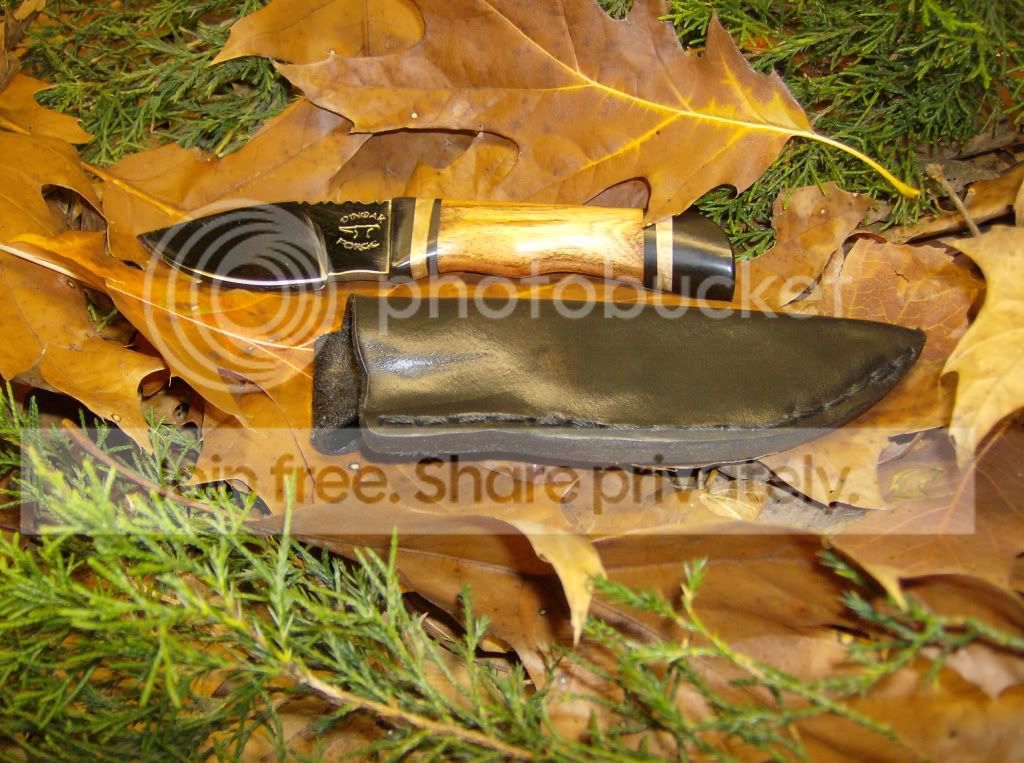

#2 is Hand forged 1095HC full tang blade, Cherry burl and Gaboon ebony highlights with curly maple accents make up the handle.

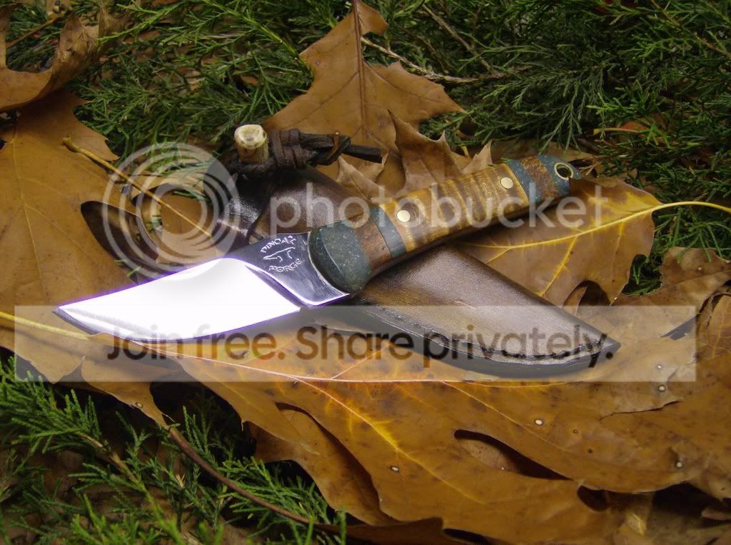

#3 is Hand forged 4" 1095HC full tang blade, green corian and maple burl highlights the tiger-maple handle, bronze pins.

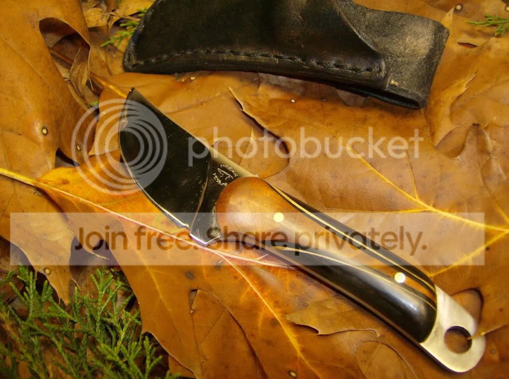

#4 is Drop point skinner, Hand forged 1095HC hidden tang blade, file worked back of the blade, Gaboon ebony and maple highlights with hack-berry body form the sculpted handle.
I like 'em all. They look like they will be good skinners. The grind line/ridge by the ricasso is nice and graceful. The finish on the steel looks like you've gone beyond 600 grit. Am I seeing excess glue at the seams between handle and blade in the ricasso area or is that tallow from skinning out deer?
#1 Just a personal thing, to me the fabric type composite handle material doesn't seem to go so well with the wood used in front of and in back of it. Maybe if it were a different color that blended better??? or another piece of that pretty golden wood. What is that gold wood?
#2 I LOVE the handle. Please explain how you put the different woods together. I notice that they are not just flat layers but curve. What woods are put together here?
#3 Do you have anything holding the different segments together? There are pins or bolts (??) holding the main wood of the handle on, and the thong tube holding the pommel end on. What's holding the other segments on, especially the first one (bolster)?
#4 My favorite. The blend of wood horn (or bone) and shape of handle and blade come together well.

If I was still hunting the last one would be my choice. I always liked a short/fat and razor sharp blade for skinning. Mostly to keep a needle point away from my other hand working the hide. They all look good though.

the "gold wood" is actually some cherry harvested a few years ago here in Kentucky, it has a nice figure and an interesting color.
the woods in #2 are Gabon ebony, maple and some of that cherry mentioned earlier. to make that handle i first made a billet with the curves cut in with a coping saw then laid in the accent strips, 1 ebony the other maple. then scribed the curves into the ebony and cut them to fit. i used a good waterproof wood glue that i got from a furniture builder. i then covered the surfaces with it and clamped them up using quiet a lot of pressure and allowed the billet to dry for a couple days. the joint turned out to be stronger than the woods themselves. i then cut the billet like i would for any other handle. pretty much the same process for #3.
