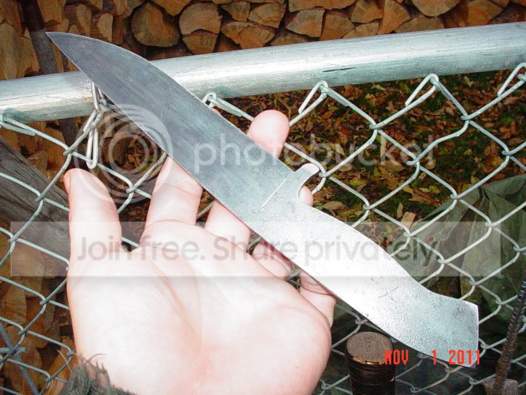

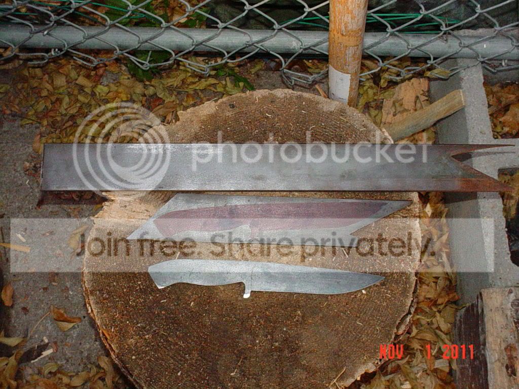

Thanks for the info, I just got a few things left to finish up before I start on the edge. I got my hands on an engraving tool that should do the trick of making a line down the center. I also just got some pics, kind of a steps i have taken it so far.
the blade "blank"?
Its going to have about a 6" blade, 4.5" handle area, for about 10.5" over all. So far it has been done mostly by hand, only tools I have had to work with are a 4" angle grinder and hand files. At this point I'm really not sure what I'm going to do for slabs.
Thanks again for the help, and any more that comes my way will be appreciated.
