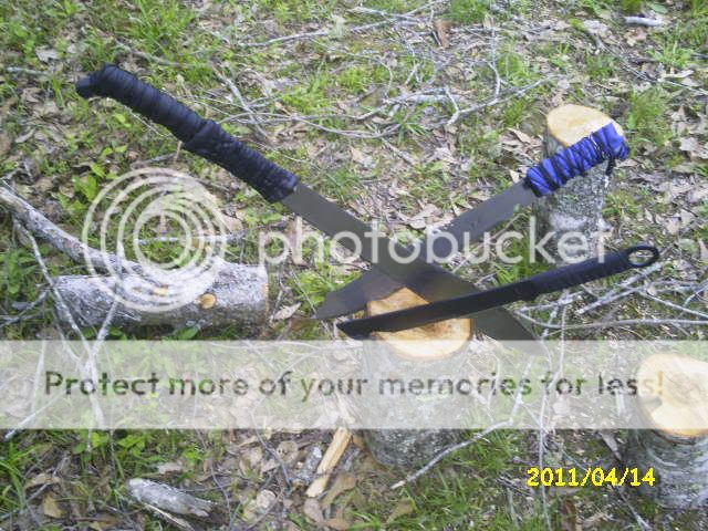

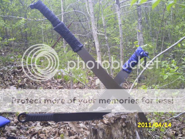

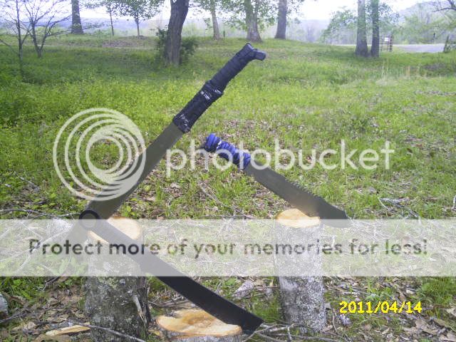

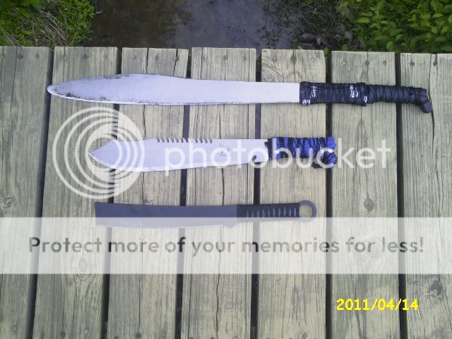

27 inch Imacasa Colima
15.5 inch Hansa/Yegua Bush (Rambo)
11 inch Grey Eagle Coping
16 inch Cane (cheap WalMart brand) (Not Pictured)
My uses, "mods", and plans...
Colima: Two-Handed Conversion, home made sheath...
For clearing large areas of extra thick brush, vines, and light trees (up to 2 inches, 4 inches with effort)
Future Modifications: hook (like on a cane knife) at the base of the curve for pulling vines
The double hand extension is good for when a single arm gets fatigued from hours of clearing, and good for choking one hand up on the blade for more control
Rambo: Sharpened saw teeth, padded handle, home made sheath...
For packing, clearing trails, chopping/sawing firewood (up to 2 inches, 4 inches with effort), includes can-opener
Coping: For light packing, clearing nuisance limbs (up to 1 inch)
Cane: Hook for tearing vines out of the way
For clearing overgrown fences and small areas of brush, vines, and light trees
Reviews...
Colima: swings easy and accurate. no need to bend down to reach low cuts. reaches deep into vine bundles, and far enough to minimize brush "fighting back"
I cleared half an acre of intensely thick growth in about one days-worth of work. Only thick trees were left standing. The entire area was impassible beforehand.
Rambo: Very wieldy. Hard chops can rattle your hand, so I had to pad the handle. Saw teeth were barely effective before sharpening. Highest quality of metal out of all of my machetes.
Coping: Very handy size, and comes with nice sheath. It doesn't hit as hard as I had hoped, and the metal seems a bit weak. Still, i like this one a lot. Just know it's limitations and don't try to exceed them and it will be very handy.
Cane: Chops much better than expected for a cheap department store machete. It can take on much more than cane. I cleared an acre with this one, though you can tell that it was a bit beyond what it was meant to do. I cut some nice trails with this one, through solid walls of growth, but I think it's place will be clearing overgrown fences from now on. The hook is very handy for stubborn vines.
