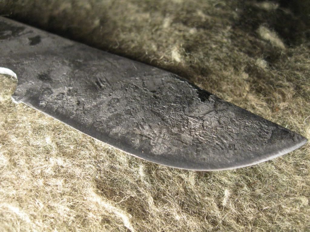

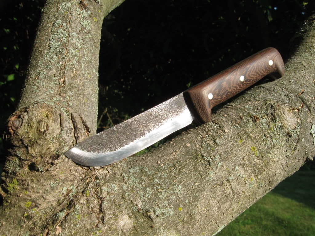

This is the second knife that I made:
Also a forged blade but this one is 5160
Made from an old leaf spring out of a superlift lift kit
The scales are made from a wood that I found while camping
I cold forged this one at some point on accident and formed a weak spot. It cracked under heavy use.

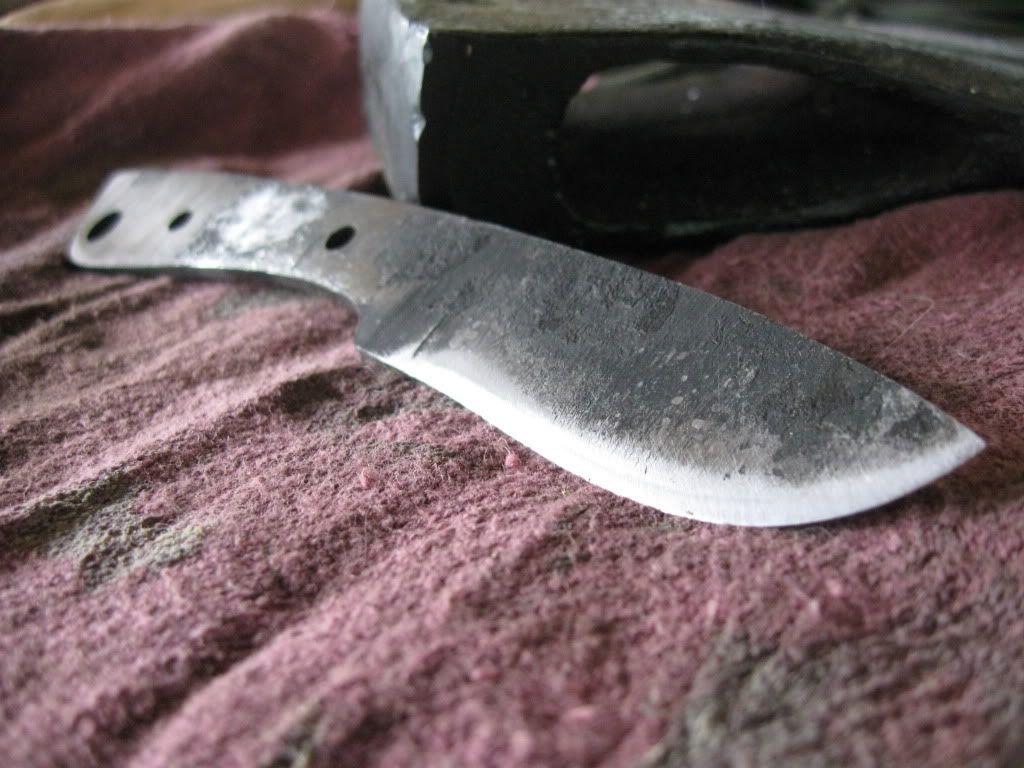

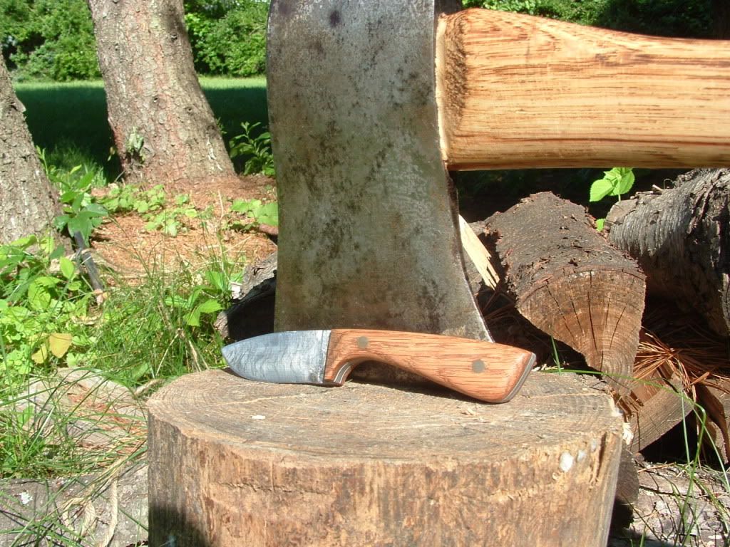

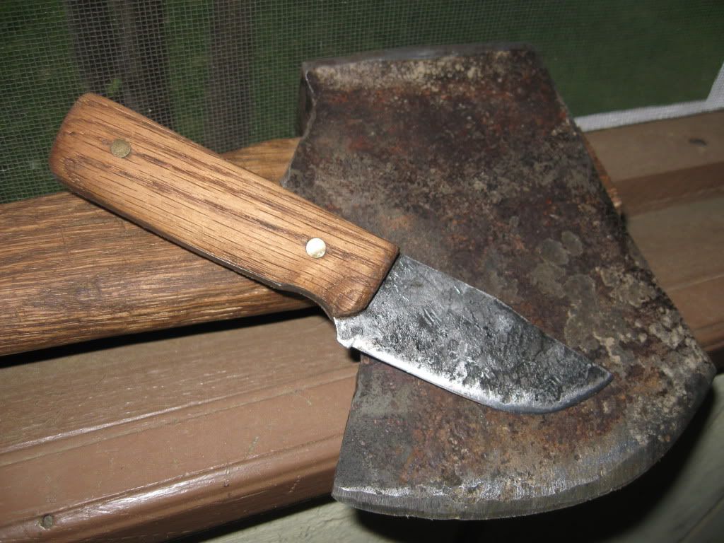

This is my third knife:
First time using the stock removal method
Made from O1 steel, 1/8" thick
For size comparison: that is a 3 1/2 lb axe that it is leanind against

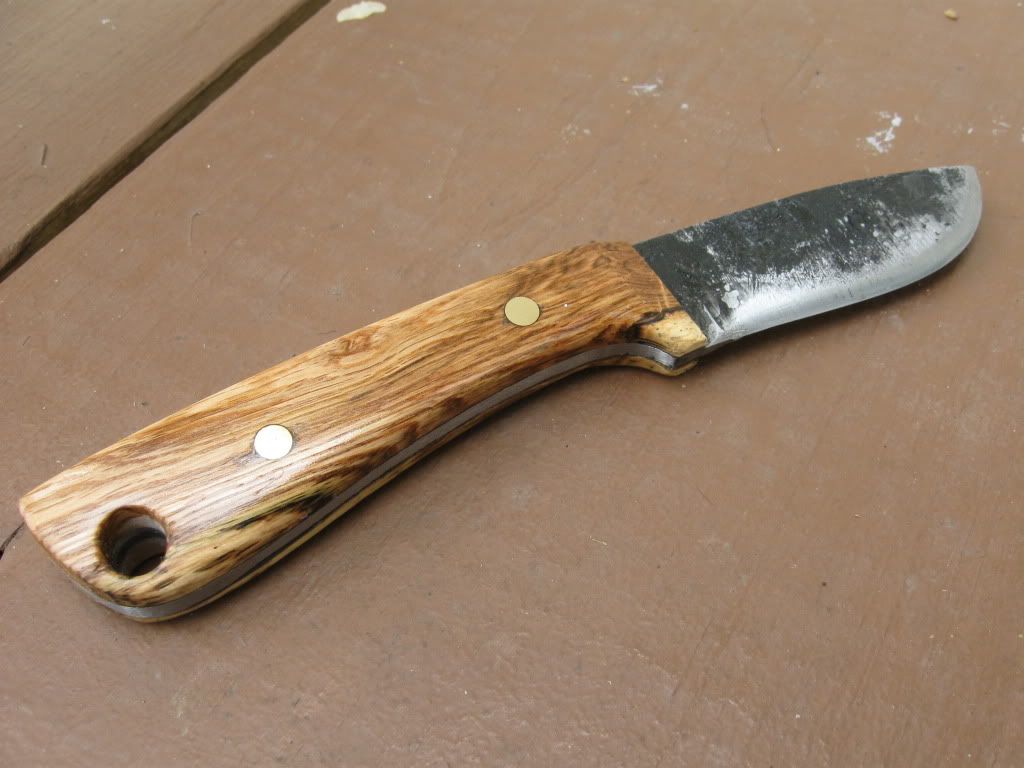

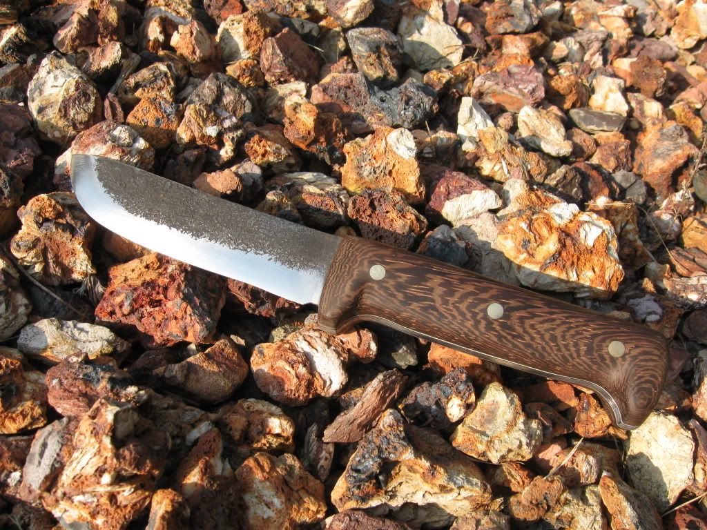

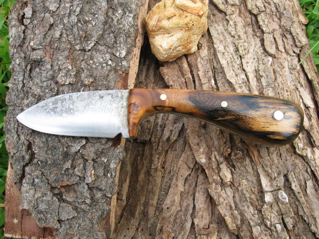

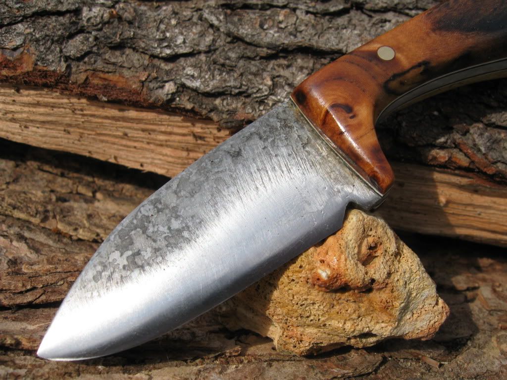

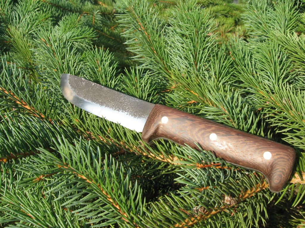

This is my latest knife:
I finished it today. Also a stock removal knife made of 1/8" O1
4" blade
1/8" thick O1 steel
Black and White spacers
Wenge scales
3/16" brass pins
8 1/4" OAL
Convex scandi - If ya know what I mean...
Thanks again! Let me know what ya think?

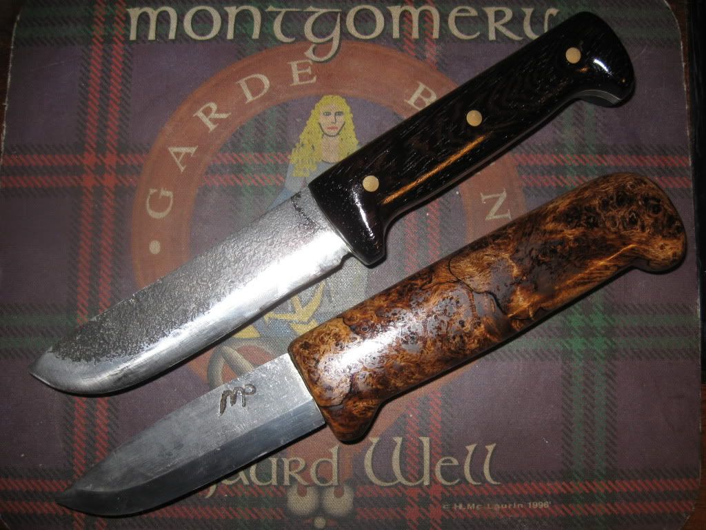

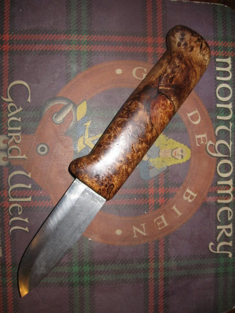

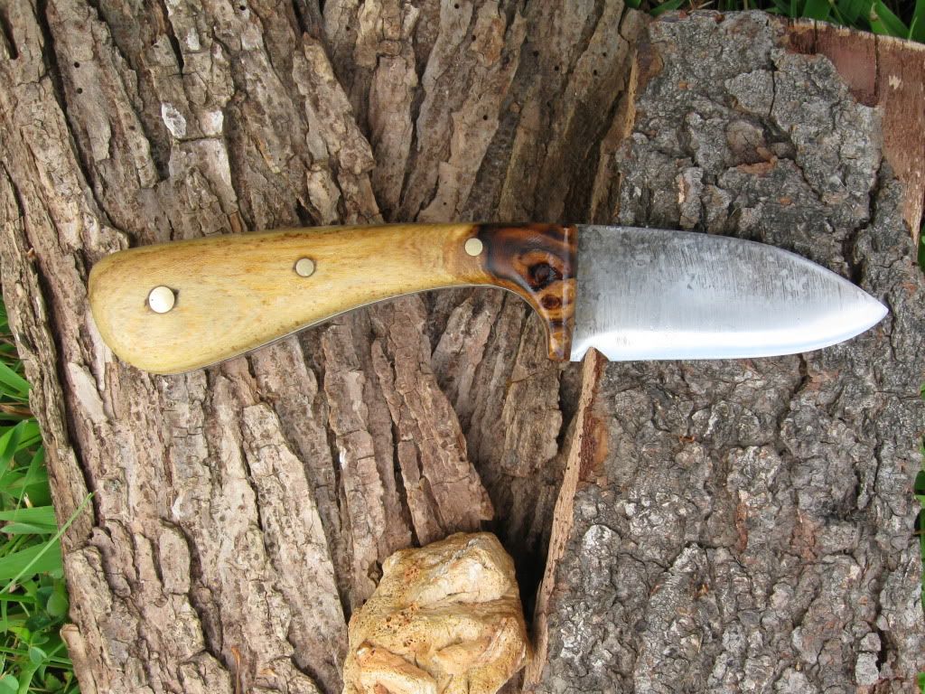

Scandinavian grind, hidden tang, 3" blade, 1/8 O1 tool steel, Spalted Maple Burlwood, differential heat treatment

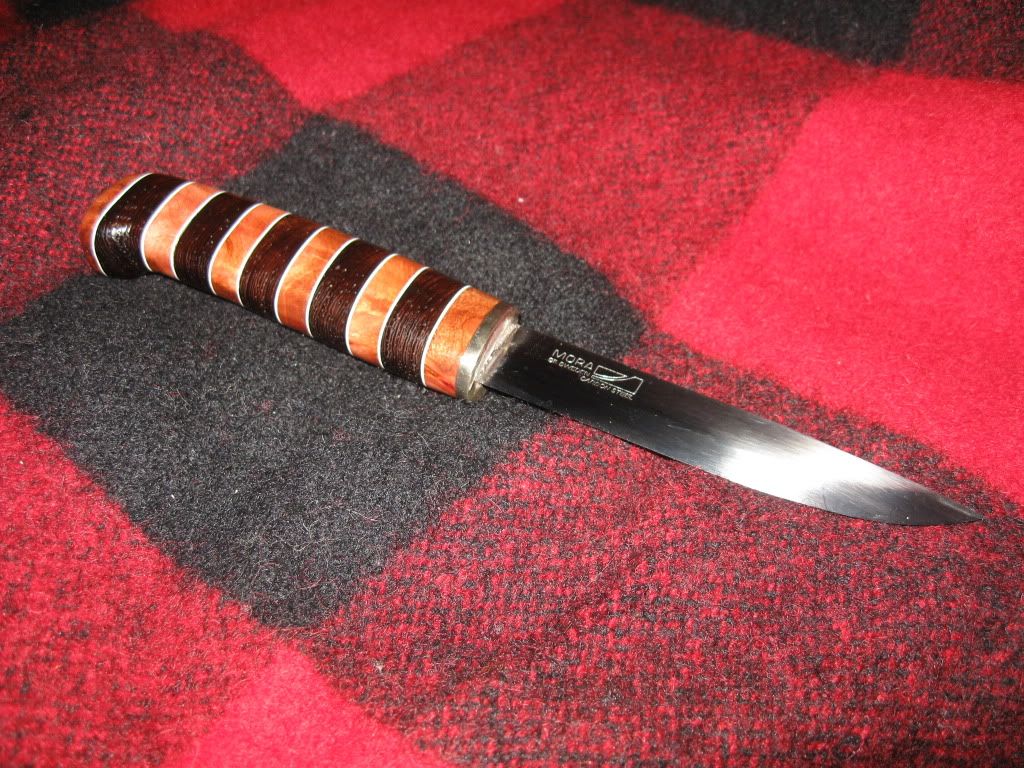

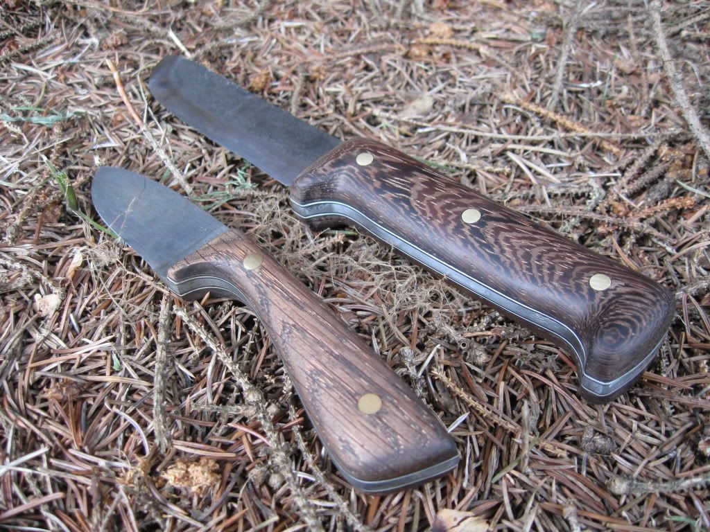

Mora 1 Carbon blade
Stacked madrone burl and Wenge with white spacers.

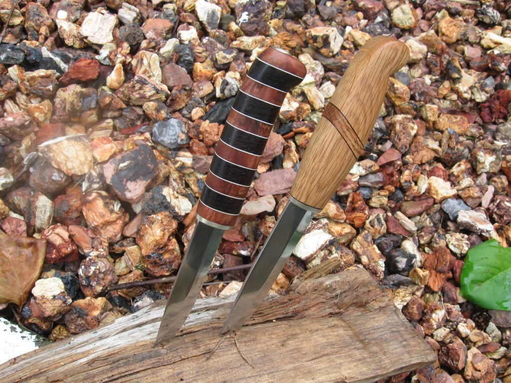

Mora 2 carbon blade

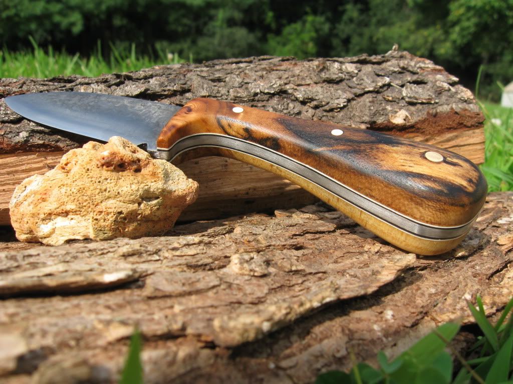

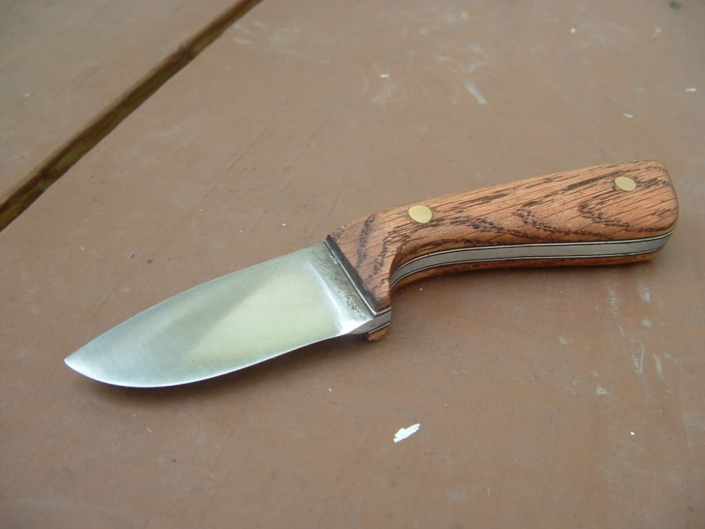

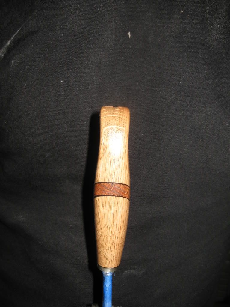

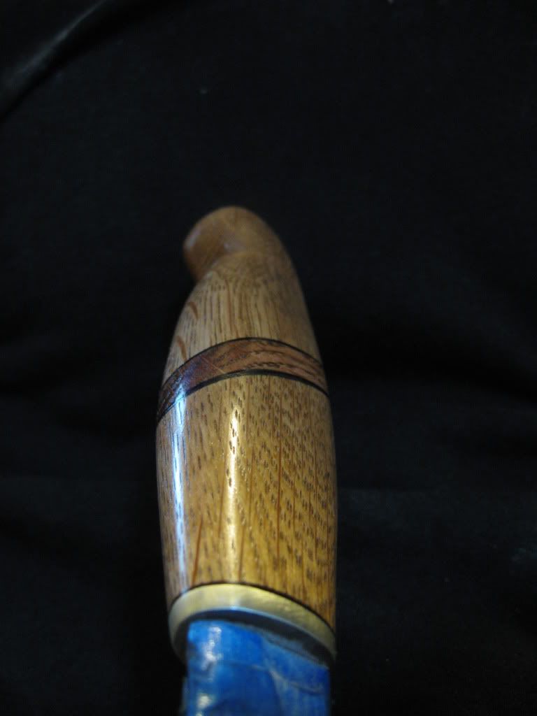

White Oak with a Red Oak strip.

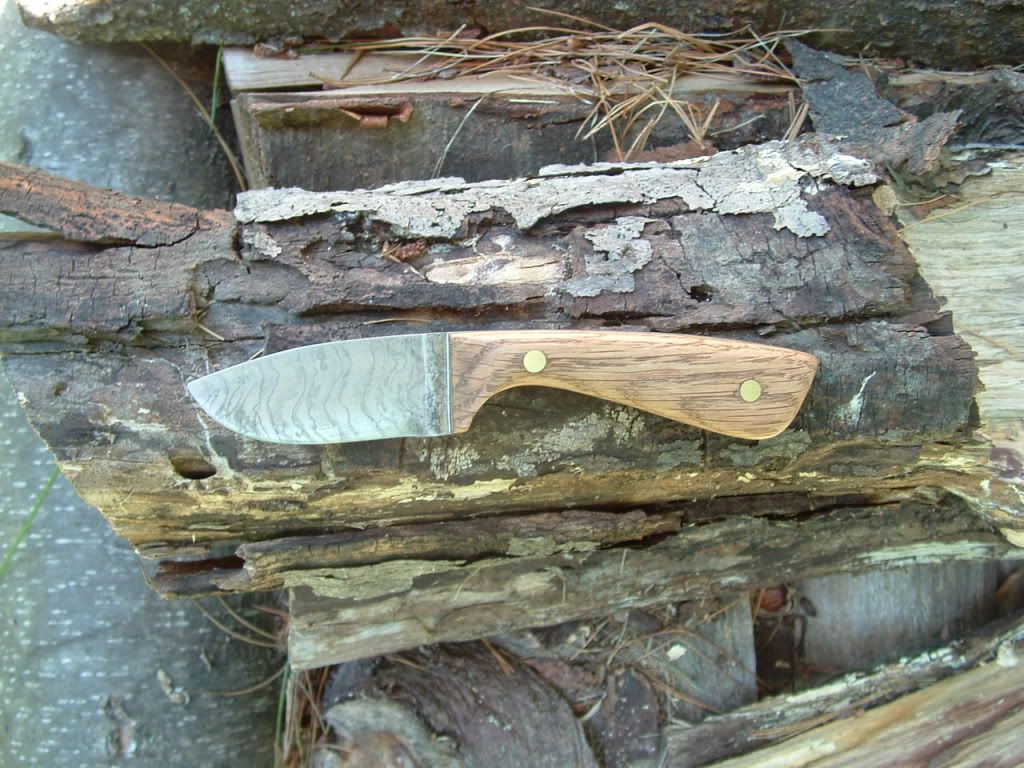

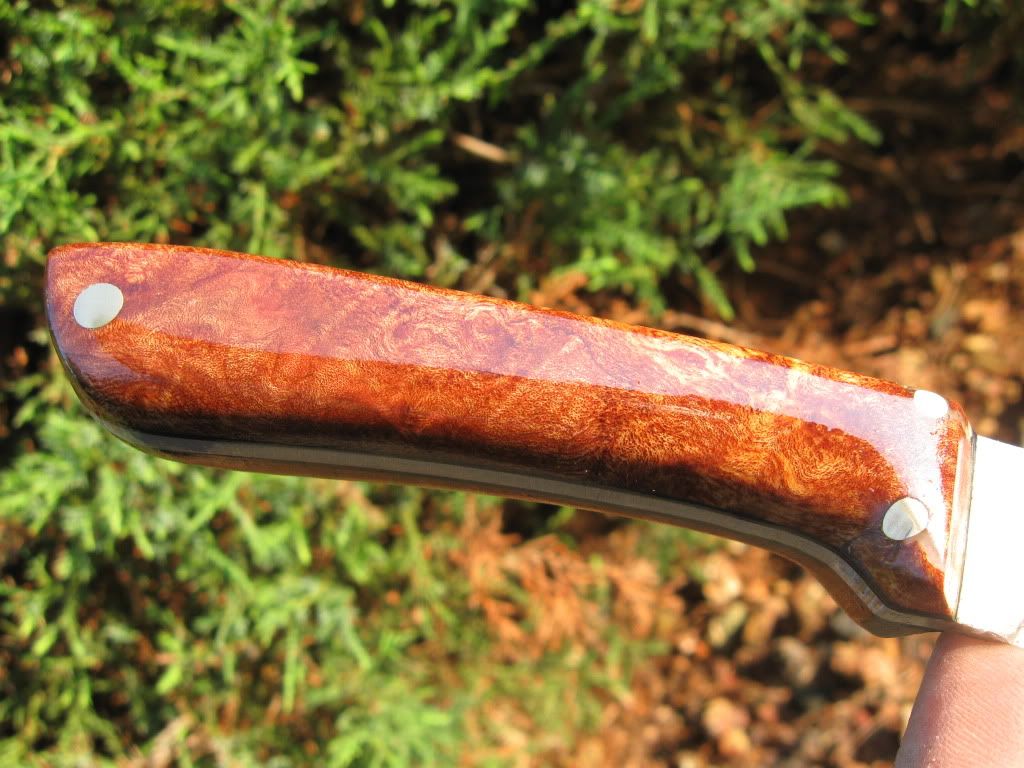

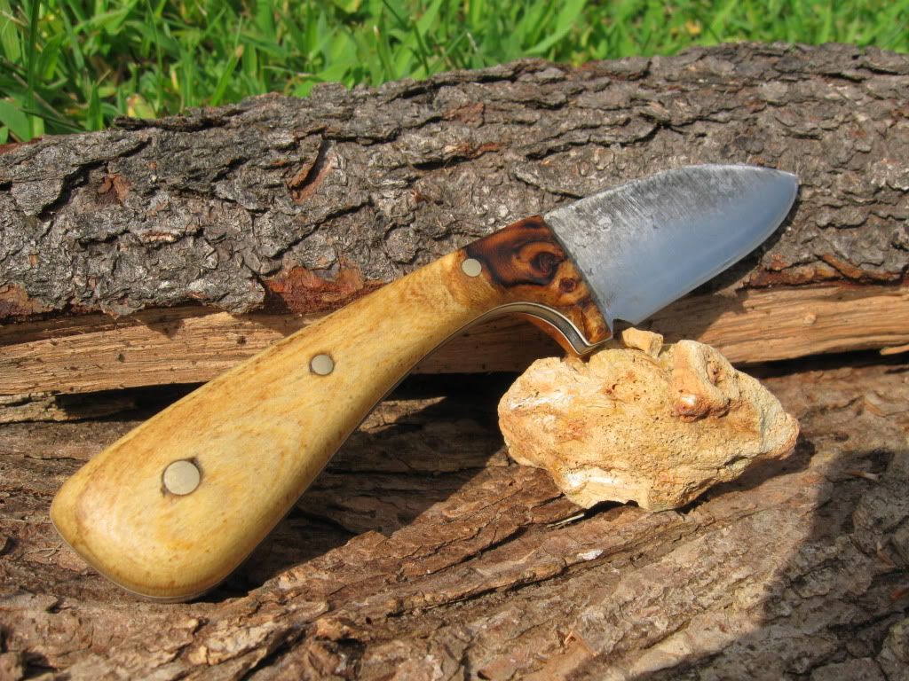

A small Skinner with madrone burl and brass pins
It is O1 steel, 1/8 thick, spalted American elm
