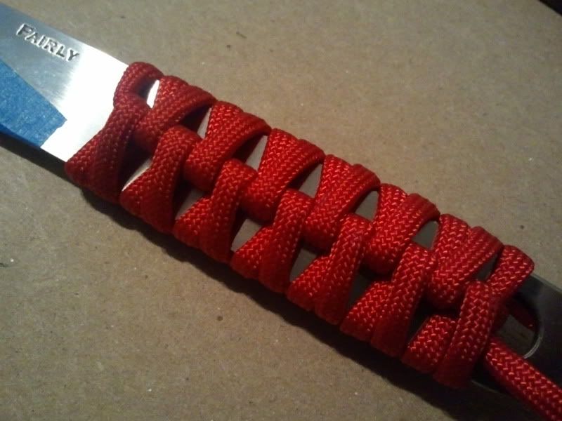

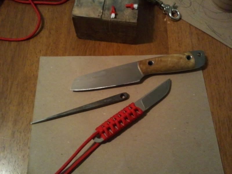

Well I wanted to make a lanyard for my spike and rigger first, but I got to thinking and decided to do a cord wrap handle on my DFK Tanto! The spike excelled at its job, proving to be the perfect size and a very comfortable shape in hand. Drawing up the wraps tighter with the spike was easy and smooth.
I also made sure that all my DFK's got used for this! Check it out...

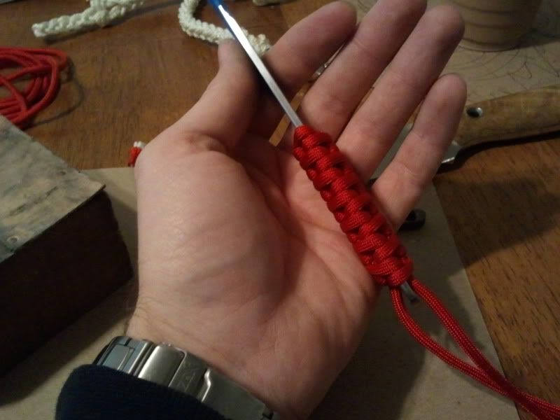

I don't know if this wrap style has a name, or is even used very often. It is one continuous piece of 550 cord, fed through the thong hole and doubled up towards the tip, then each working end is zig-zaged back and forth over the spine and looped under the standing runs along the tang. Fill the tang with wraps and then draw tight evenly in successive steps to keep the loops centered in the tang.
It fills the hand nicely, is very secure and I will likely epoxy soak it for permanance. I also made sure to use all my DFK's in this little project, only seemed right!
-Xander

Thanx guys! I've been thinking that a 5 strand button knot on the end of the spike would be cool, I'll just have to use a different spike to draw it up.
