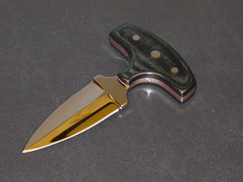

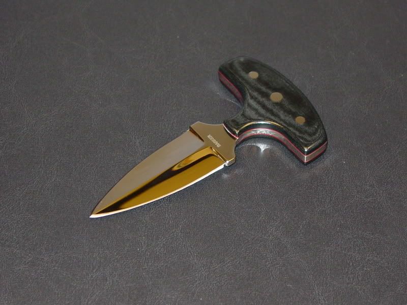

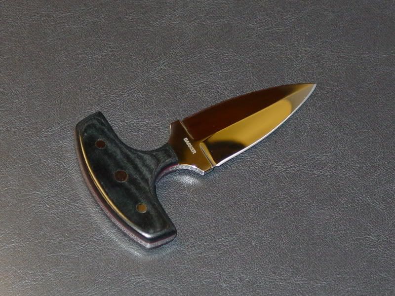

A fellow JD forum member asked me to make this Push Dagger for him. It was my first, but wont be my last. The blade is Crucible 154 CM 5/32" thick, 3" long. I ground it on a 5" wheel. The blade has a high polish. Handles are black linen micarta with red liners. I want to thank Bruce Bump for giving me some direction. Thanks Bruce! To all the other makers who are just starting out. If you haven't tried a double edge grind, try it. It will teach you a lot about grinding :D.
-John
I'm not a fan of push daggers but this one is stunning! There are too many great qualities about this! Most notably the mirror polish the blade has.
I really like your work John. You're always so clean and simple. BTW, I've done a symetrical double edge blade one time and I don't want to do it again. It's a real pain!

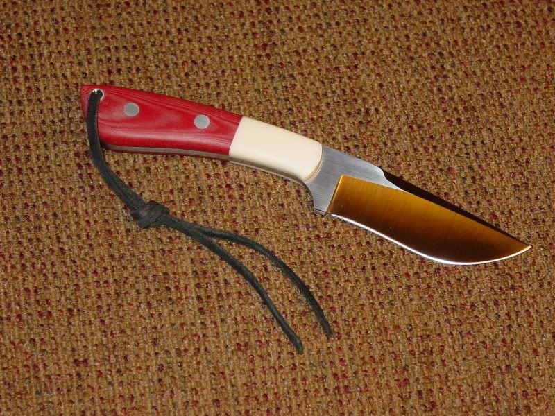

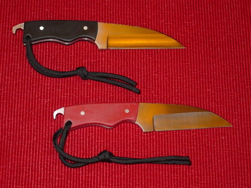

very cool john !!.....john's early skills are very promising...here are a couple he has made me. i am very pleased with john's work.
