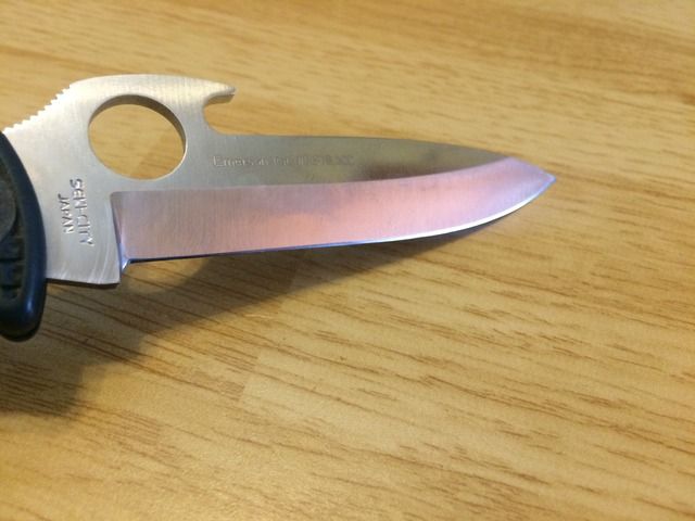

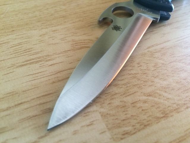

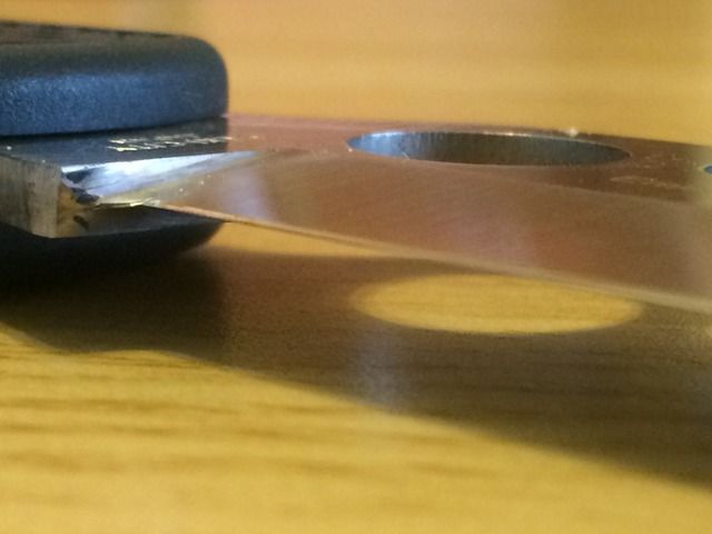

first sad attempt using new smith's diamond tri hone system
Feb 23, 2001
294
Okay, let me have it.
Please take a look at these pics and tell me what, BESIDES EVERYTHING, that needs improvement and how to make the improvements. I'm hoping some of you folks will look and say, "Aha! Here's where you're going wrong."
The blade is my beat up work knife, vg10 endura 4.
So far i've learned angle consistency is of primary importance and keeping a consitent angle is a female dog.
Also, the tip and heel of the blade are mothers.
Now, kick my butt.
Thanks

This is solely just me but this endura is really well used. The biggest test is if it cuts well for you. If it does your good.
If it were my knife, I would whip out the Norton crystolon course and go to work recreating the edge by thinning out the bevel.
Knocking off the shoulders with the course Norton should get you back to the original edge geometry. I only say Norton since you have the trihone but the Norton is really aggressive and will take metal off an edge way faster than anything else I've ever used.
The Endura with wave is a thick beast, I typically regrind them thinner and then sharpen. Yours is in need of exactly that.
If you didn't want to do that then I would probably recommend using a convex method to sharpen. Convex edges tend to work very well with thicker blades.
^ that would have been my second choice! Sandpaper'd convexed edge making the edge more like a fixed blades!
The recurve at the heel from repeated previous sharpening needs to be straightened. Unless you plan to sharpen the inner curve using rods.
A well used knife indeed, at this stage perhaps a convex is better.
Unless, you regrind the whole primary, including straightening the heel, then add the secondary bevel.
I'd suggest looking at some sample of regrind for ideas. Remember, regrind with your Smith coarsest stone by hand still take some time.
I did this over 2 weekends with lots of breaks in between. That wasn't even a regrind, it's just decreasing the secondary bevel. The regrind will remove more material = take longer.
http://www.bladeforums.com/forums/showthread.php/1304098-That-Endura?p=15406055#post15406055
(Check the SG one, the bevel is wider)

It's still sharp the way it is, sharp enough to slice paper anyway until it gets down near the heel, then it starts tearing. It's ugly as hell but it works.
You can use a medium ceramic rod to sharpen the recurve. All in all, still a usable and serviceable knife!
Sending it to Big Chris, Jason or Josh might be the solution. Very sure either of them can revive it to be better than new!
However this knife doesn't seem to have high sentimental value to you. My suggestion if it's my knife: get a cheap SiC stone & regrind . I might try FFG it like this:

As a project, taking my time & learning along the way. I'd remove the recurve using diamond file, creating a sharpening notch. The rest (after a full conversion is done) will be easily maintained on day to day.
