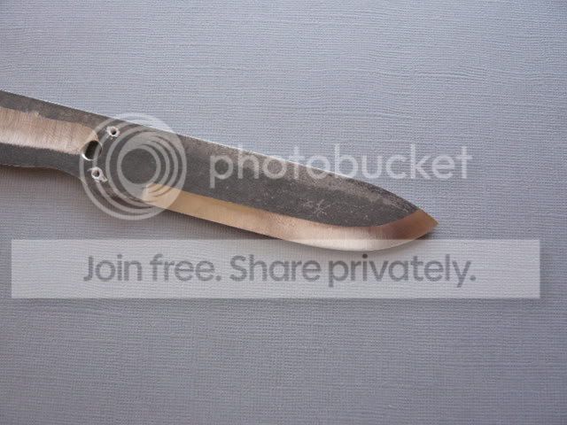

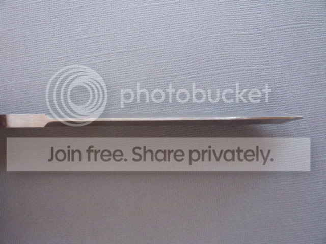

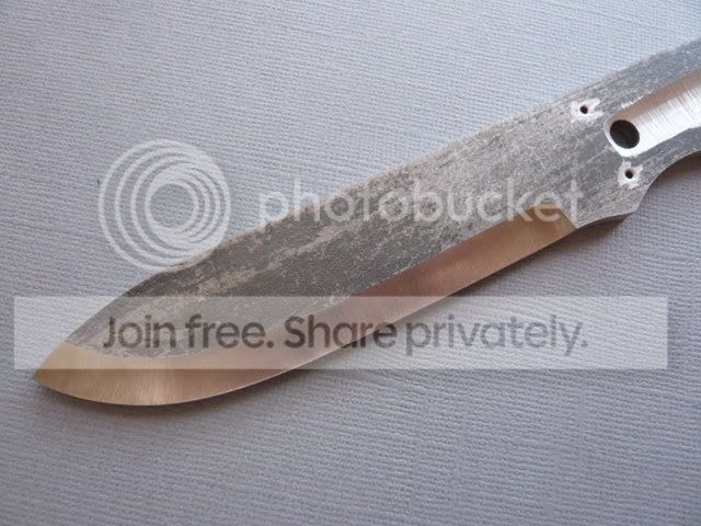

It seems that the scandi ground knives are appealing to a lot of buyers, so I wanted to give it a try. I made a jig along the lines of the one posted here previously by Andy Roy, although I need to make mine a bit more refined if I end up doing more of these.
Anyway, I've not handled many scandi ground blades and I wanted to see if I'm on the right track here with my grind. Stock thickness is 3/16", and the edge is probably around .030" or so, which is where I thought I would leave it for HT.
I'm not sure how much you can tell just from photos, but thanks for any feedback!

Angle is ~ 12.5 degrees.
I could go thinner on the edge before HT, but I'd be scared to go all the way to sharp! The thinnest I've HT'd is probably .010-.015, but it's not a big deal for me to grind them more after HT either.
That looks great! I've been trying to freehand a Scandi (a chisel kata-kira-ba actually) and still can't get the turn on the belly right.

It looks good to me Paul. My next piece will be done a adjustable jig, sort of like Andy's but I want to be able to adjust the angle as needed.

Looks good.
BTW, you should always mention the steel type and HT method when asking advise on such topics.
For a carbon steel blade .030 is about right for the edge thickness pre-HT. For stainless, .010-.020 works well.
Thanks Stacy; the steel is 1080 and HT will be in a kiln with oil quench.
Mostly I just was wondering if my grind looked OK since it's the first time I've done this type of grind and I don't have a lot of experience handling knives of this type.
