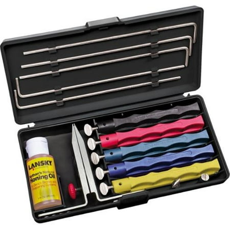

not diamond . but how about the Lansky Deluxe 5-Stone Sharpening System ? it's only $32 @ wally world . guided sharpening with a metal guide and 5 grits ....
http://www.walmart.com/ip/Lansky-Deluxe-Sharpening-System-Knife/4242367

Before I got my Wicked Edge system I was using the Lansky system shown above. To get as close as possible to the original edge I would push the rod with my index finger against one side of the given degreed openings. This would give me two slightly different available angles to choose from. Instead of just letting the rod flap around inside the hole. I found more accuracy doing it this way. I like the system. And still use it when dealing with serrations. I've re-profiled a few knives with it and am happy with the results.
I kind of wish I would have stopped off at the KME system before going right to the WE. Probably would have saved 500 or more dollars and got the same results. Although I do like sharpening both sides of the knife at the same time.
I've sharpened a lot of knives with the lansky set up. The biggest thing you have to watch for is that you get all the rods in straight and level. They bend pretty easy so if one is off from the others you will not be hitting at the same angle. I'm not crazy about for blades larger than six inches either. So if you're on a budget I don't think it's bad. All the systems have a little bit of a learning curve. I've made a few tweaks to mine to try and keep it a little more consistent.

Just was this post. In that case i'd go with the lansky. I think you'll find with a little practice you can get nice results with it.
Yep, Lansky is all you REALLY need, and like I said, I used it for a long time, finishing up with some hand stropping afterwards to get the mirrored finish. White to green to red.

Might be too late but I'd add my vote for the Lansky, in that price range it does a darn good job, and for many years that's all I used. I actually prefer the edge of the non-diamond stones except for the extra coarse diamond is really nice for profiling or removing damage. So if it were me I'd get the Standard 3-stone kit that you can get for under $25, then add the diamond coarse stone for $15. I like to use the guided systems to set the initial edge but use a sharpmaker for daily touch up, but you wouldn't need to spend the $50 on a sharpmaker you could get a much cheaper set of V ceramic rods. Lansky has a 4 rod kit you can get for under $15. So that would put you at $55 with a system that will cut fast with the diamond coarse stone, put a nice polished edge with the other non-diamond stones, and the V rod setup will make it easy to touch up and maintain.

Lansky is good and inexpensive. A couple of things to watch out. It is extremely important to make sure all rods are straight and level as kane pointed out above. Also, be patient and do not apply too much force (which can bend the rod easily). For sharpening recurves, the force needs to be even less and I found it helpful to tilt the stone a bit so that only one edge is hitting the blade. Round the edge of the stone in advance for that purpose. In fact, I think an improvement to the Lansky system is to round edges of all stones (well, that will not help the company make money on selling those stones specifically manufactured for sharpening recurves). Lastly, do not waste money on the Lansky leather strop.
