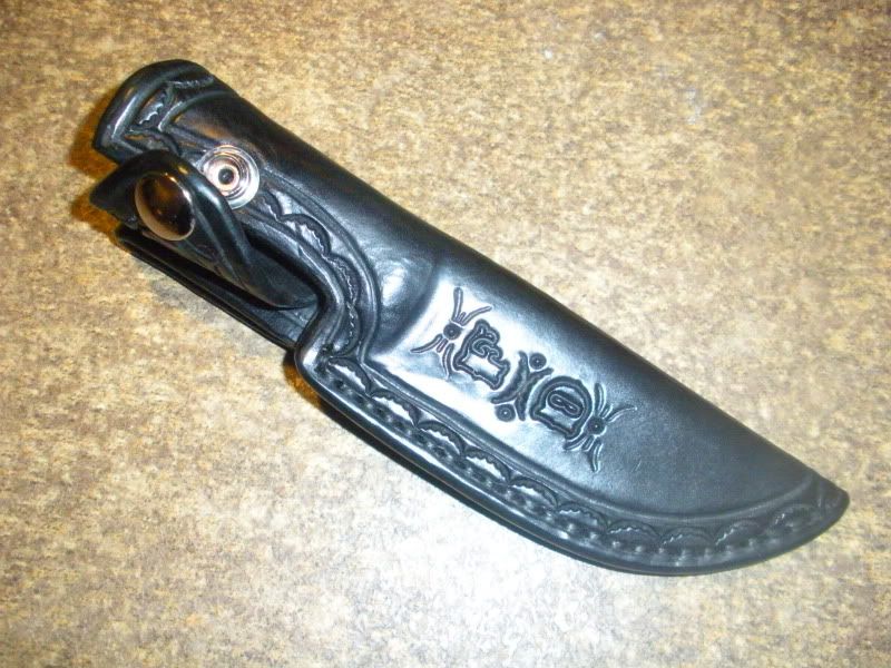

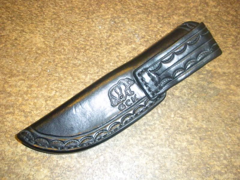

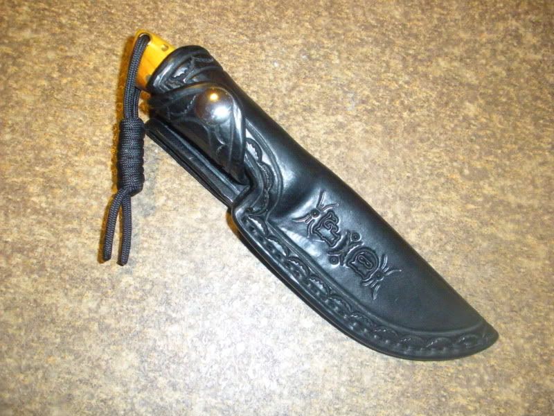

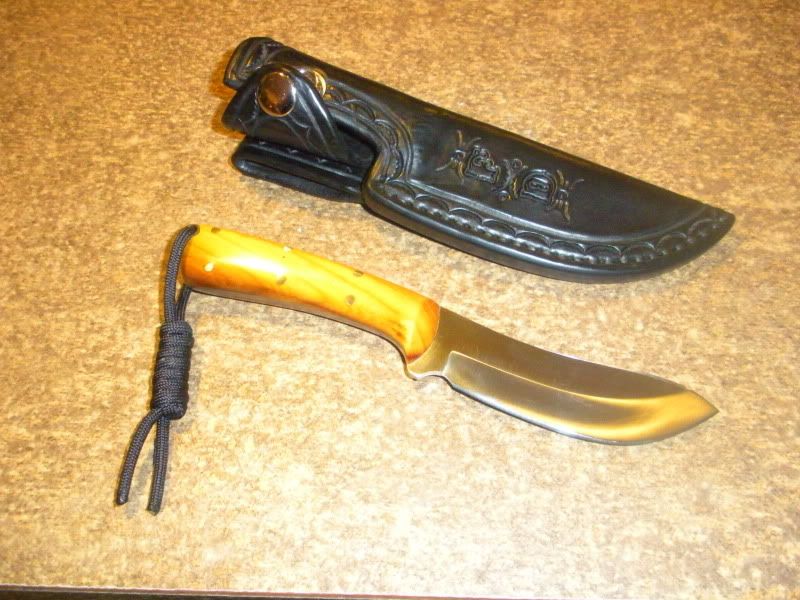

The customer who ordered this knife and sheath wanted a different sheath than my normal pouch design. So, I printed up several options and he picked the one he liked. I've never made one like this before, and I have GOT to learn not to be stingy with my leather....it almost bit me in the end with the fold over snap area...it fits and snaps perfectly, but there is no room for movement at all.
It's made from 8/9oz veg tanned, dyed Fiebing's Pro Oil black and finished using my mix of beeswax/paraffin/neats foot oil heated into the sheath. Final finish with 2 coats of neutral shoe polish.
Any critiques are always welcome, I would especially like ideas concerning the belt loop attachment as I think it could have been done differently. I basically took a length of belt strap, folded it over and skived down the ends to make it thinner, then glued and stitched it onto the back of the sheath.
So, without further adieu...
BTW, the knife is a bullnose skinner in 440C with Osage Orange scales.
