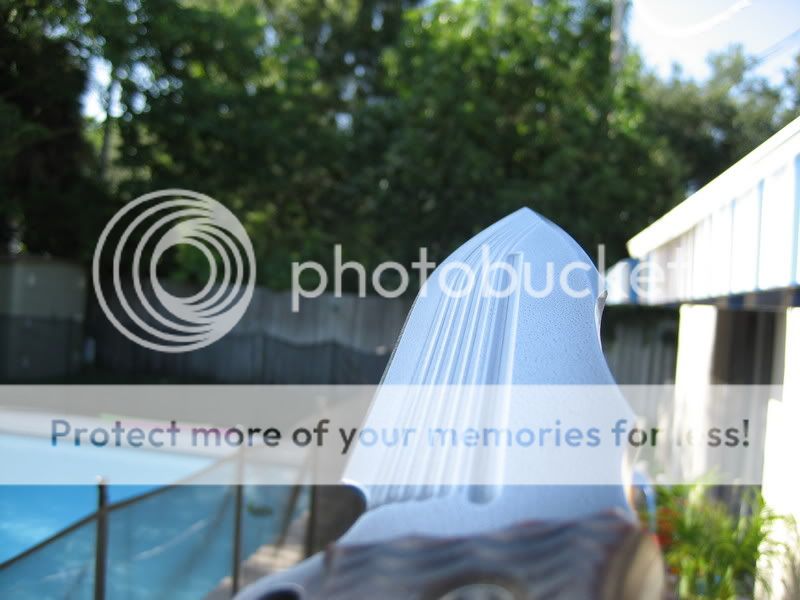

I have (had) a Hell Razor with OD crinkle coat and tan slabs. The OD coating on the blade did nothing for me. What else to do with this Hell Razor besides trying to sell her, strip it. This is my first attempt at stripping a Busse Knife, any knife for that matter. First I stripped the knife using Klean-Strip and then proceeded to polishing the blade. The following pics depict the process that took about 1.5 hours this afternoon. The polishing is not complete, yet, but I am satisfied with the results. Enjoy.

Here is a couple of pics of the blade after about an hour of polishing, not quite complete, but looking nice. The blade turned out shiny but not yet satin. The dimples in the blade are evident also.
