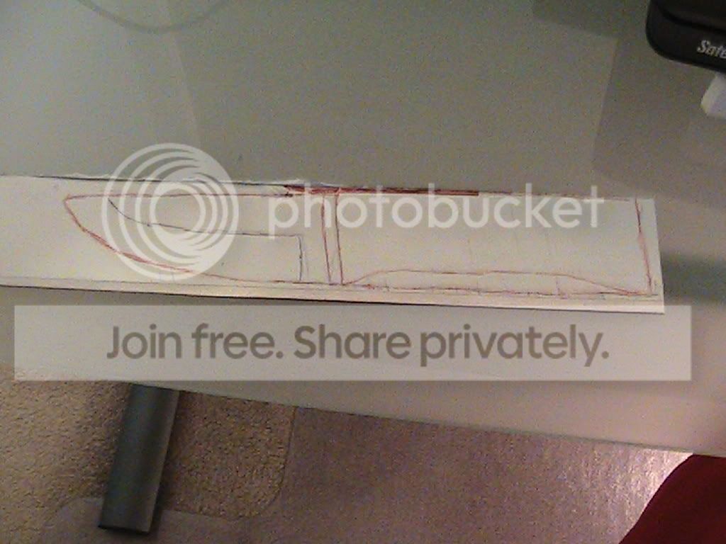

Hello, im going to be trying to make my first knife :). Im 15 and my dad will be making it with me (he has no experience with knife making either).
Here are the two designs that I drew on some aluminum, which I will cut out and use as a template. Please tell me what you think about the designs and if you have any recommendations about it.

added the photos here for you....
Andrew,
4130 is not a good steel to make a knife from it does not have enough carbon to harden properly. It will work for practice but I would recommend 5160 or 1084. I have some 5160 I will gladly mail you if you tell me how long you need and give me an address. Make sure it is OK with your parents first please.
Welcome, pretty cool that you and your dad will be doing this project together =)
First one... I'd say round out the pommel (end of the knife) instead of just having it squared off. The second one I'm not sure but the handle is the only thing i really would rework a bit, maybe add some curve to it? That will help asthetics and comfort when you hold it.

Andrew, Take AC up on his offer if ok with your dad. If you are going to put in the time and effort, it would be nice to have a blade you can use. Cut out the aluminum template and see how it feels in your hand, think about the steps in your mind. Have you read the "Stickies" in this forum about Newbie knife making?
Ya, so here it is as predicted.
In looking at your drawings-
I would suggest cutting your templates out of cardboard or wood first.
Paint stir sticks are free and pretty good for that purpose.
Use several layers to build it all up in 3D
I think you will find that the handles are very wide / blocky
-consider putting in a deeper groove at the first finger to act as a guard
& it's easier to make changes now.

Wow everyone, thanks so much for your advice, and adding the pictures on here :)
The templates may look big, but the both knives are under 9 inches long

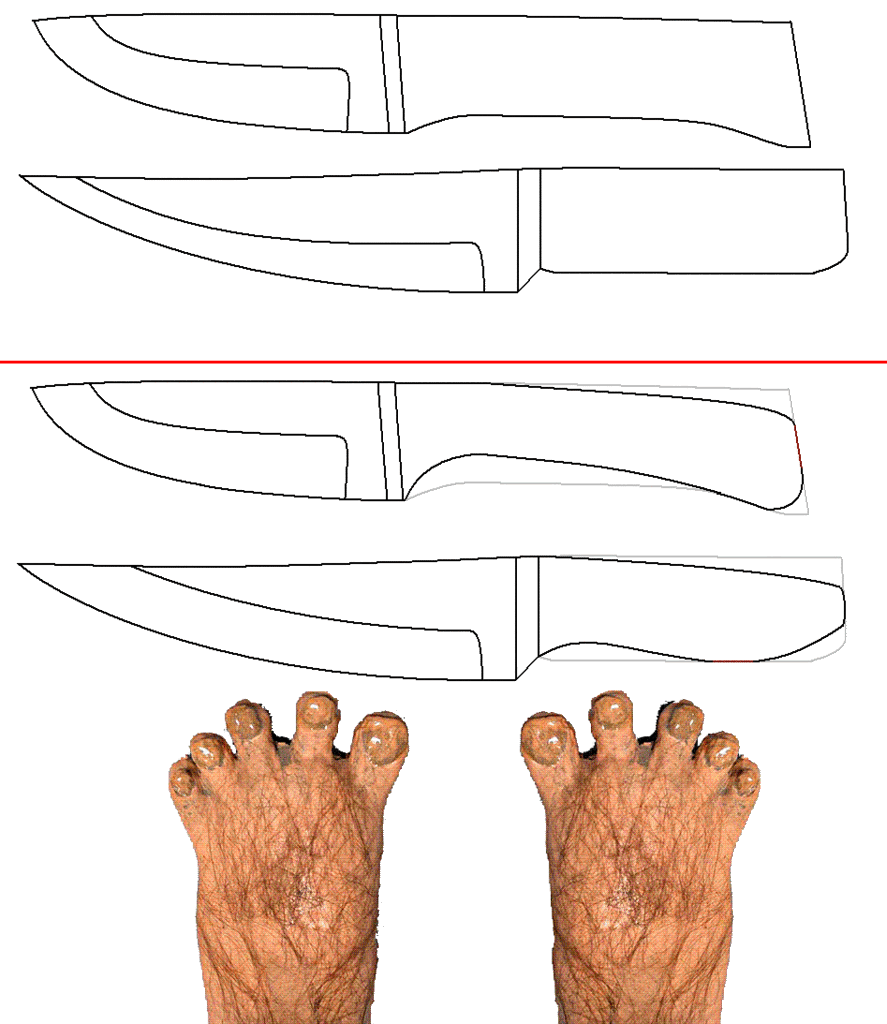

I agree with Mr Wolf, the handles are perhaps where the greatest improvement could be made. I took the liberty of virtually tracing your designs for greater clarity, and modified what you had just as an example of what might be done to make them a little less boxy and hopefully a little more ergonomic. Do not make the mistake of thinking that what I drew was marvelous. If you put your design onto cardboard then you can take scissors, and start shaping the handle and explore different shapes.
Anyway, here are the "for instances". The top two are your original designs, and the bottom two have the handles modified.
Oh yea, nice socks you had on. I thought your feet shouldn't be left out of the picture. ;-)

HAHAHA, thanks I will definitely make the changes to the handles, I really appreciate your drawings to help me. Were the feet necessary? haha! I knew mine looked silly in the picture but those feet? haha

lonepine those mods look good, just what I was thinking :thumbup:
