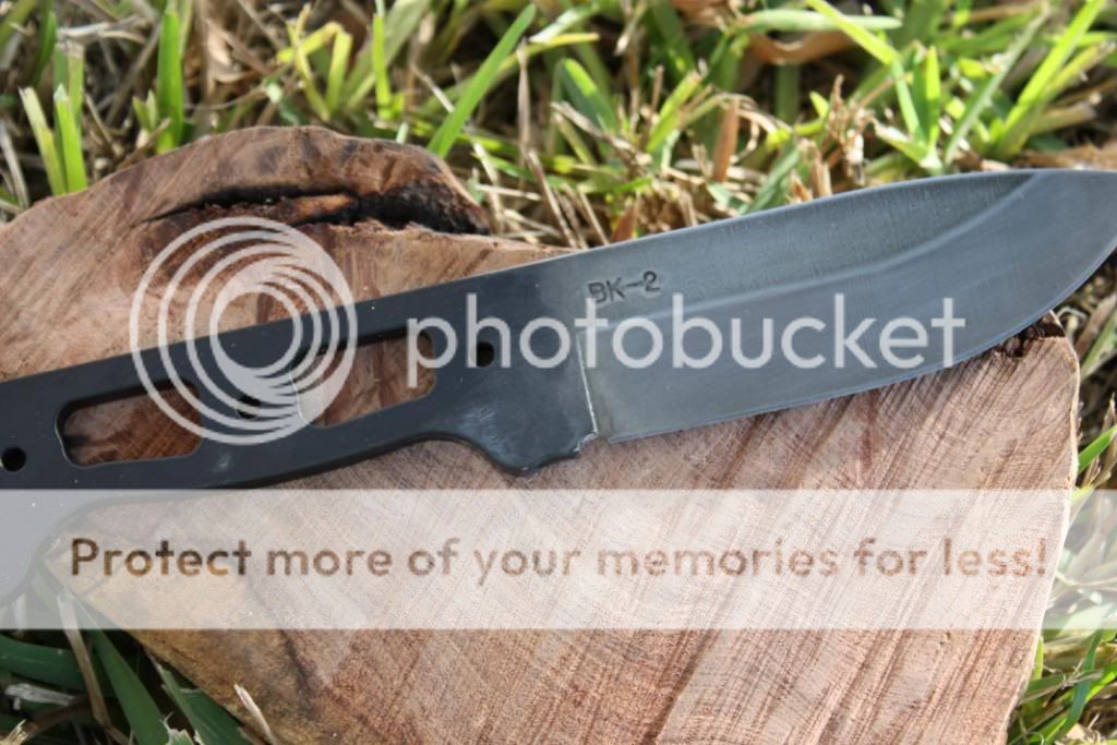

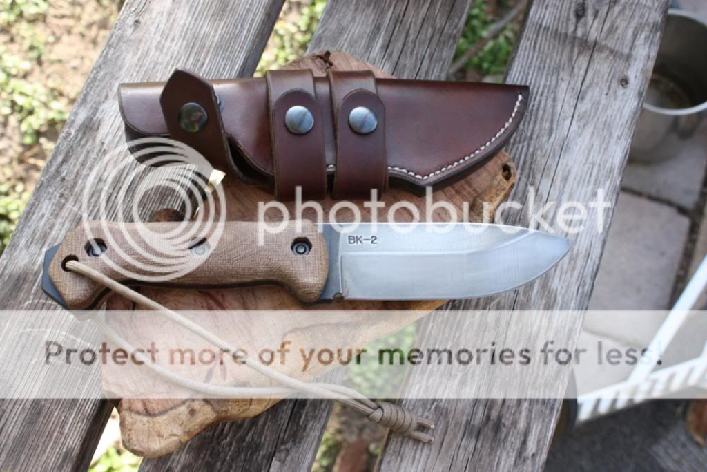

First time strip and vinegar patina bk2 and bk11
Dec 25, 2011
278

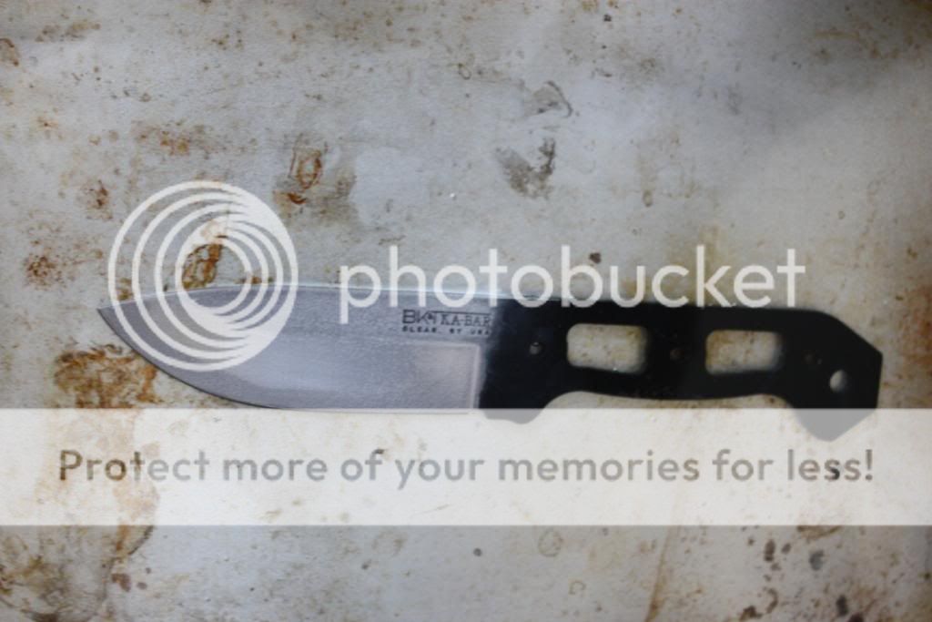

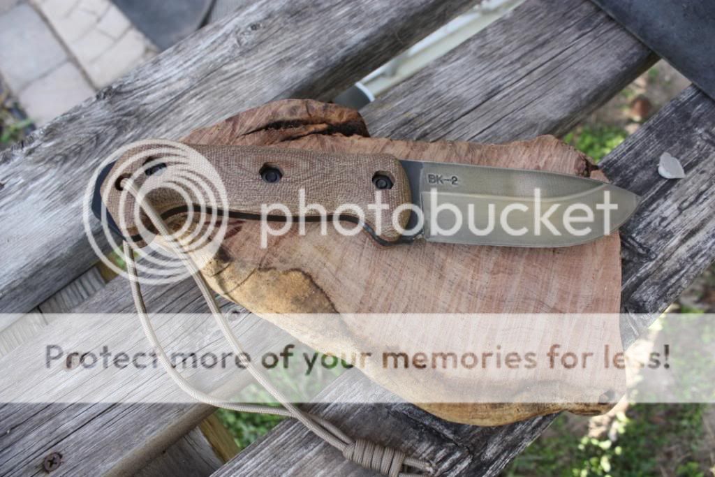

before stripper i sanded part of the blade and tested with vinegar
this stuff works quick

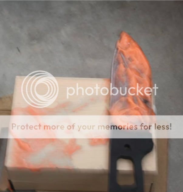

vinegar bath
did two 30 min dips then cut up an onion and a lime

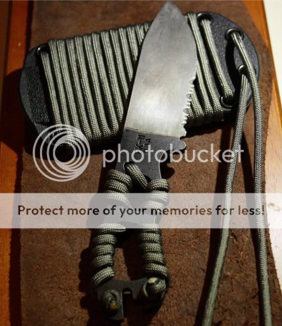

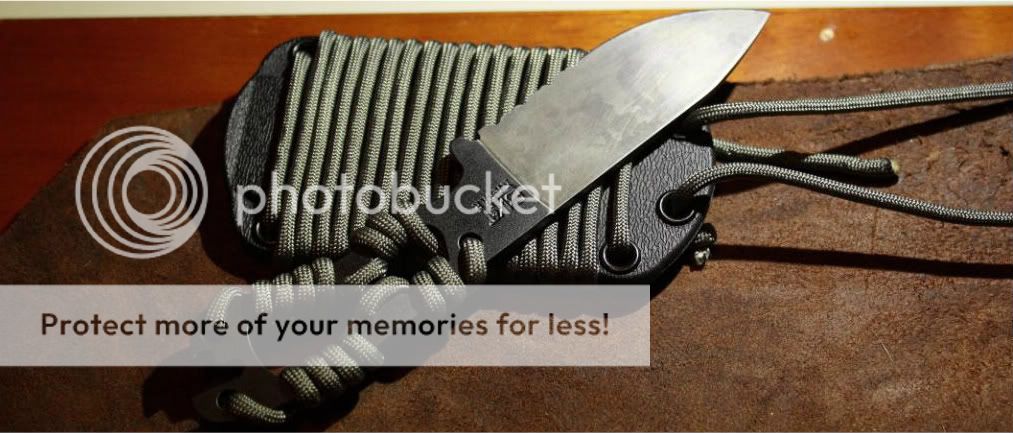

a little fine sanding a little oil and done so far
Citristrip? Interesting, is it available at the usual places, ACE, Home Depot, Lowes? I have a BK11 and a BK9 on the way that I'll be stripping.
Thanks guys pretty happy with the results. Monster I bought it at Walmart. No harsh fumes and it worked like a champ. Now I just need more knives to strip. -Leo
