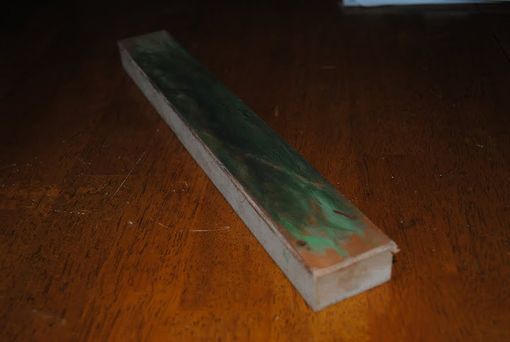

Here's my simple (and cheap to make) strop- A strip of leather glued to a piece of MDF. I have a few of them that I load with different pastes.
