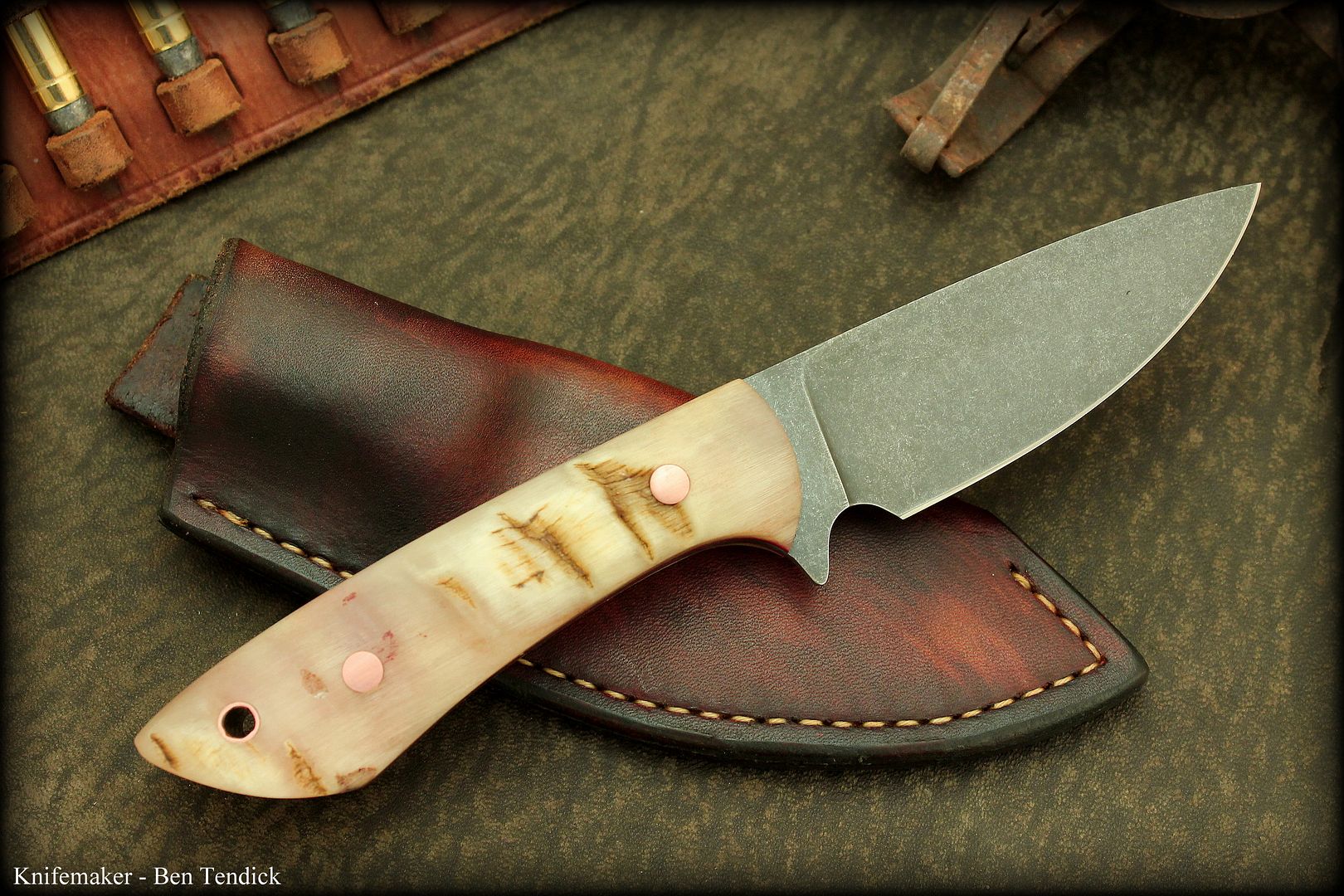

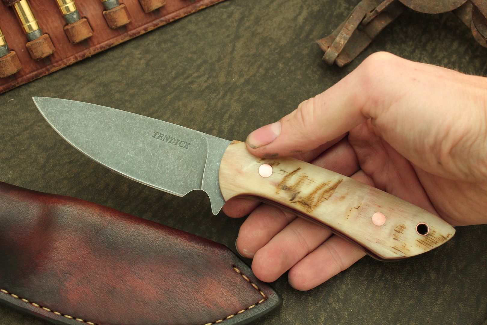

I just finished up this special compact Scout. This is the first time I have used sheep horn and I think it came out pretty cool!

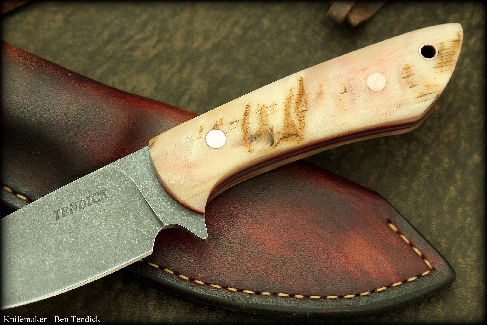

It has different reddish colored streaks running through the horn, which looks very neat.
The blade is Elmax and is flat ground to a nice thin edge. The blade is 3.75" tip to handle and 8.3" OAL. The tang is tapered down to .041".
It has copper pins that I darkened a bit for a nice warm look.
Thanks for looking!

I first get it to a nice 320-400 grit finish and then media blast it. Then it gets a soak in a feric chloride/vinegar mix for 5 10 min. After that it goes it the vibratory tumbler for 5-10 min.
