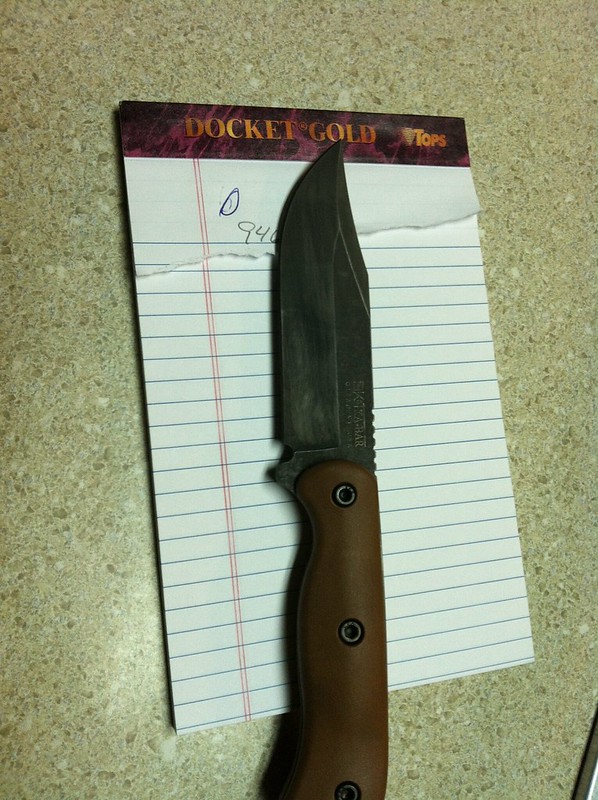

well, i've been trying my hand at modding on my BK17, I've so far stripped it, and I am working on a patina now.
I was surprised by the coating, after sitting in the stripper for while, it peeled off like plasti-dip spray, it was easier than I expected
obligatory first pic, more as I keep working on it
It got the weird color half way up the blade halfway to the handle too, my only guess is that the stripper got in where the etchings in the coating were

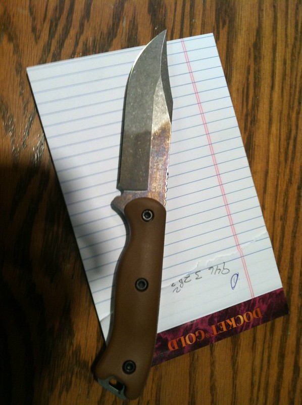

and here is the patina, I did it with hot apple cider vinegar
the patina seemed to wipe off easily at first, but when i let it dry, it stayed a bit more permanent.
if it wears off too easily, I will just redo it.

I like the apple cider patina. I may have to try that one next time. Somewhere I read that gun blue was not suitable for a knife used in food processing. But I wonder about the validity of that claim. After all, gun blue is also just a form of rust.
keep the apple cider patina.. the purpose of the patina is just to prevent corrosion. The forced patina will change as you use the knife. With this patina on it.. use the knife in the kitchen for a few dinners... cut up onions, peppers, potatoes, and even meat. It will continue to develop the natural patina and will look good.

I tried a few different things and liked the apple cider vinegar look. The excess black coating will rub off quickly but underneath is pretty resilient.
