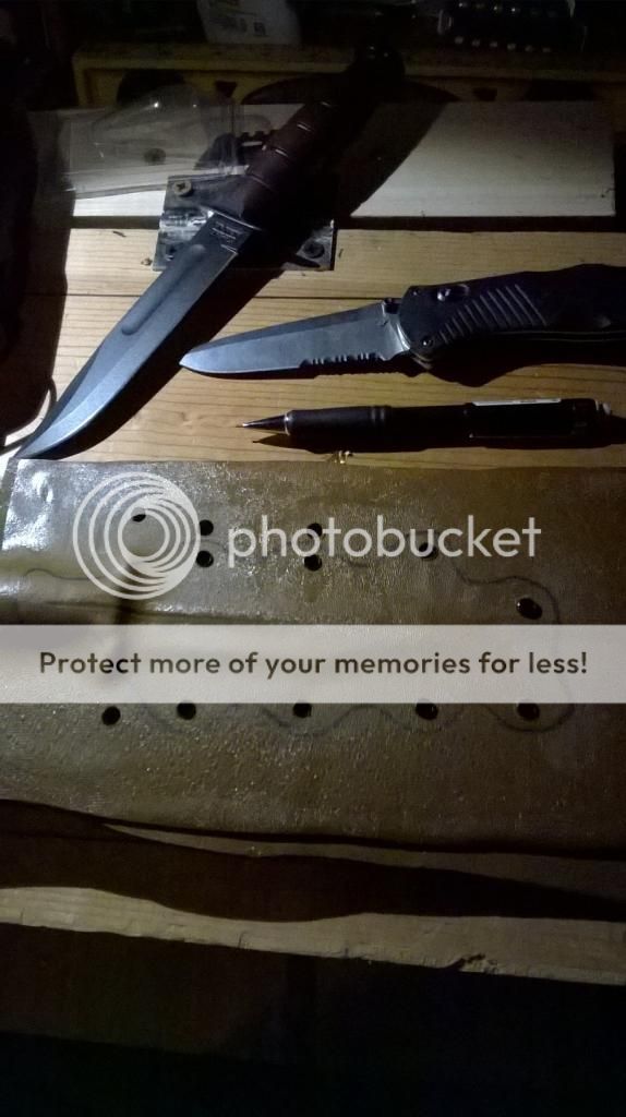

ok so this is my first ever attempt at a kydex sheath so lets see how this turns out. i forgot to take some of the pictures but i hope you get the idea

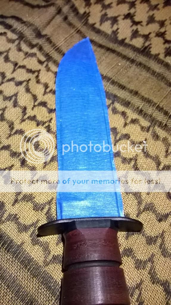

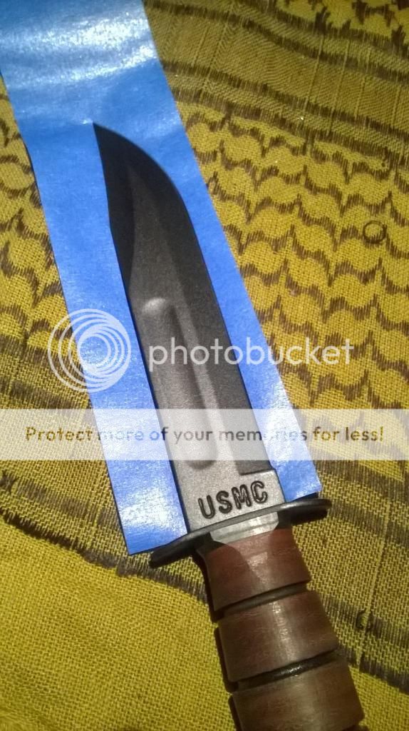

first i tape up my blade with one layer of blue tape both sides

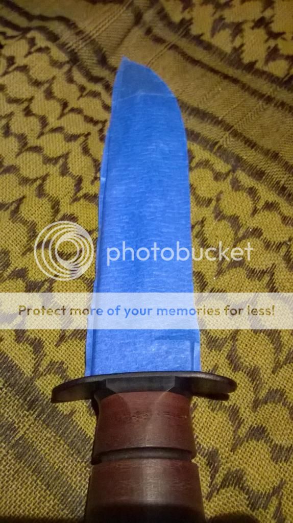

then add a second layer but i cut an inch or so off the strip leaving the tip of the blade with one single layer do i did this on both sides

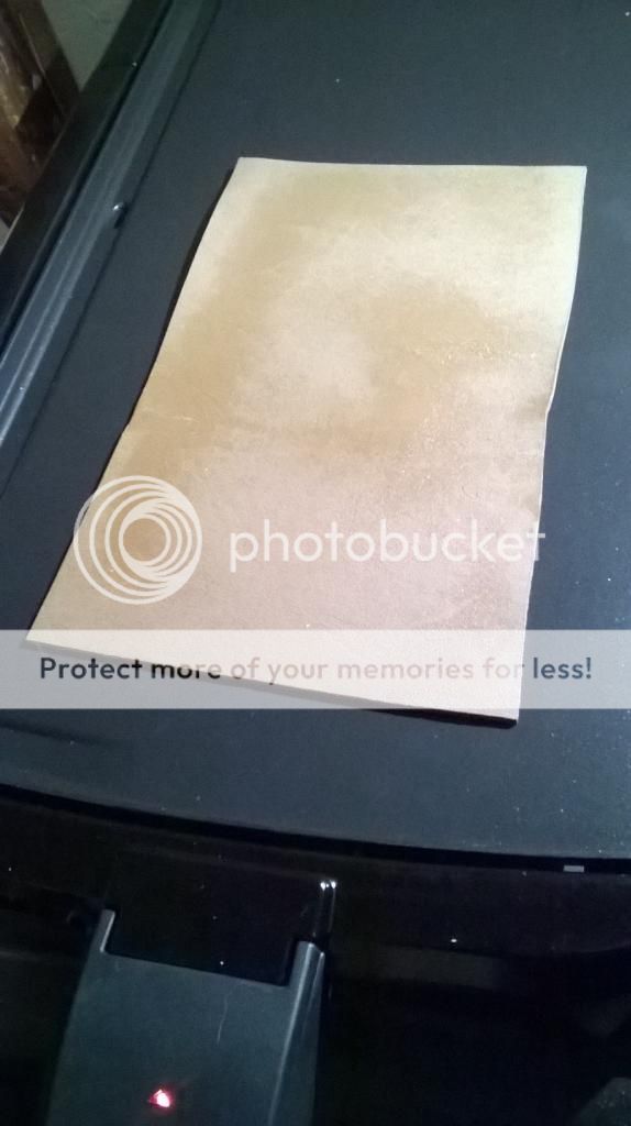

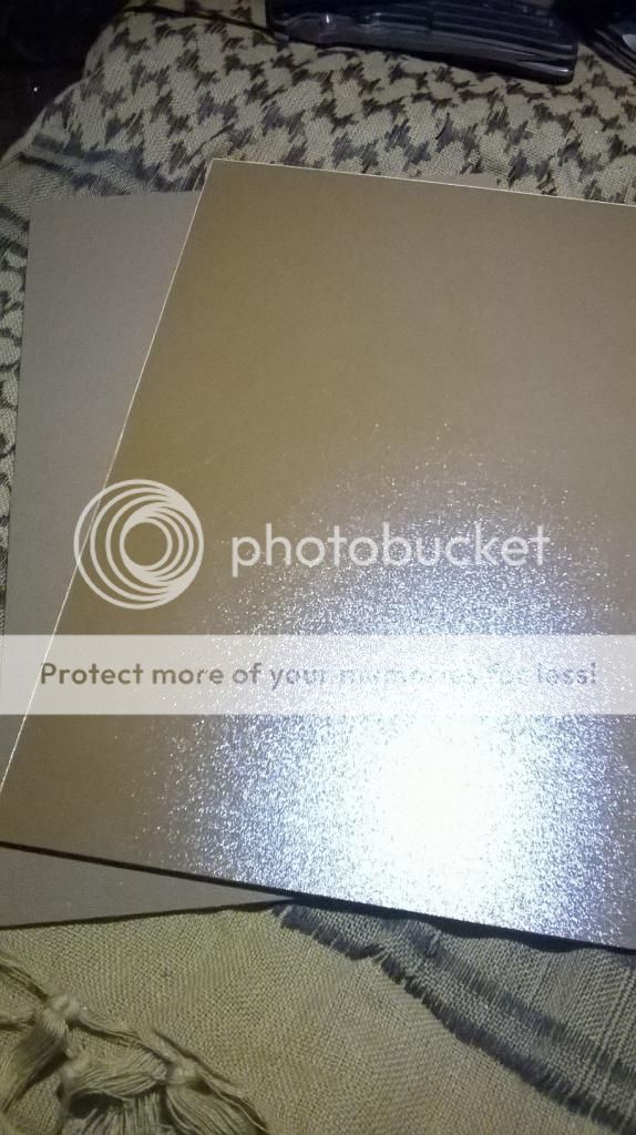

ok now here is the kydex i cut in to pieces
here it is heating up
here it is clamped

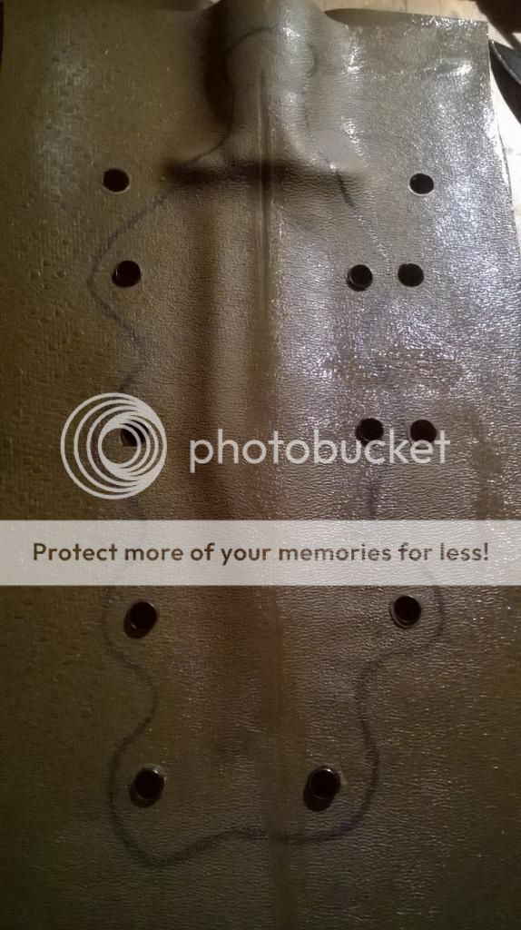

here is the outcome
the design so far (subject to change)
more tomorrow and hopefully finished
