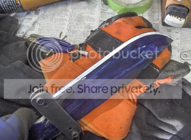

Hi, all! While I'm finishing up drawing out my first blade design, I decided it would be wise to practice some flat grinding before I dig into something I mean to someday use.
I believe I mentioned this in another post, but I have an old, rusted Ka-Bar which I had badly damaged on a camping trip a few years back. In my frustration at the time, I tossed the blade into the campfire and inadvertently annealed it. Thinking that someday I might attempt to resurrect it, I removed it the following morning and stowed it away. It is that piece of metal which I'm practicing grinding on, since I don't see it ever being reincarnated back into an actual knife.
So, I threw a 50 grit belt on my 2x42 and went to it. Mind you, not very scientifically. There was no scribing a center line, exact measurements, etc... just me, my push stick, and some serious desire to figure out the process by trying.
I had a couple of screw ups along the way... burned the tip rather badly, which I cleaned up well enough on subsequent passes. And, as you'll see in the photos, there are definitely some spots (where the ricasso used to be) where I mis-ground or made a small divot (for lack of a better term in present vocabulary).
Aside from those issues and my disregard for the ricasso (since it doesn't matter on this one), I feel ok about how I did. I sharpie tested and the entire surface is flat. I also managed to create a distal taper where previously there was none (Ka-Bar USMC doesn't have one, if memory serves). The spine tapers from 1/8" at the ricasso to 1/64" at the very very tip. At the edge, it's a consistent 1/32" all the way along. (Bear in mind that this wasn't a blank, it had a decent edge on it when I started, which I blunted off).
Here are the pictures... I can take criticism, so fire away. This is, after all, my first attempt at grinding anything with any clear intent.
This is the spine, showing the taper. I deburred it a bit.

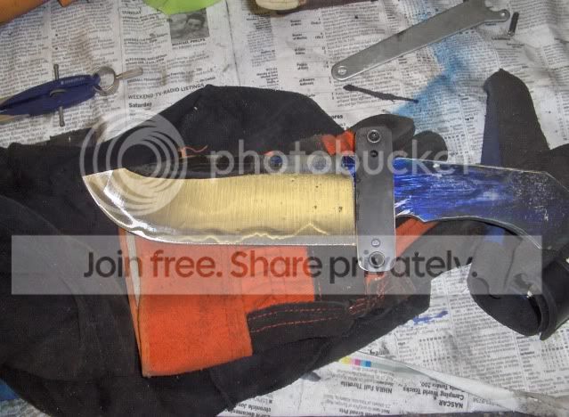

Here is the surface... you'll see what I meant about a divot near the ricasso. Also, there is an area near the edge where I had begun playing with filing in a choil (proper term...?)

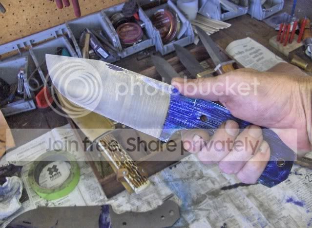

And then here is a shot where you can see a bit of everything. Take my word that the other side is almost perfectly identical. I didn't think to take another picture.
