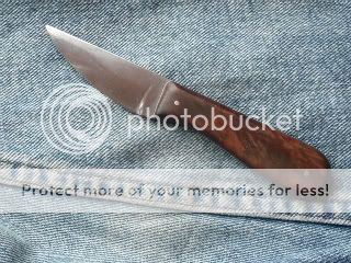

Here is a quick pic of my first try at making a knife. I read enough to get a basic idea of what and how to do it, ordered some steel and jumped in. Sometimes you can spend too much time researching and I learn best by trial and error. The basic profile I saw in a picture and it was captioned as a "Roach Belly". I knew I wanted a smaller knife that was easy to handle so the blade is 2.5" and the OAL is 6". I ordered some .090" thick 1095 because I read it was easy to work with and I could heat treat it myself. So with basic tools I already had and a bunch of wet/dry sand paper I ended up with this. I heated the blade in a grille with charcoal until it was non-magnetic and quenched it in canola oil then annealed it for an hour at 400 degrees. I hand sanded/polished it out to 1200 grit and then hit it on a buffing wheel. The scales came to me from my father-in-law's stash and I believe are burl walnut. I gave them 5 coats of tung oil thinned with mineral spirits. I learned a quite a bit and next time I will spend more time paying attention to my polishing. There are a couple scratches I didn't get out before moving to the next grit but I am gonna blame this on poor lighting. I need to make a grinding fixture to keep my plunge line true or maybe cut it with a file? Any way as basic and primitive as it is, this is it.

Nice job Robb-It looks great,especially for a first-keep at it and you'll learn something new with every knife:thumbup:
My Hat is off to you. very nice for your first try I look forward to seeing what you do next and hope it will be a bit bigger.
Thanks guys. I am gonna work my way up to something bigger. There is so much to learn and consider. I got it sharpened and now I am going to see how well it works.
Robb
I've seen much worst for first knives.
It shows potential, stick with it if you enjoy it.
Robb, nice work apeice to be proud of. BF is a endless soures of info and guidence,welcome aboard brother.
Thanks folks. I will say making it served as great source of stress relief. I've been working on a second so hopefully I'll have it finished shortly. Its a small knife as well. Number three will be larger.
