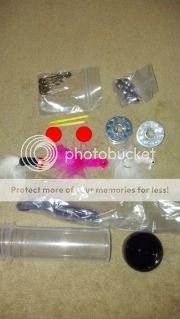

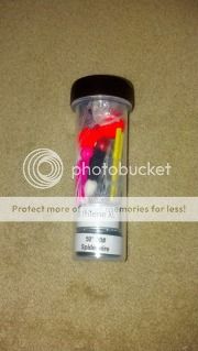

I have 50' of 30# Spiderwire in mine, along with 40' of Trilene - both on metal bobbins. I figure the Spiderwire can be used for fishing and sewing. I haven't tried it for snares yet. Also in the kit are assorted hooks, split shot, 3 crappie jigs, 1 pre-rigged worm, and two bobbers (strike indicators from my fly fishing gear). I've been toying with adding a couple flies, but haven't gotten around to it. All that fits in a tube about the size of a Bic lighter. Crappy cell phone pics:
