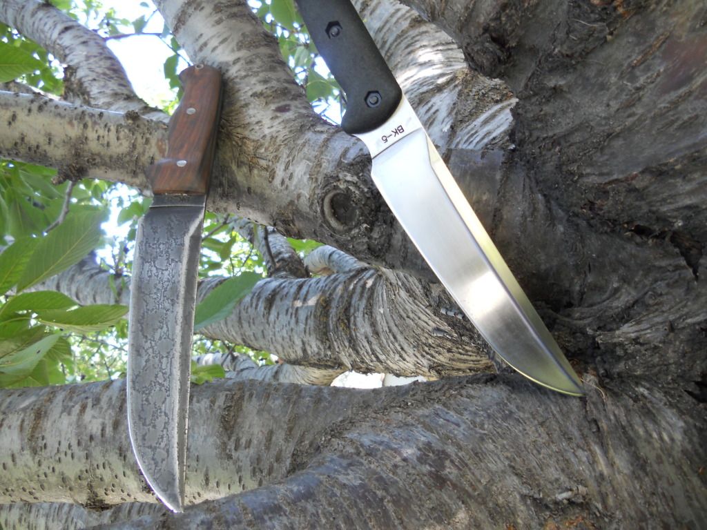

I recently bought a 5, and during my research I found out about fisking. So, my main question is what are the advantages and techniques you use to fisk? Also, any more information is useful. Feel free to post pics of your fisked knives, too.
Here's mine - done just a few weeks ago.
Biggest advantages to me are (1) it was fun to do - and (2) I think it looks much better than how it came from the factory. Some with more expertise than I will tell you that it will slice better because both shoulders are gone or at least smoothed over and I'm sure that is correct.
Techniques: stripped it with a product called Citristrip - comes in a spray can and is easy to use. Then for convexing I used a belt sander with a 2000 grit belt, then strips of sandpaper glued to boards, (1000, 1500 and 2000 grit) and then a strop. Final touch a set of Bubinga grips.
Fisking is to thinly convex the edge of a knife. It makes the knife very, very sharp and slicey, without compromising the strength of the edge very much. I've chopped wood with my 5 (it's not a great wood chopper) and the edge didn't chip or roll, despite being much thinner than the factory grind. The extreme convex is strong. Yet, my 5's are the sharpest knives I own. They'll cleanly slice crumpled-up notebook paper, which is very hard to do with most knives. The rounding of the grind lines on the swedge also means that the blade will encounter less resistance as it passes through whatever medium you are cutting.

My 15 on the right, has been. On the left is a standard V on a 25 degree.

That's how I did the one on the right. 80/220/6000 belts. I basically just laid the blade on the belt first, and then graduated to steeper and steeper angles until it looked right.
As C-bear noted, the Snakeskin 5 was Fisked by Clich. I basically copied how he had done it, only he used a belt grinder.
ok, so can anybody explain the difference between fisking and convexing?
Convexing usually involves just rounding off the shoulders so that you do not change the thickness of the blade behind/above the secondary bevel. Fisking requires that you use a belt sander or similar device to remove some of the steel on each side of the blade above the secondary bevel. It gives you a slightly thinner blade all the way up to near the spine but still convexes the cutting edge.

Why does this sound like a FFG with a convex edge? What am I missing?
You don't take off enough metal to make it a true FFG. Just enough to break the shoulders and round them out. Also, to thin the edge out quite a bit and make it much sharper than a normal factory grind or even a standard convex.
TD, you may want to experiment with trying it with sandpaper, not a belt sander. Sure, it will be slower, but there's less chance of jacking up your knife.
Sandpaper taped down to a flat surface.
