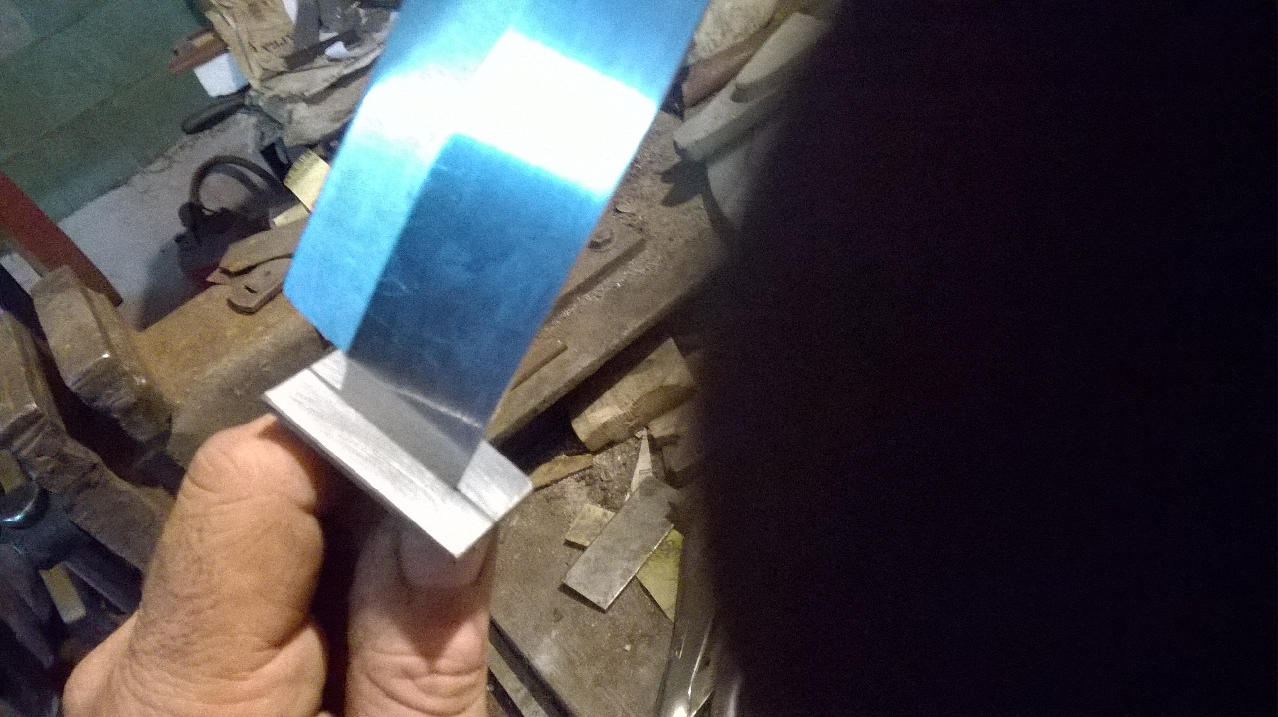

Hey fellas,
I'm new to knife-making (but not new to screwing around in the garage!) and working on my first Scandinavian stick tang knives. Well, kind of working on them. I'm still on step one...making and fitting brass bolsters. I have some brass bar stock that I've been cutting up, and to start I drill a few tiny holes where the tang will go through, connect the holes with a jeweler's saw, then use needle files to fit. This particular blade does not have a full flat grind so there's a small peak/ridge in the middle of the blade's width as see below.
Needless to say, filing the hole to fit this contour perfectly is a real chore. On the first bolster that is what I tried to do but the fit didn't turn out as tight as I'd like. I read online that a lot of folks make a bolster with a slightly under-sized hole and then press-fit onto the tang. This sounded like a good bet to me so I tried it this time. The fit on this bolster, shown below, actually turned out a little worse. By hammering the brass bolster onto the tang I believe I stretched or deformed the brass a little bit.
Did I use too much force here? Just how meticulous does my tang hole need to be to achieve a tight fit?
Any advice is greatly appreciated
Thanks,
Matt

I'd suggest grinding the tang down some more, so it's a taper all the way to the blade in every direction.
If you're handy with soldering you could make that disappear, but it's best to learn how to fit guards well to start
getting a good fit is not easy, but it looks like you did pretty well. that would disappear with solder but you hammered on it so it is not flat. i would not try to press fit a guard less than 1/4" thick because it will deform. when you get the guard about 1/8" away from where you want it to be, hold it up to a light and note where where the light shines through the crack, and where it is touching the tang. file only the areas that are touching with a needle file, and repeat until the guard sneaks up the last 1/8" of the tang.

Lightly tap around the gaps with a ball peen hammer, refile the slot and make the face of the bolster flush again

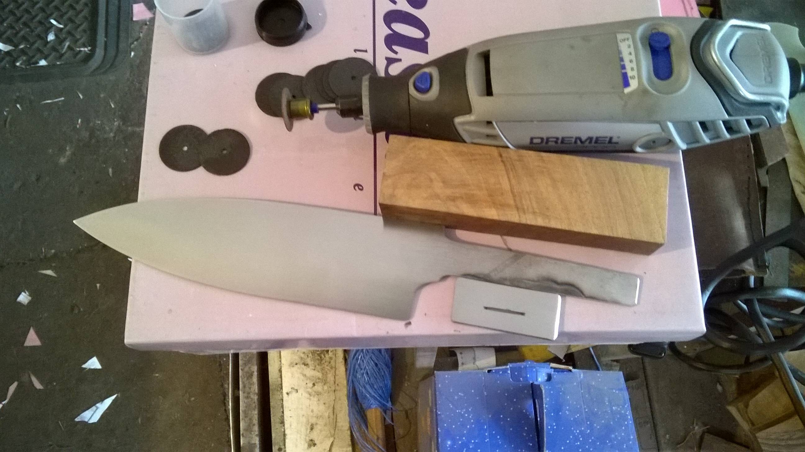

I found that in some cases Dremel is excellent for this job . Up to 5mm thickness works fine , especially for thin opening in bolster . Depending on the thickness of tang I use one , two, three cutting discs at once ....Of course depending on the width I use adequate cutting disk Dia. This is bolster for 1.5mm thick tang on kitchen knive .With a file probably would be impossible to do it . . .
Assure the tang is tapered away from the blade so there is no binding until the guard seats at the shoulders.
Stupid as it sounds, unless there is absolutely no way you can put the guard on backwards, mark the back side with an arrow pointing to the spine. That way you know what orientation to put the guard while fitting it.
Carefully file the guard and test fit every few strokes - NOTE - You can take a few more strokes to remove more metal if it is still snug, but can't put even one stroke back on if you filed too much.
File the slot at a slight taper, so the back side is wider than the front. This will apply all the snugness in the front, and you can be sure it isn't the back side that is sticking. On a guard or bolster that is over 1/8" thick, route out the backside larger than the blade tang, leaving about 1/16" of the slot to be filed on.
A black Sharpie is your friend. Blacken the inside of the guard slot. Slide on and push tight a time or two and remove. Look inside the slot and see where it is rubbed away .... that is the tight spot.
Learn to soft solder. No matter how good the fit is, there is still a gap and moisture can/will get under the handle. Soldering seals this up and looks professional. JB Weld also works to do the same thing, and is easier to use than solder. A small brass graver made from a 1/4" square brass rod will clean up the joint whatever you use.

Well, there's my first mistake. I don't think the tang is tapered actually.
Soldering....didn't think of that one yet. I do know how to solder but I'm certainly an amateur. Never used anything other than the standard lead/tin solder and silver solder a couple times. Is there any solder that will blend well with brass and look inconspicuous? Can I use solder to fix up a poor fit or will it show?

So I end up milling mine when I do them.
Another problem I've had, when fitting something I've filed at a taper for a press fit, is keeping the face of the guard perpendicular to the blade. That's really frustrating, filing and fitting, pressing, taking off and filing, over and over and then on the final installation the stupid thing is cocked :mad:
If there's any reason for a knife maker to have a milling machine it's to slot guards imo.

On thin knives like kitchen knives, I use a slitting saw matching the thickness of the ricasso. This has saved me a lot of time, and I have way fewer broken small end mills too. :cool:
