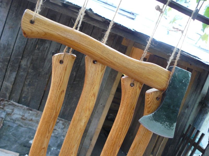

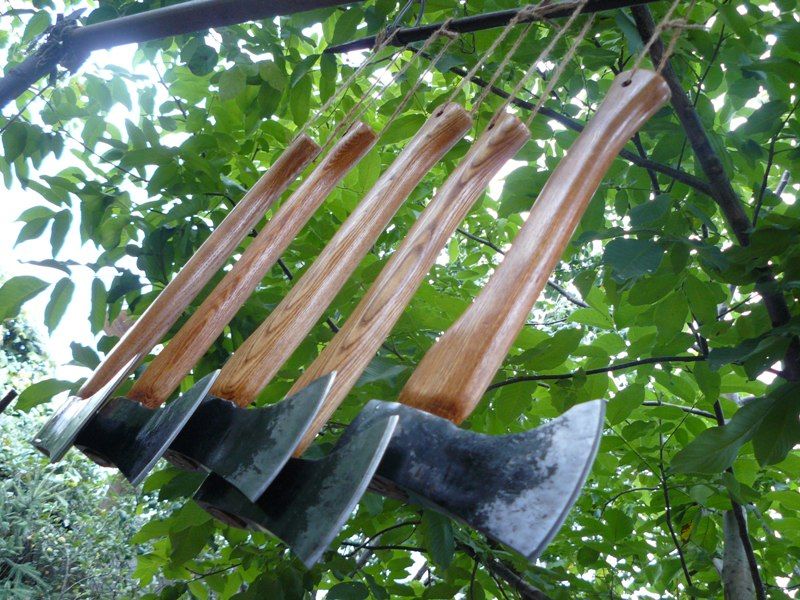

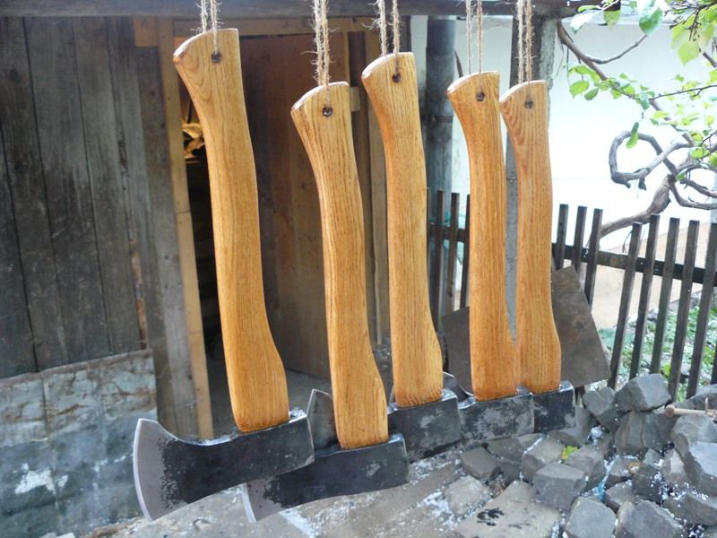

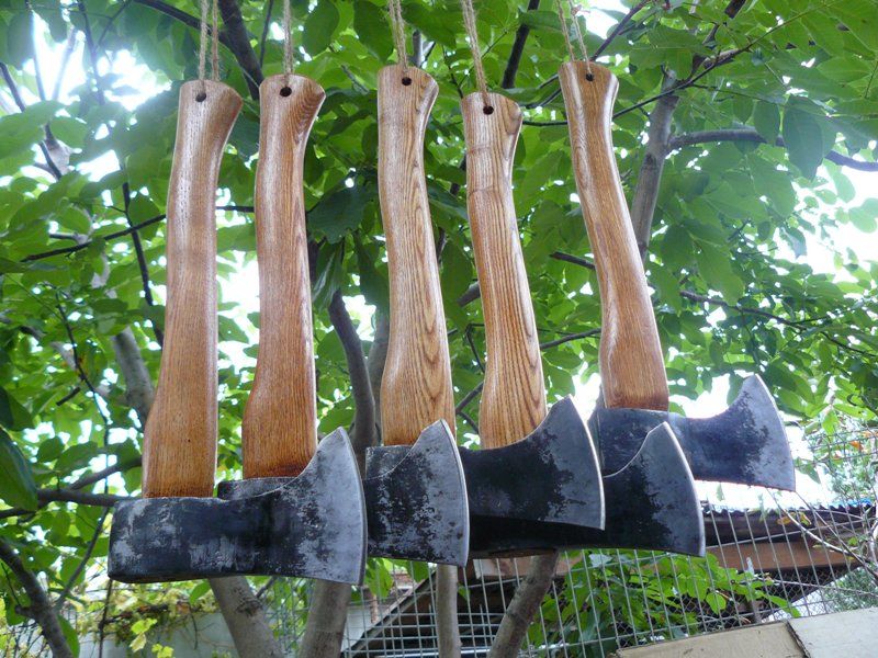

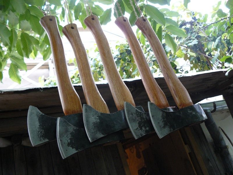

hatchets on steroids (1,5 pounds).
Thanks.
This are for five friends (boar hunters), especially for butcher the boars and camp tasks.
Those look awesome, Leon! Nice work. What's the story on these hatchets? Did you forge them? What about the handles, did you make them?
Great looking pieces. I'm sure your boar hunting friends will be very excited.
Take care,
Matt
Sweet looking hatchets. They are just the right size for packing into the bush.
Thanks!

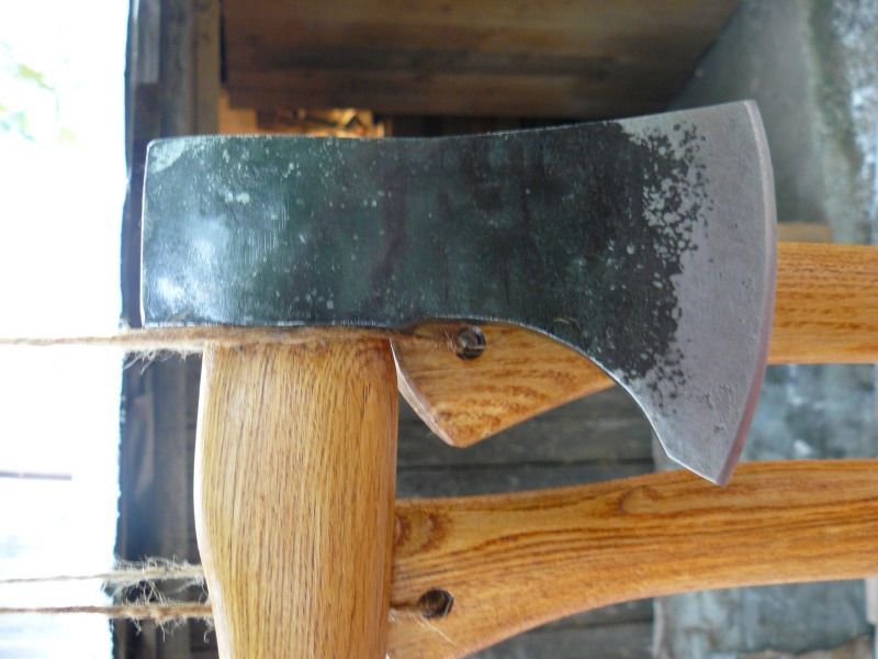

I change bigger axes - cut down some excess material, forge them to improve the shape, change the cutting edge geometry and I make a new heat treatement and edge sharpening.
The handles are made ​​from raw hafts purchased from market.
