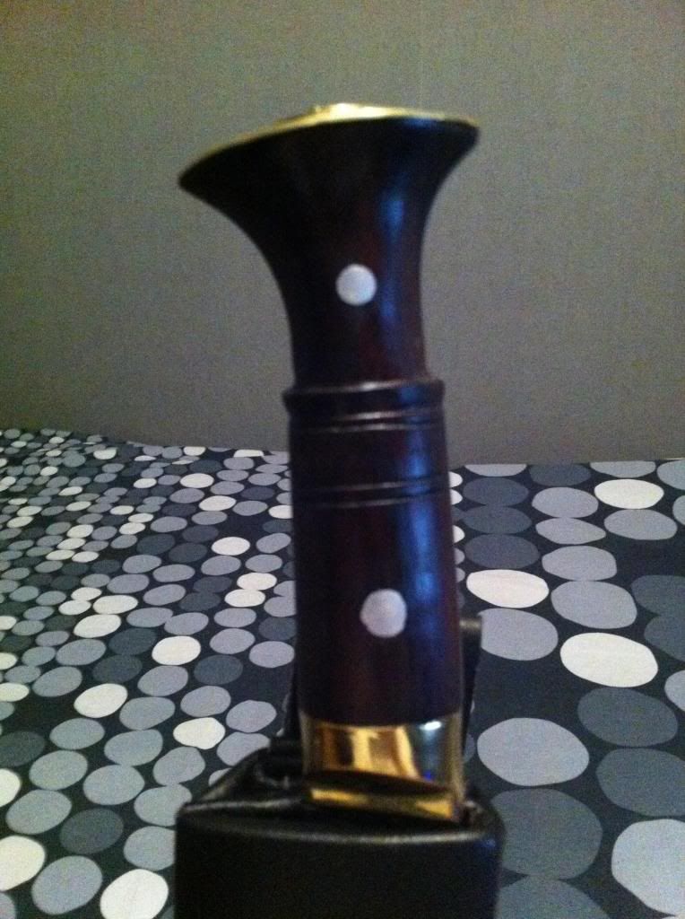

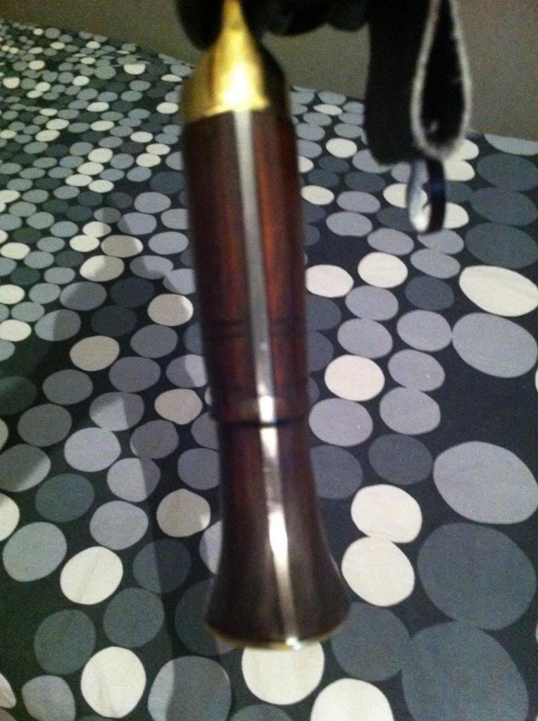

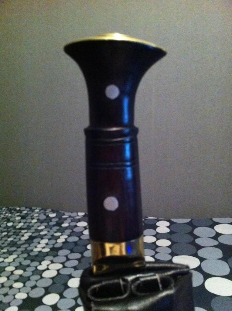

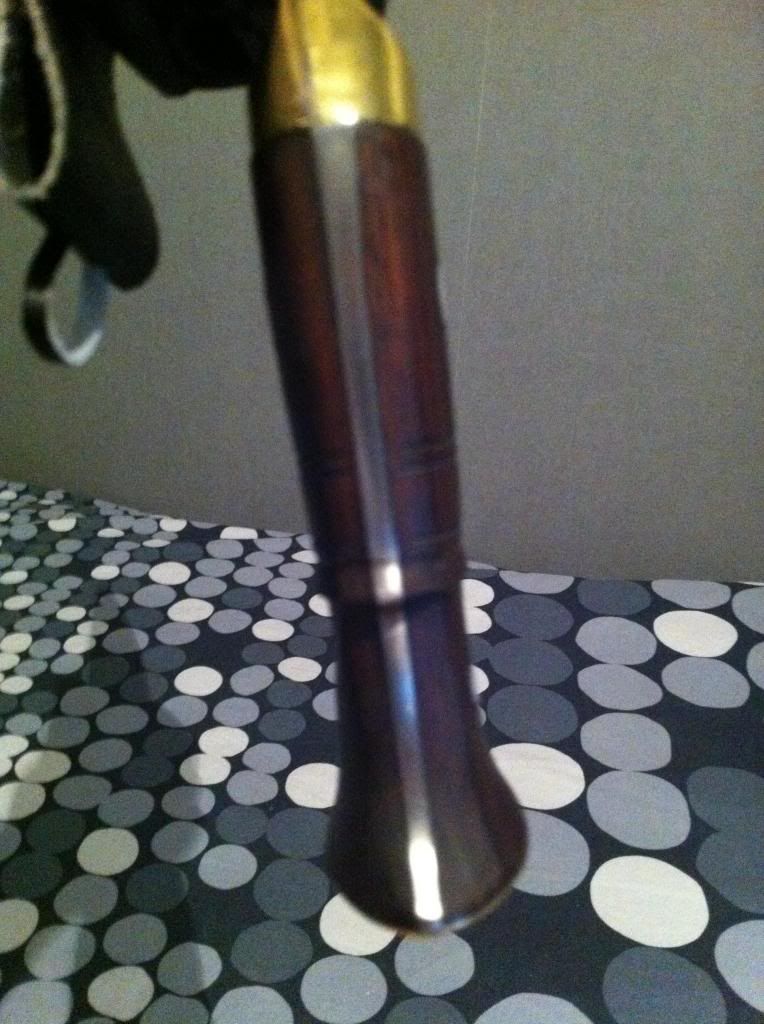

I tried soaking the handle in oil over a couple of days, but it barely did anything to it. And so, yesterday I visited my beloved and very kind grandfather and he let me borrow his workshop and tools, he also gave me some good advice while I was working on the handle.
I filed down the tang with a couple of diffrent files, and then sanded it with finer and finer grits of sandpaper until I was satisfied with it.
Here are some pictures of it, and in my opinion I think it turned out pretty good for being the first time ever doing something like this.
Right side of the handle:
Left side of the handle:
Front of the handle:
Back of the handle:

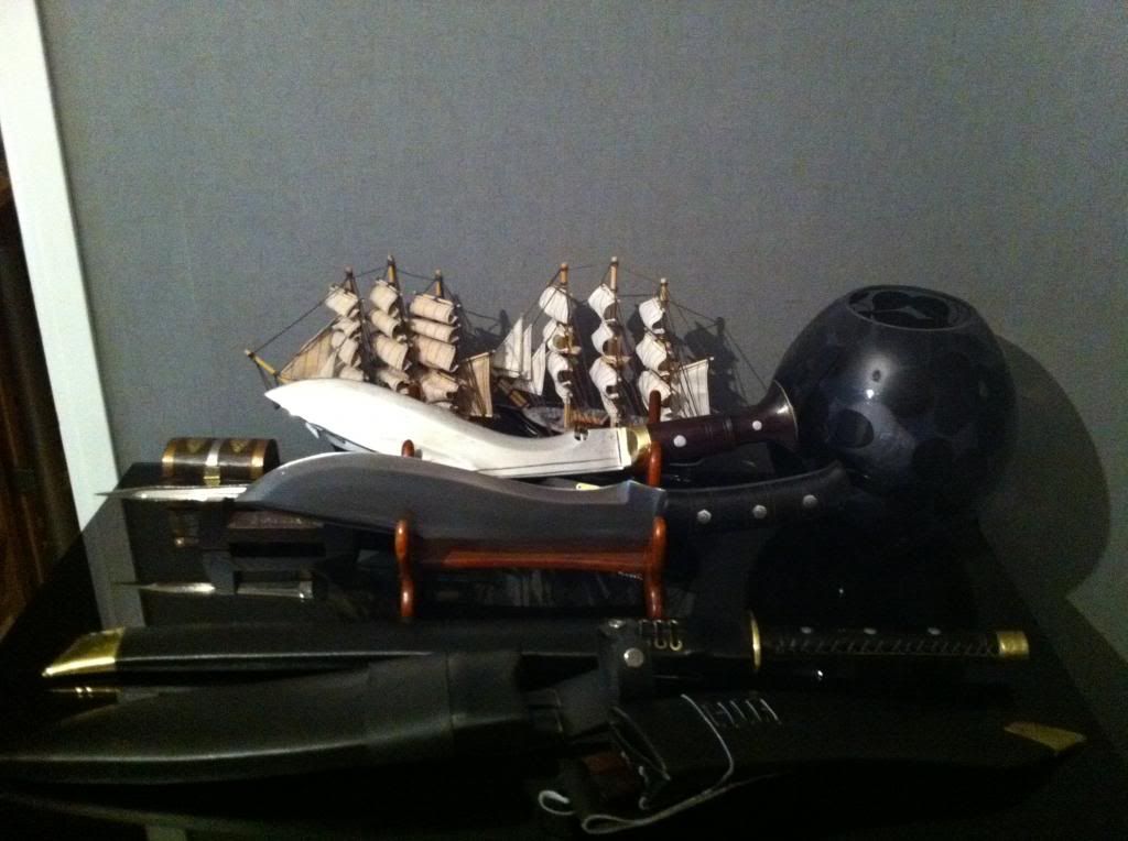

The CAK in its usual location:

That's way more better and it looks like you did a superb job. Looks great.
I love the little rack you keep it on. I've been pondering and head scratching on some kind of stand. Taking into consideration lack of display space and safety. We seldom get them but have had an earthquake or two in these parts and I don't want to be dodging Khuk's if we have another.
Contemplating blade down, blade up, I like your blade up, the edge isn't resting on anything.
Guess I'll contemplate some more and when I end up with something I'll share by victory or agony of defeat if I fail.
